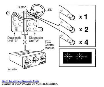

My 5 cylinder Volvo 850 GLT has no control of cabin temperature. There is no control of the damper doors directing the airflow. Is the A/C programmer broken and can it be repaired?

Here is a description of the temperature controls and how to retrieve Diagnostic Trouble Codes.
SELF-DIAGNOSTICS
The Electronic Climate Control (ECC) control module can detect faults in the system and store Diagnostic Trouble Codes (DTC). If a fault is present, system informs driver by flashing the LEDs by the AC and REC switches for 20 seconds. A fault warning is given when a fault is discovered or present, each time ignition is turned on, or engine started. DTCs will remain stored until cleared by an input code.
NOTE: Test Unit (981 3190) and Adapter (981 3194) are required for DTC diagnosis. The Volvo Diagnostic Key (998 8670) may be used to perform self-diagnostics. Follow tool manufacturer's instructions.
There are 3 different test modes/settings which can be selected for reading off DTCs. TEST MODE 1 may be used for reading off DTCs detected by control unit (up to 47 codes can be stored). TEST MODE 2 checks signals from speedometer and solar sensor.
TEST MODE 4 is used to check electrical circuits in A/C system, reset information on damper motor limit positions and change data transmission speed from ECC control module to on-board diagnostic unit.
NOTE: Ignition must be turned off before switching from one test mode to another.
ENTERING SELF-DIAGNOSTICS
1. Connect selector cable from diagnostic unit "A" to terminal No. 1 of diagnostic unit "B", located behind right headlight. See Fig. 2 .
https://www.2carpros.com/forum/automotive_pictures/192750_Diagnostic93Volvo850_1.jpg
2. Turn ignition on. LED on diagnostic unit "A" should start flashing. Each DTC (3-digits) consists of a series of flashes with a short break between each series. DTCs are displayed in ascending order.
TEST MODE 1
1. Turn ignition on. Press button on diagnostic unit "A" for about one second. Read LED flashes.
2. If LED flashes DTC 1-1-1, no faults are stored. If LED flashes other than DTC 1-1-1, display DTCs and perform appropriate DTC trouble shooting.

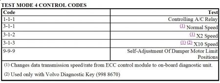

TEST MODE 4
1. Turn ignition on. Press button on diagnostic unit "A" 4 times (for about one second each time). LED should illuminate. If LED illuminates, go to next step.
2. Control codes must be entered one step at a time. See TEST MODE 4 CONTROL CODES . LED should go off after each digit is entered. Entering each digit in a code must be made within 4 seconds as failure to do so will abort input and TEST MODE 4 must be restarted.
