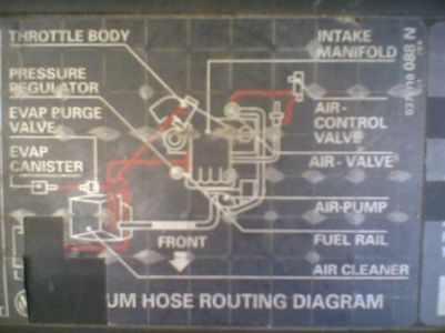

As for the EGR valve... where would it be according to this diagram. VW doesn't use the EGR terminology...
https://www.2carpros.com/forum/automotive_pictures/70282_diagram_2.jpg

You are correct, the diagram does not show an EGR.
