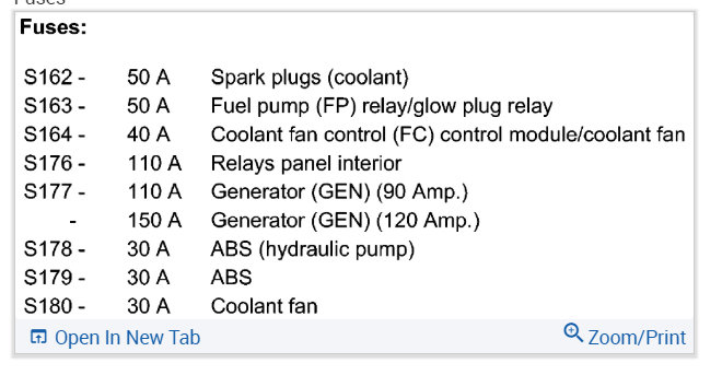

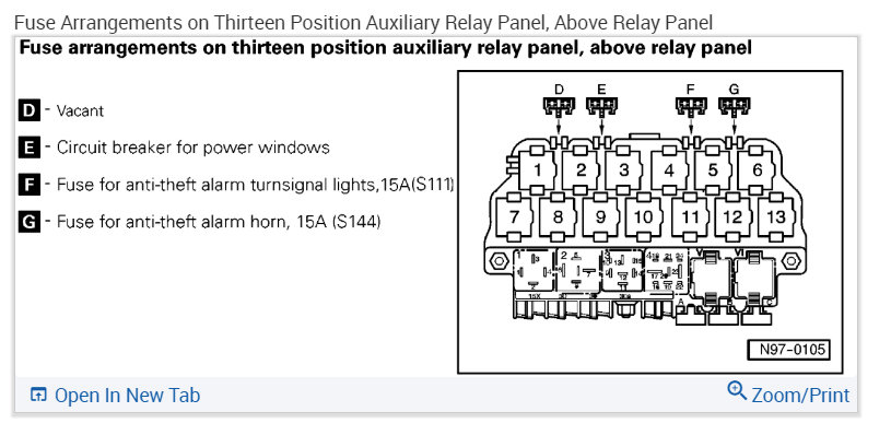

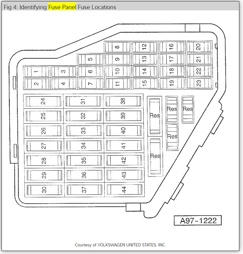

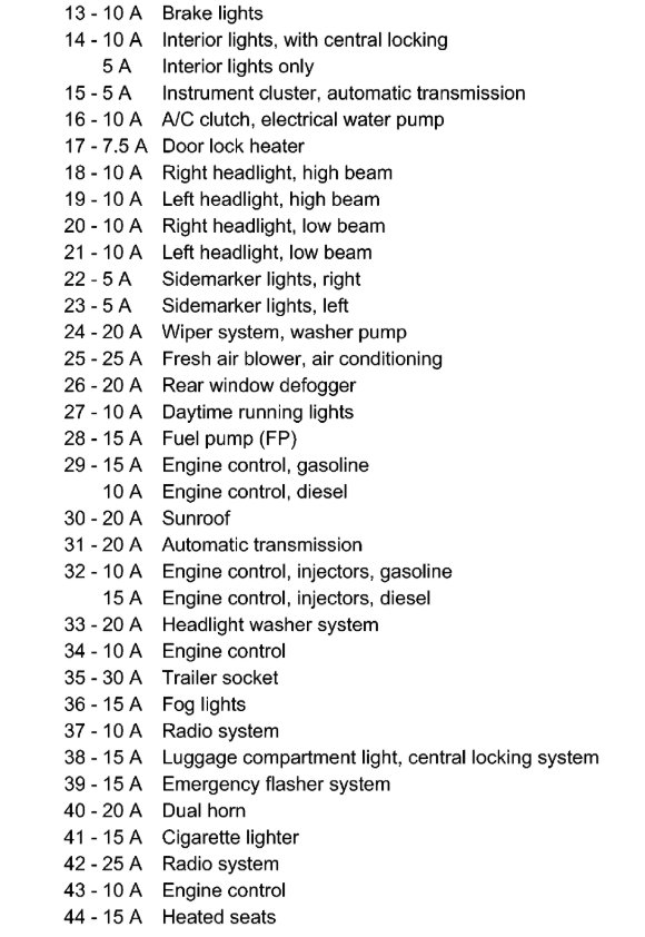

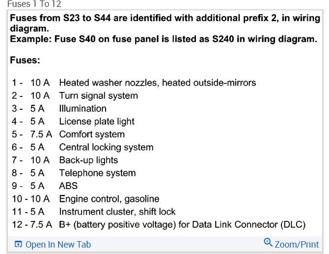

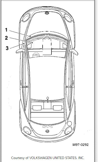

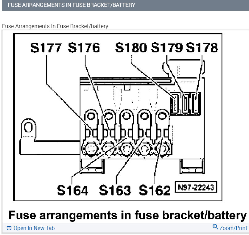

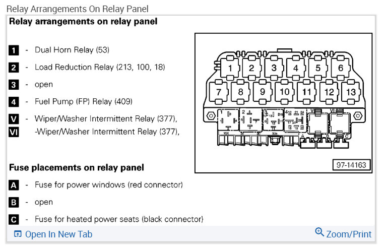

Radio fuse location thanks for the help
Monday, August 9th, 2010 AT 8:03 PM
MECHANIC
75,992 POSTS
Check and test fuse no.37 10amp and fuse no. 42 25amp in fuse panel behind left side of dash. Here is a guide to help check it with the fuse location below
