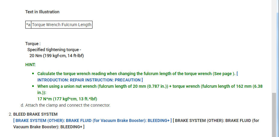

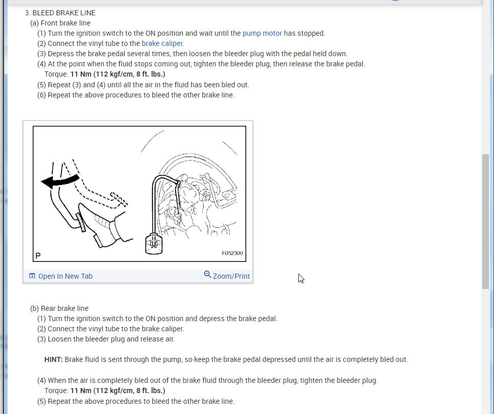

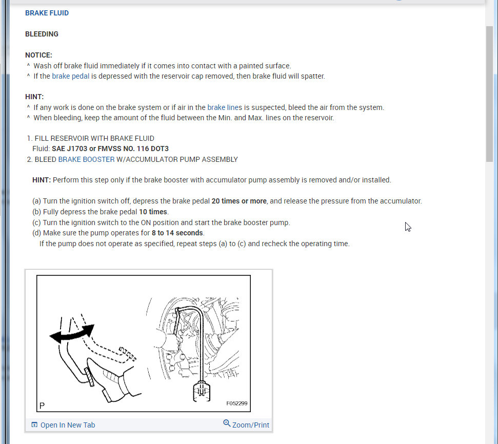

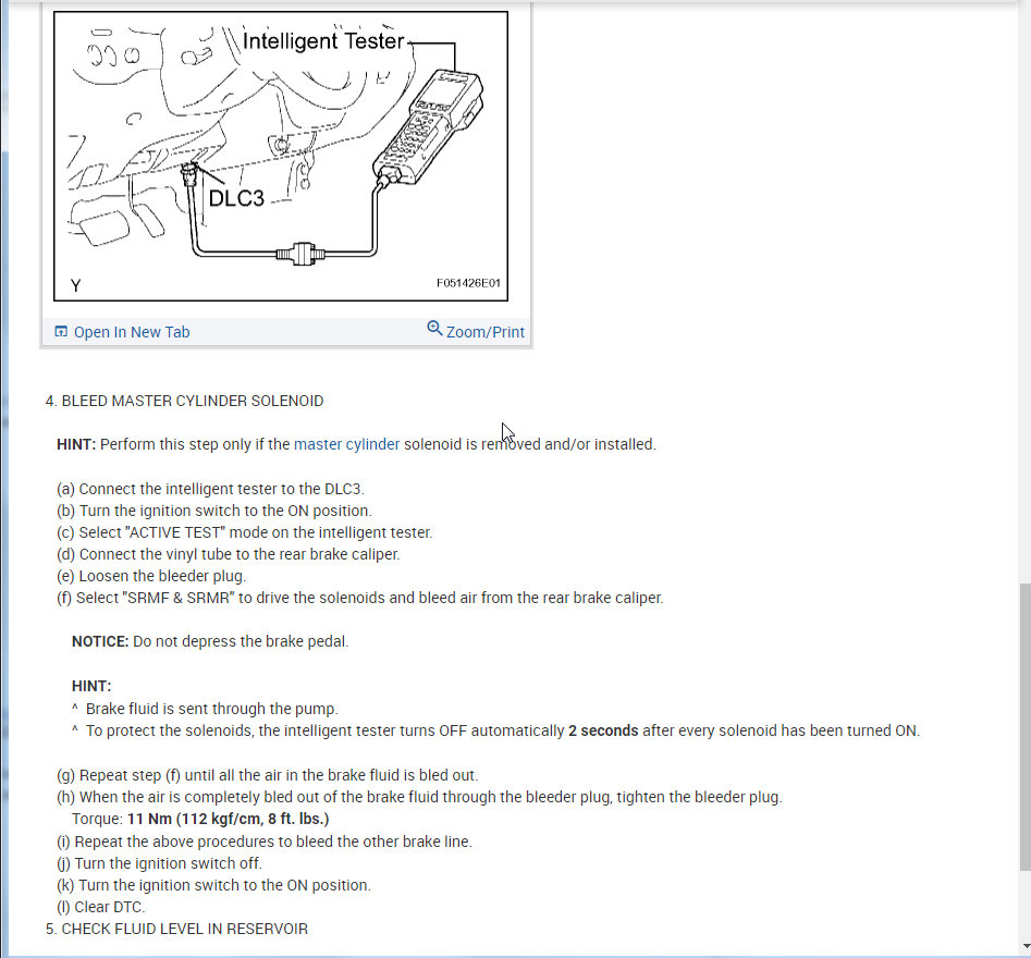

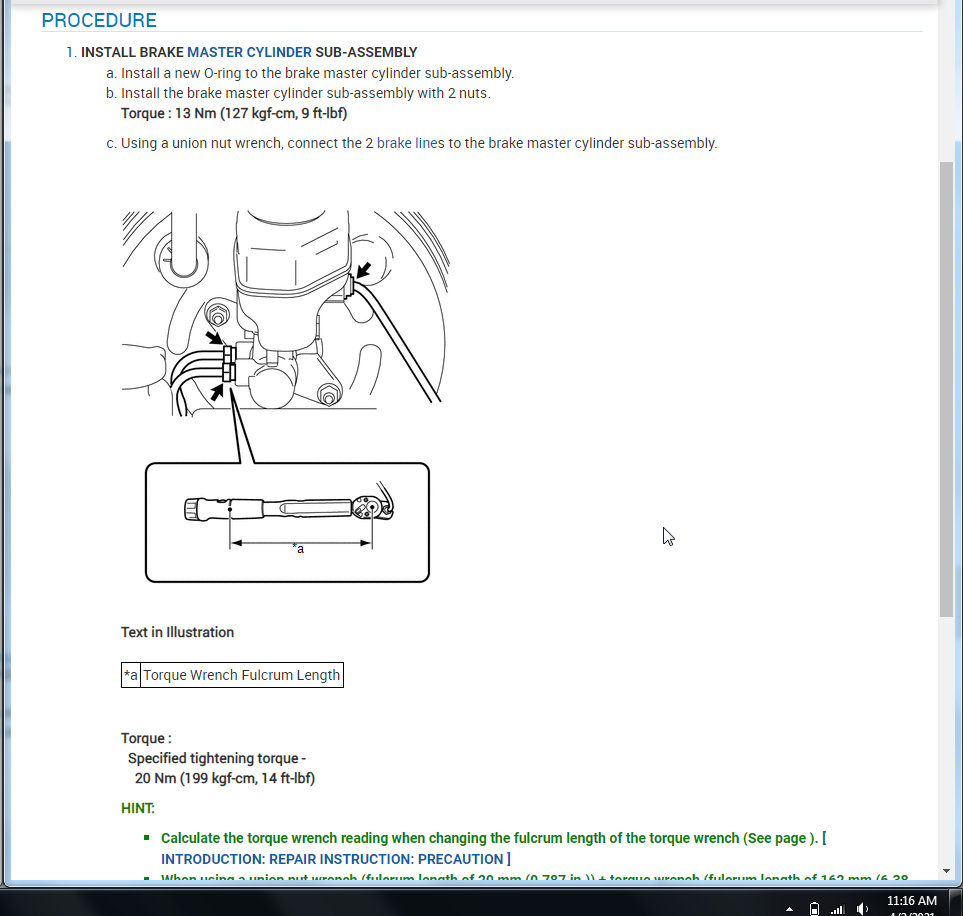

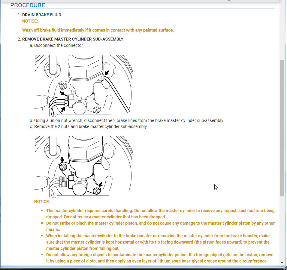

Hi, I just got my rotors changed couple days ago because of the vibration when I applied the brake. This seemed to fix the problem but I noticed the brake master leaking now.
Jun 5, 2019 at 11:28 AM
  • CAR REPAIR CONTRIBUTOR
Here are the master cylinder installation instruction you have requested. Here is a guide to help you step by step with instructions in the diagrams below to show you how on your car.
https://youtu.be/WDxvEQrMkBg
and
https://youtu.be/w7gUsj2us0U
and
https://www.2carpros.com/articles/how-to-replace-a-brake-master-cylinder
Plus here is a guide that will help with bleeding the brakes:
https://www.2carpros.com/articles/how-to-bleed-or-flush-a-car-brake-system
Below you find the process from the manual on how to replace the master and bleed the brakes. Please let us know if you need more info. Thanks
