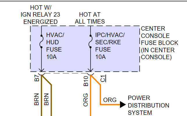

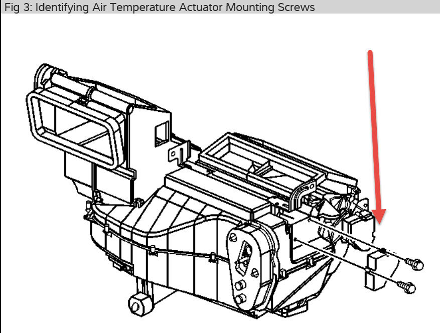

New fuel filter. Also, like I said the mechanics are going crazy with my vehicle. I have a 2006 Buick Terraza after $2,000.00. Repairs still no heat what can expect we are not in the 1970 or 1980 when they were still building cars?
Monday, November 28th, 2016 AT 6:52 AM
HMAC300
  • 48,601 POSTS
If not starting hot may be pump going bad and pressure should be checked then or the return line is partially blocked if you can spray choke cleaner into manifold and it starts then it is a fuel problem. Also, on these check distributor for play in rotor there should be none if there is the gear is bad on distributor which is a common problem and distributor needs replacing. For no heat for Buick pull fuses in picture the temperature actuator may be need to reset or not working. Pulling fuse for sixty seconds with key on resets actuators and you may get heat. If auto temperature it needs to be scanned with a scanner.
