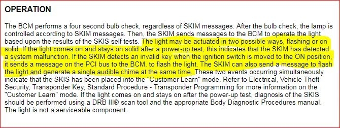

Okay. Did they find any codes and provide them to you?
Also, take a look at this attachment. When you turn the key on does the red security light stay on solid, blink, or go out and stay out after four seconds?
