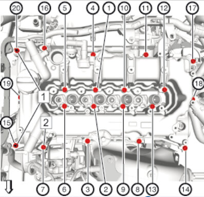

I have the next gen Cruze with aluminum valve cover. What are the torque specs for this model and sequence?

Please start a new thread for the vacuum pump torque specs, the specs for the valve cover is:
15 nm or 11 lb ft.
Let us know if you need anything else.

Okay. Do you know the sequence for the valve cover bolts?

Yep, here it is. Check out the images (below). Let us know how it goes.
