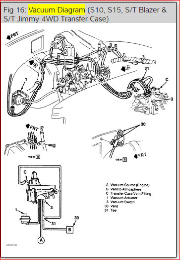

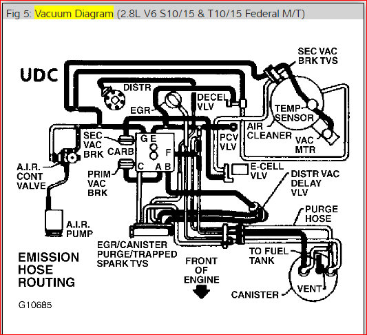

Engine Vacuum Diagrams Please?
Friday, December 7th, 2018 AT 7:07 PM
DANNY L
MECHANIC
5,648 POSTS
Hello, I am Danny.
Here are the vacuum diagrams you requested. Check out the diagrams (Below). Please let us know if you need anything else to get the problem fixed. Hope this helps and thanks for using 2CarPros.
