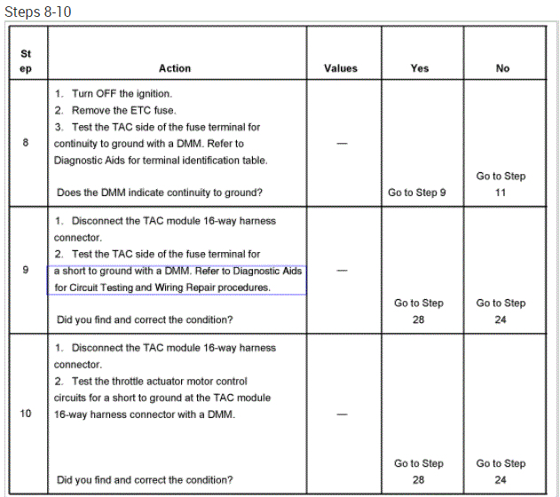

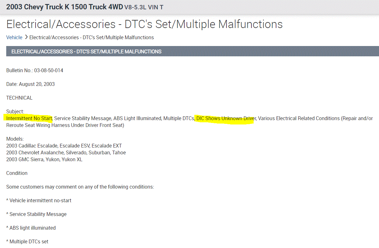

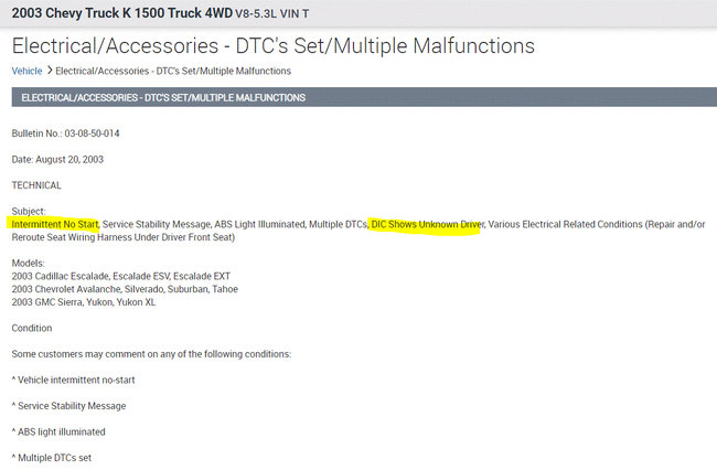

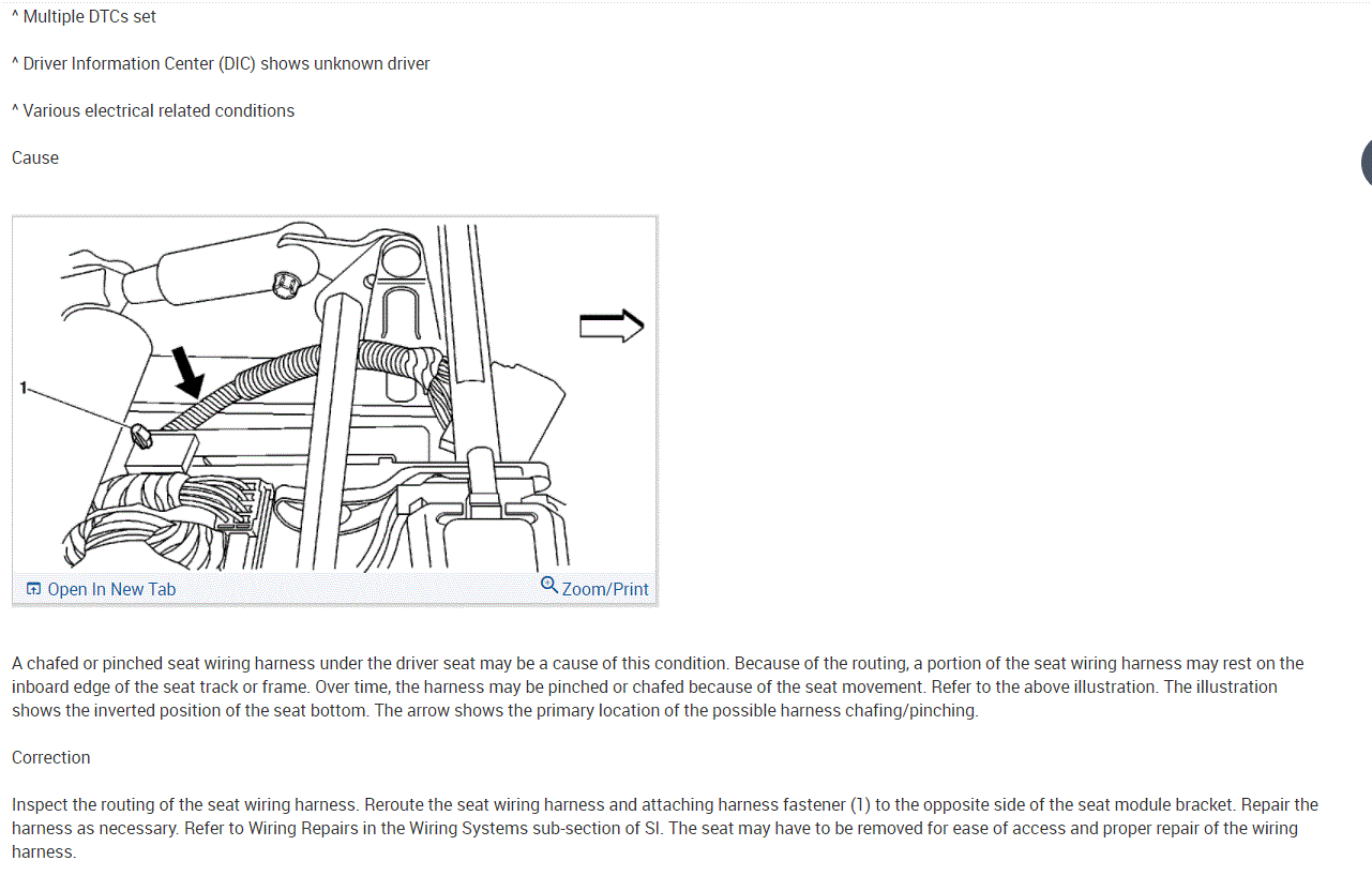

If you turn the key on to the run position and let it set for approximately 10 minutes, does the anti-theft turn off? If so, will it then start?

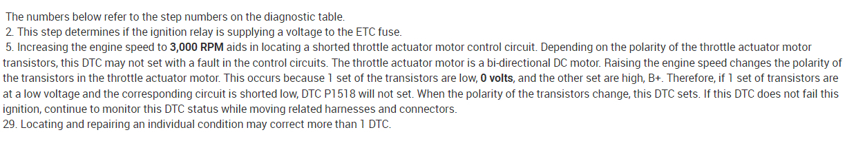

Also, I did some research on this indicator. I was able to find a technical service bulletin related to it. Take a look at the attachments below and let me know if they help.

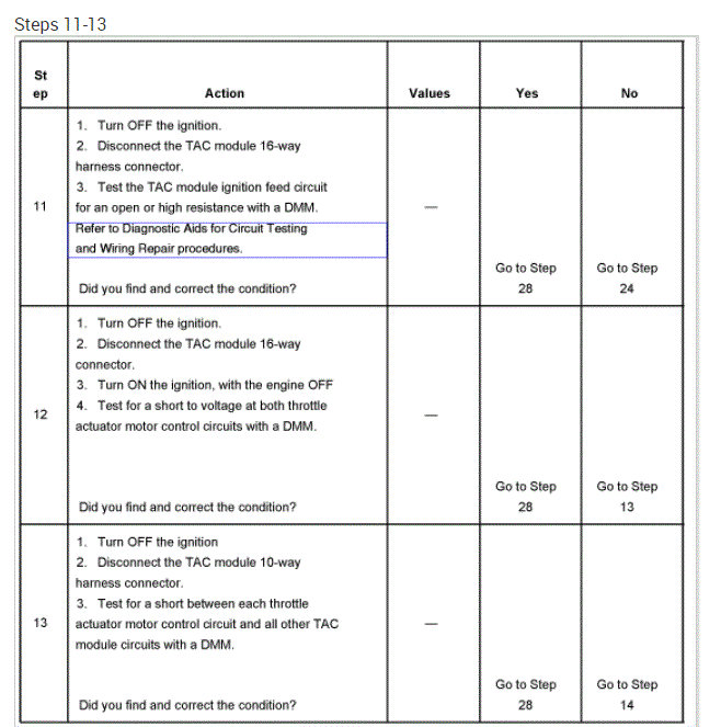

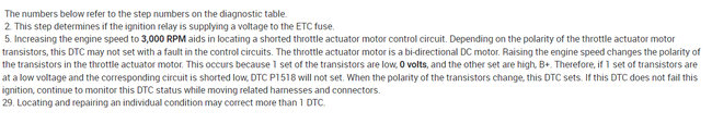

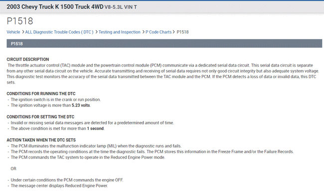

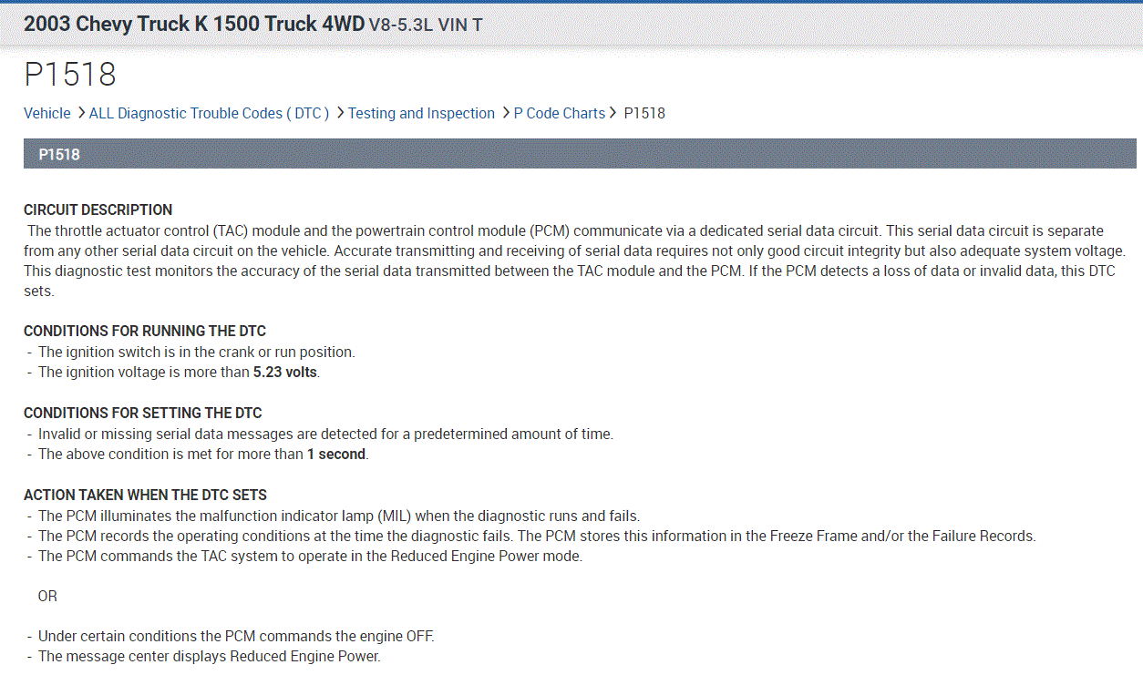

I checked all fuses the only thing was some trailer lights, and my head lights fuse it’s been like that a long time. But I was finally able to pull a code p1518. What do you think? Could it be tac module or BCM?
Thanks

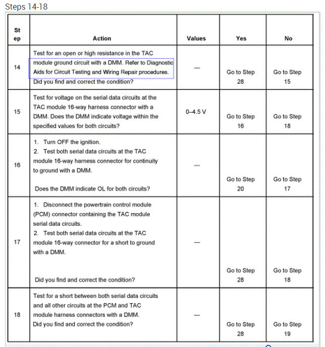

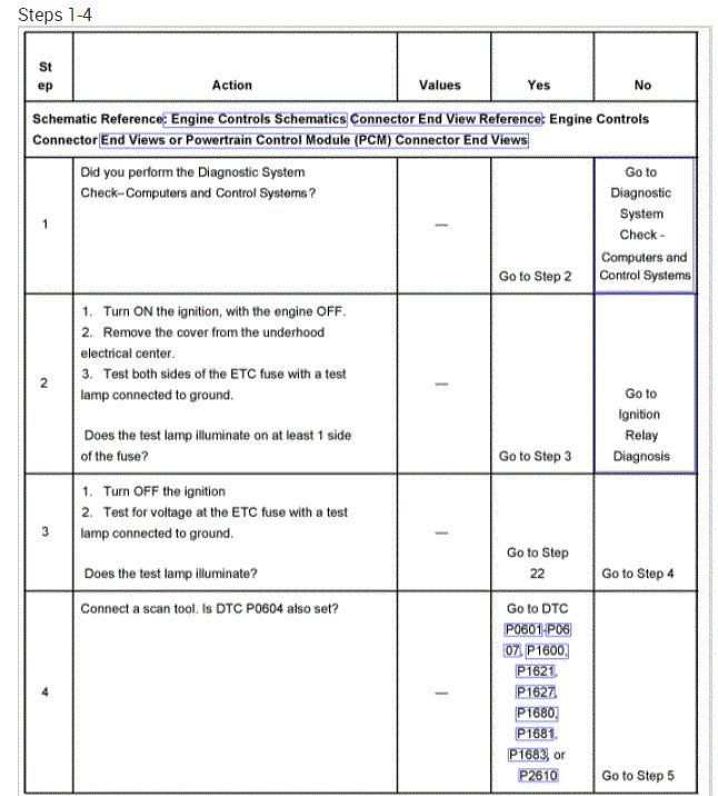

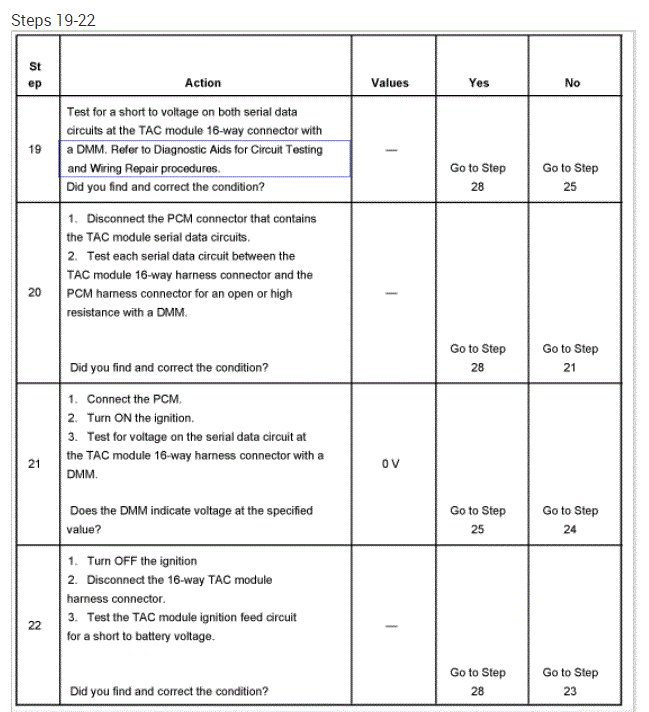

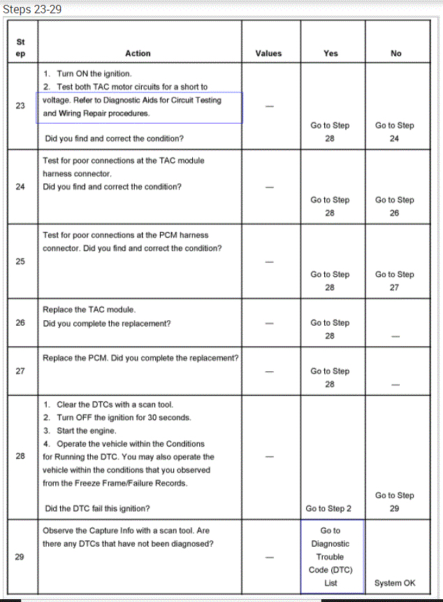

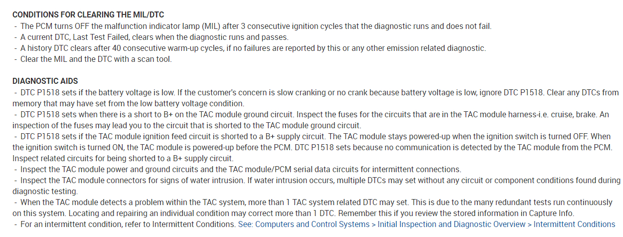

  • 110,194 POSTS

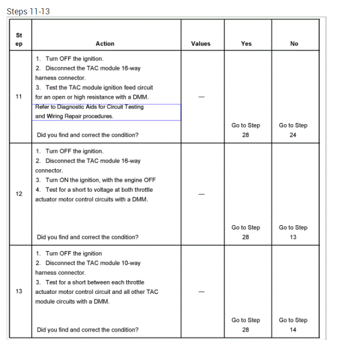

The TAC could be bad, there could be a wiring/power issue, or even a serial data bus issue.
Take a look through the attached diagnostics. See if you are comfortable performing them.
Let me know,
