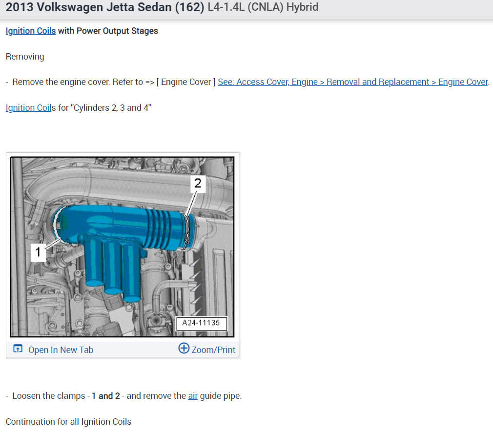

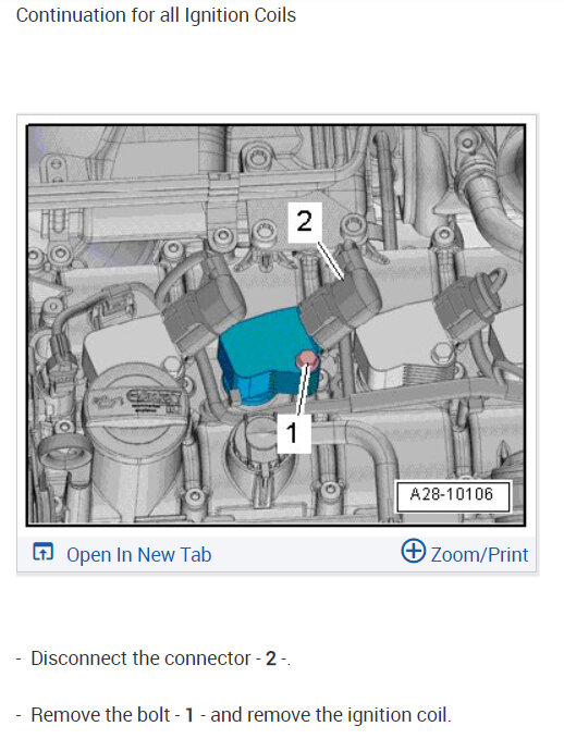

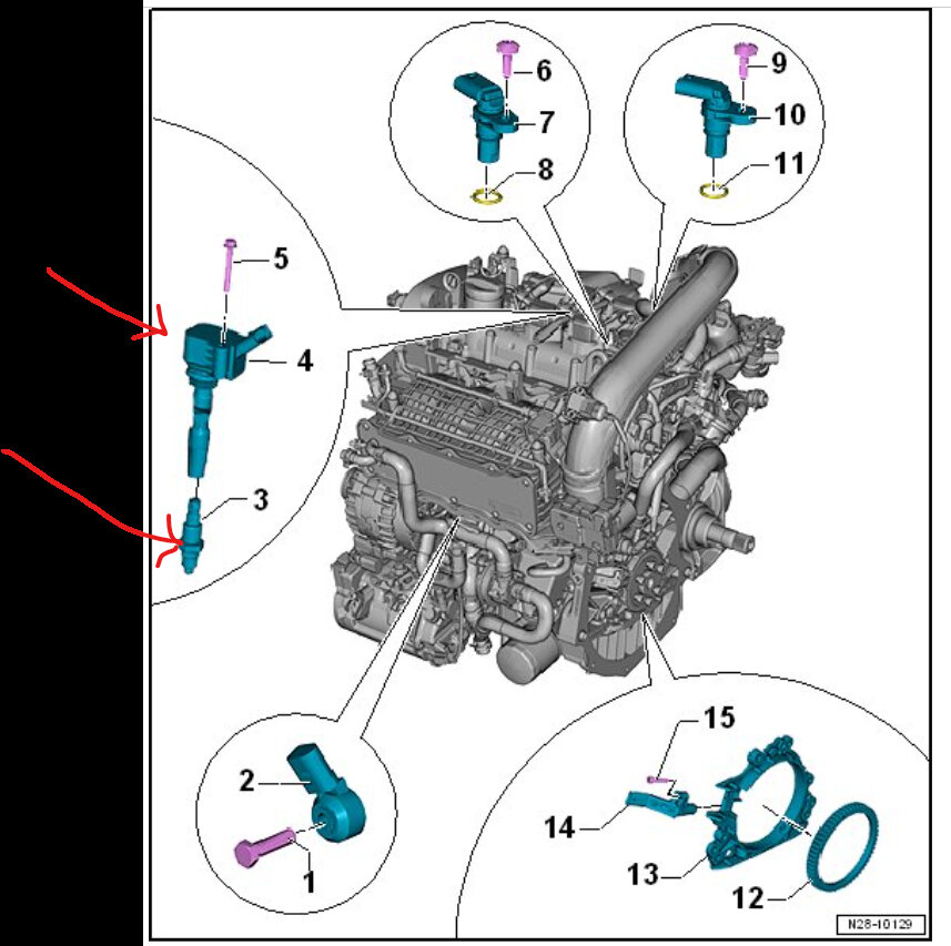

This can happen when the engine is misfiring, have you changed out the spark plugs and coils? If not, this is where I would start, if the engine is not running well the ESP system can get mixed up and flash the ESP warning light. Here is a generic guide to help you step by step with instructions in the diagrams below to show you how to do the job on your car:
Torque spec: Spark Plug. 22 Nm
Check out the images (below). Please upload pictures or videos of the problem so we can see what's going on.

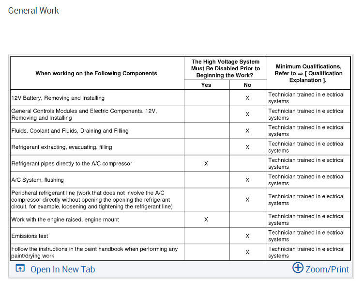

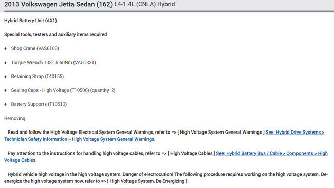

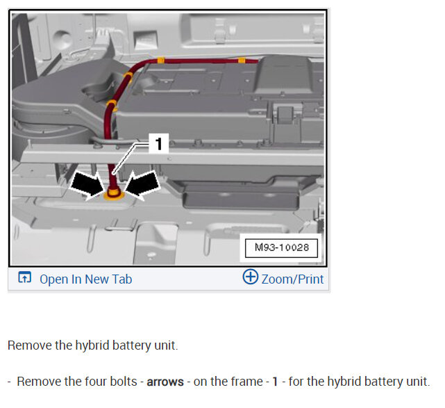

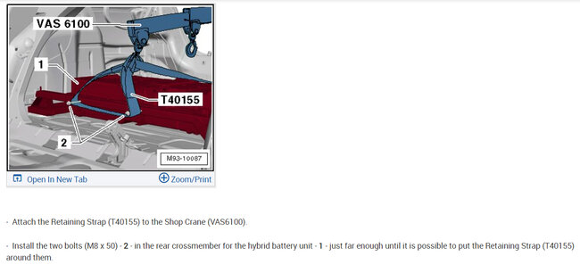

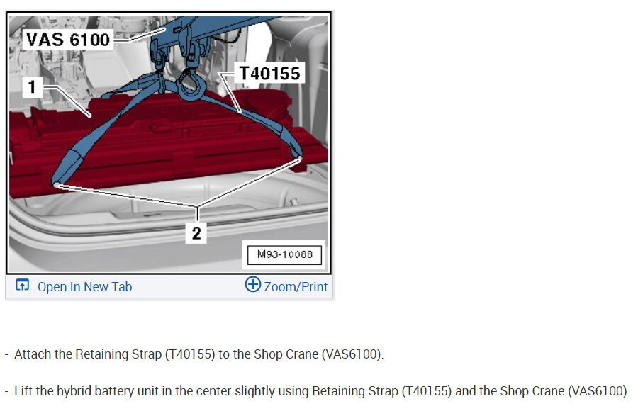

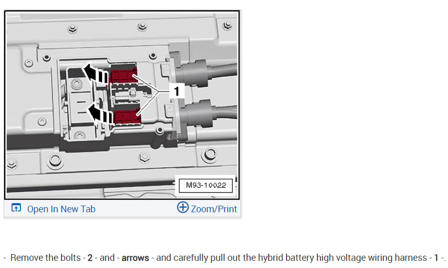

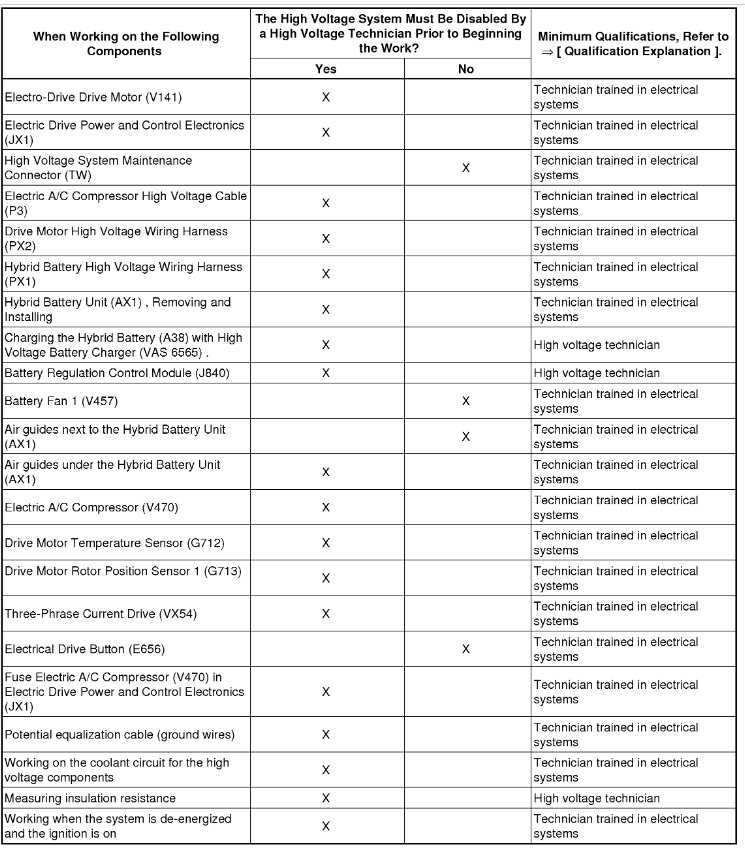

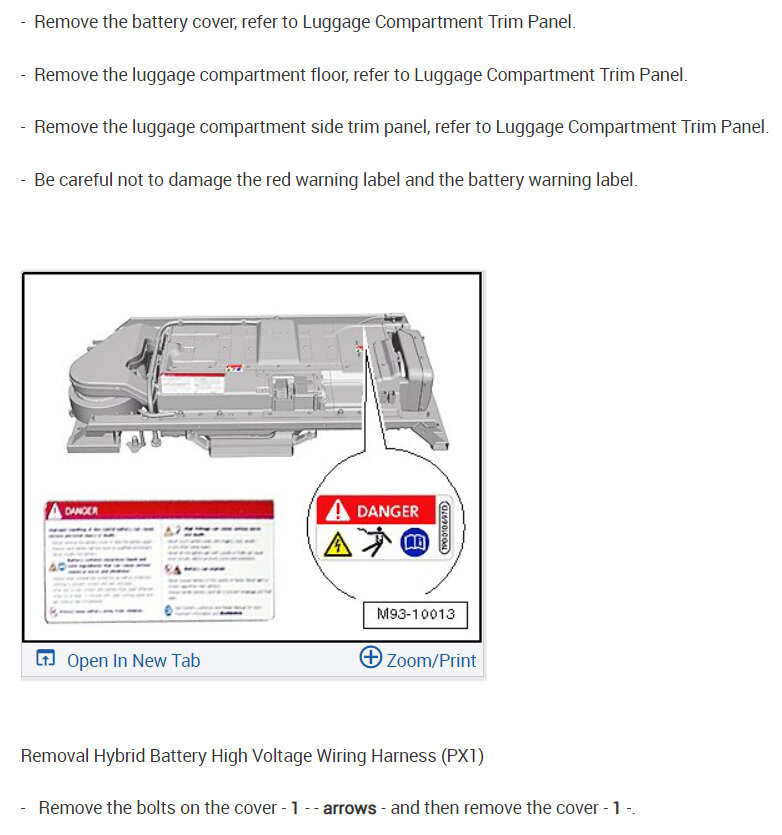

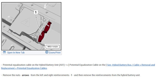

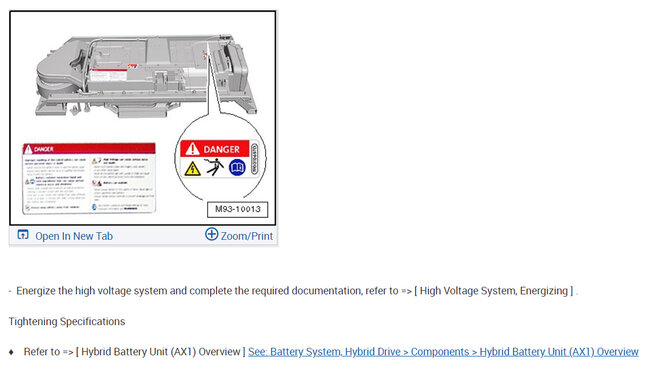

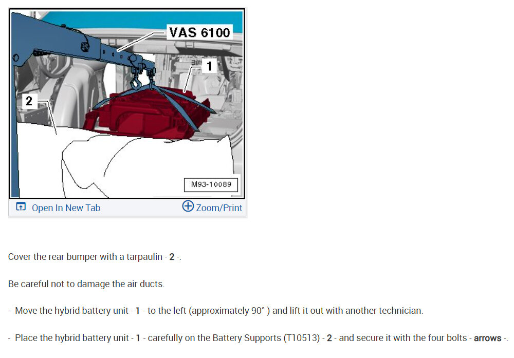

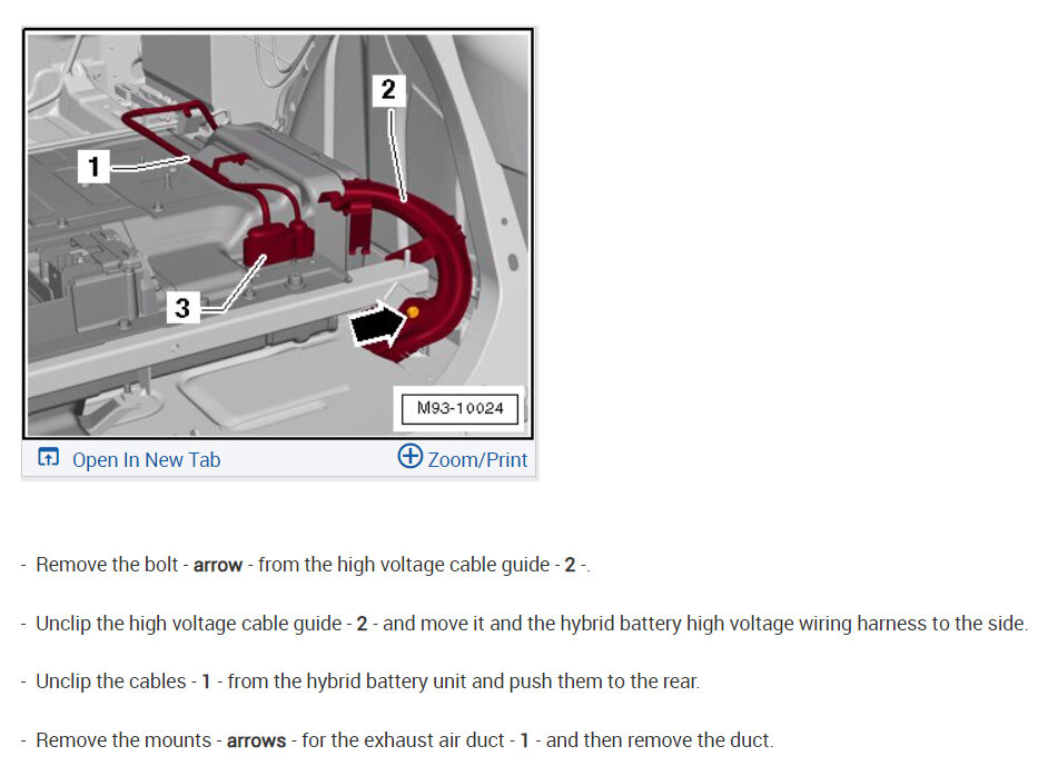

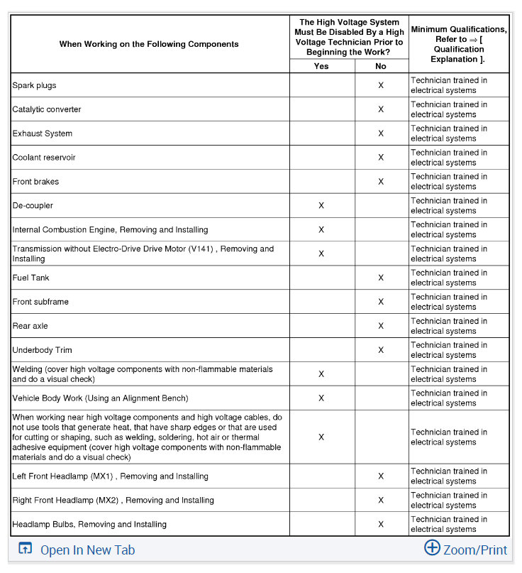

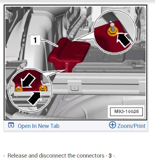

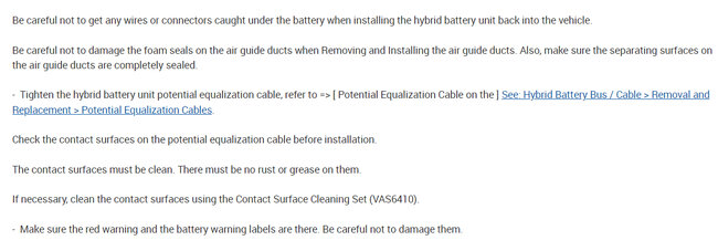

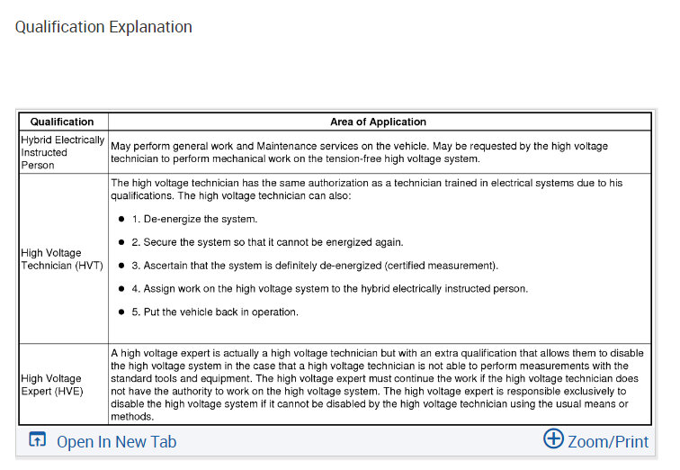

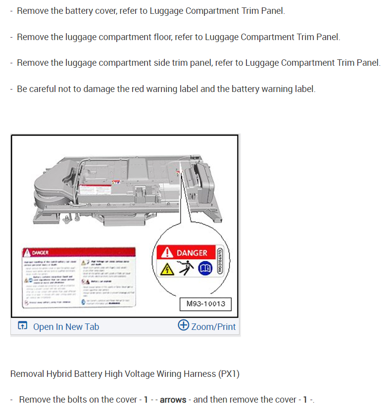

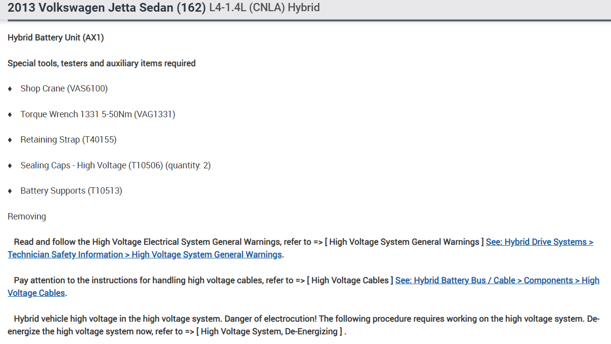

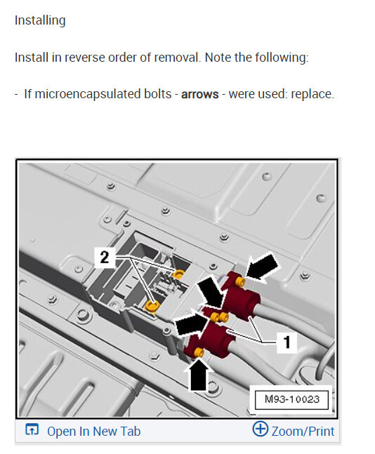

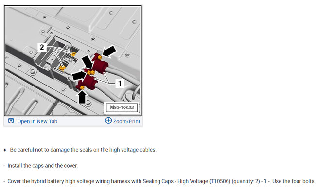

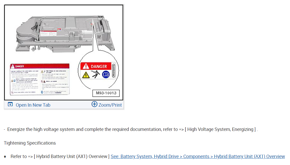

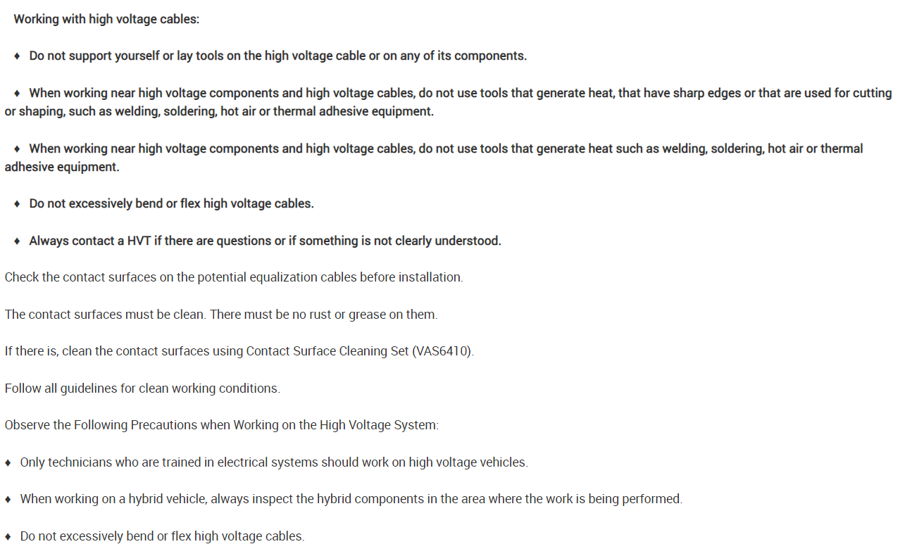

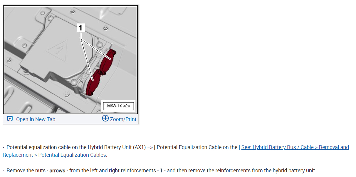

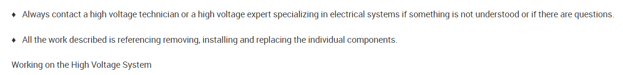

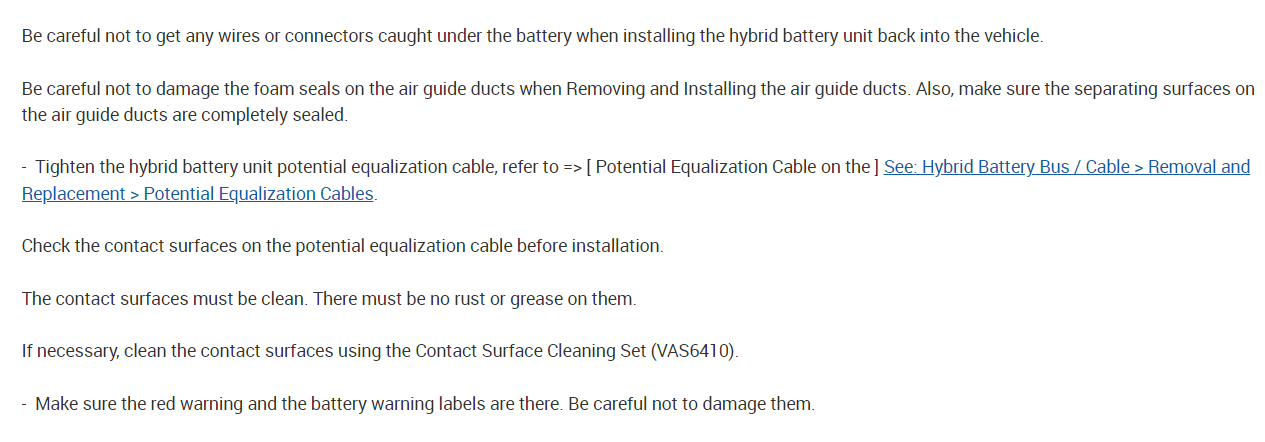

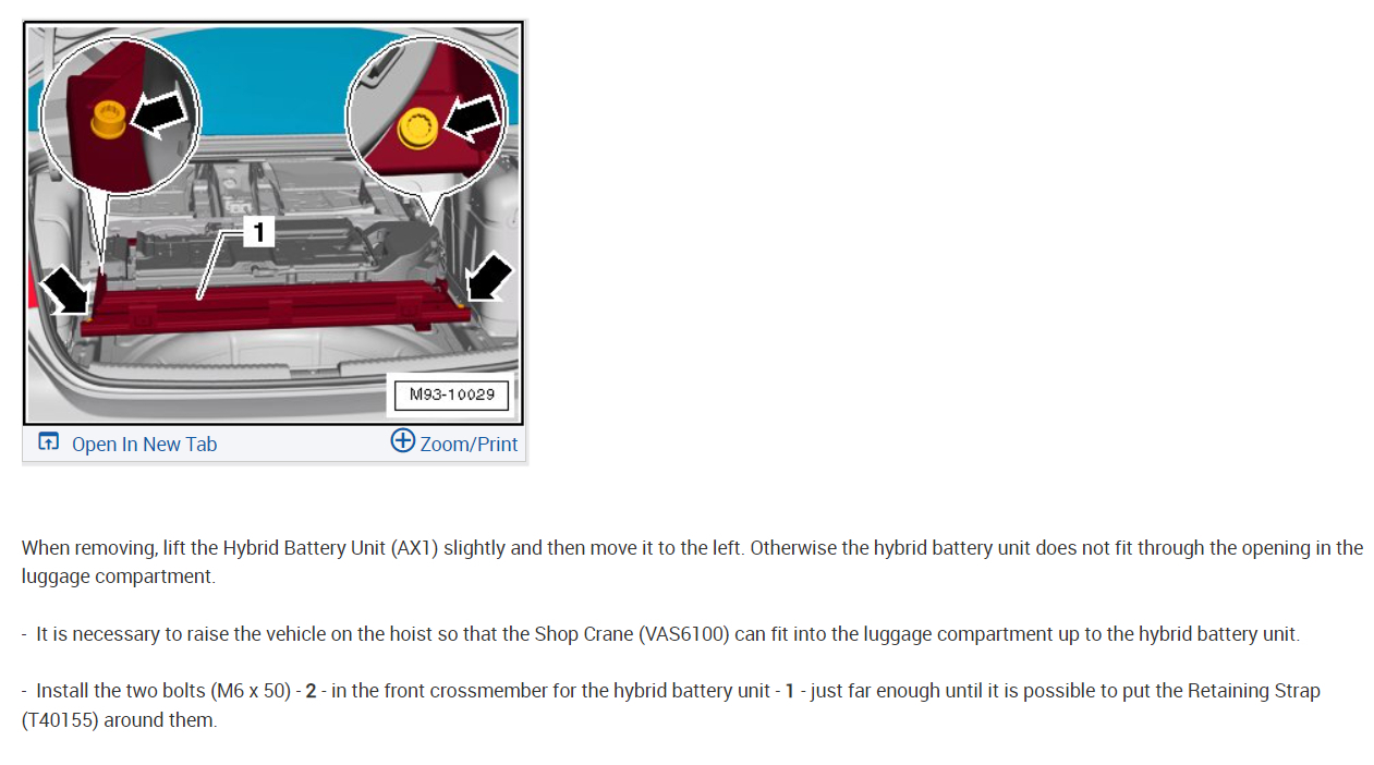

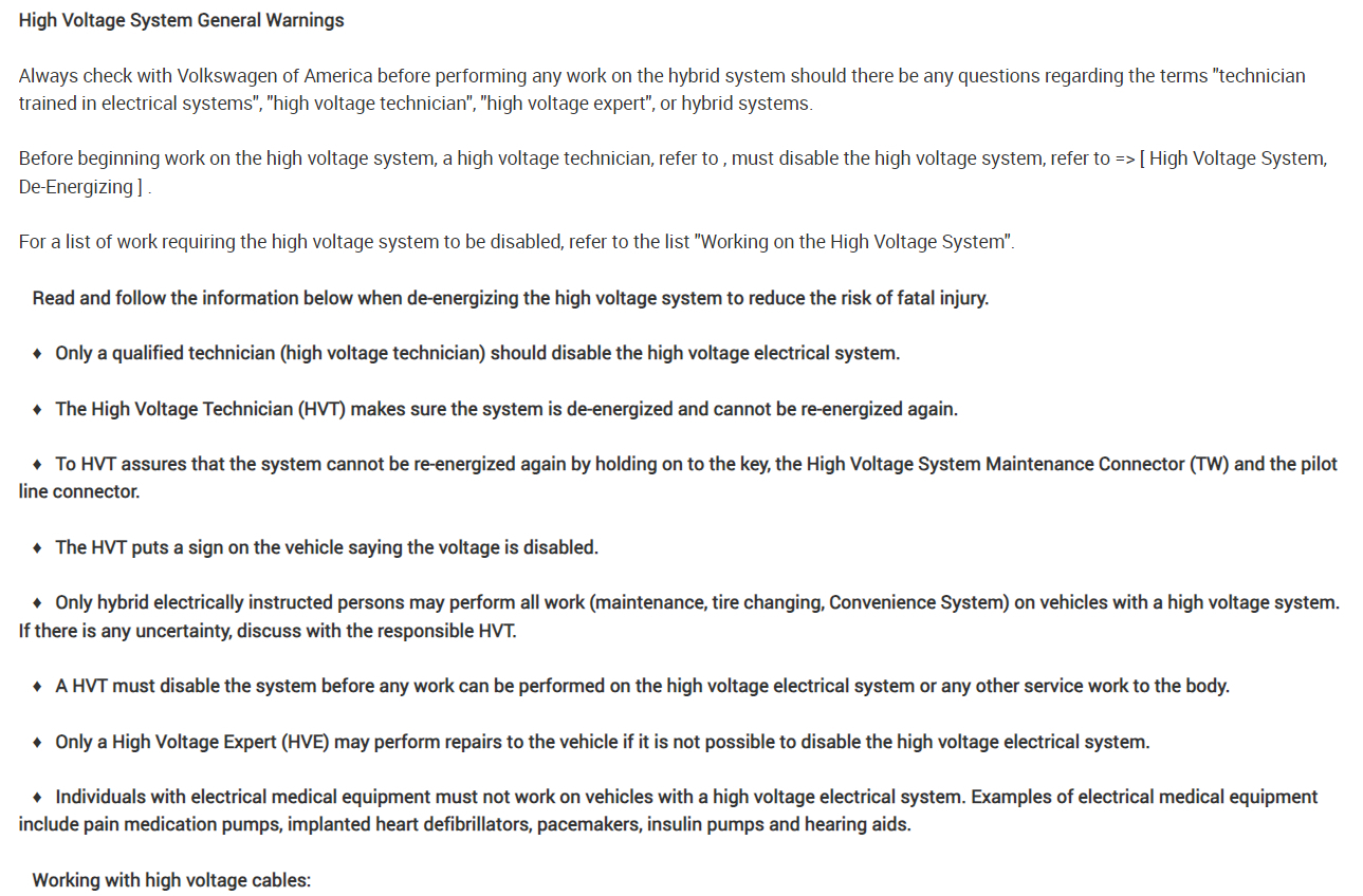

Yep, good call, can I ask if this is a plug-in hybrid? If not, it sounds like the hybrid battery is bad. But we should run the CAN codes to see if any are stored. You can get a CAN scanner (Controller Area Network) which will work on most cars from Amazon.
https://youtu.be/u-4syLc-ifQ
To change the battery out you need to be trained and it takes an engine hoist to remove the battery because it is heavy. Here are the instructions on how to do the job I would read it over completely so you can see the job that needs to be done, Like I said though you need to be trained on this job to avoid personal injury. Before we do anything let's run the codes first to confirm the failure. Check out the images (below). Please let us know what happens.

You could have cracked a spark plug which this problem sounds like, I would remove the spark plugs again for inspection. Also, I have seen defective spark plugs as well, FYI. Let's run the codes it might tell us which cylinder it is.
Monday, December 11th, 2023 AT 10:32 AM
KEN L
  • MASTER CERTIFIED MECHANIC
  • 55,281 POSTS
Please go over this guide and get back to us.
