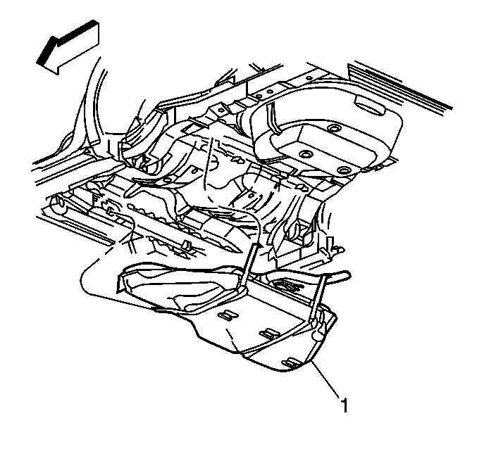

Yep, it needs replaced. It should be between 50 and 60 psi. The fuel tank needs removed to replace it. Here are directions for tank removal and replacement and pump replacement. All attached pics correlate with the directions.

REMOVAL PROCEDURE
1. Relieve the fuel system pressure. Refer to Fuel Pressure Relief Procedure.
2. Drain the fuel tank. Refer to Fuel Tank Draining Procedure.
3. Raise the vehicle. Refer to Vehicle Lifting.
pic 1

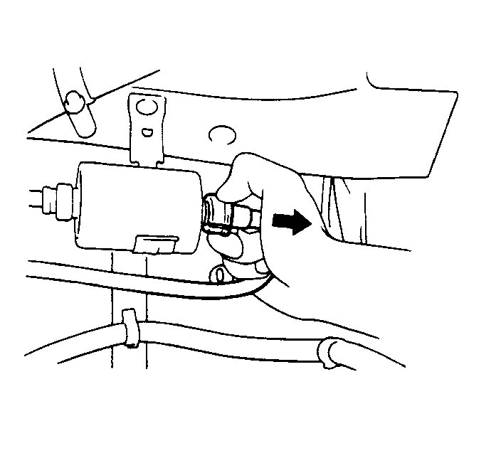

4. Disconnect the quick-connect fitting at the fuel filter.
5. Disconnect the fuel return pipe quick connect fitting.
6. Remove the rubber exhaust hangers. Allow the exhaust system to rest on the rear axle.
7. Remove the exhaust heat shield.
8. Loosen the fuel filler hose clamp at the fuel tank.
9. Disconnect the fuel filler hose from the fuel tank.
10. Disconnect the evaporative emission (EVAP) vapor pipe from the EVAP canister.
11. Disconnect the electrical harness from the multi-way rear body connector and fuel strap.
pic 2

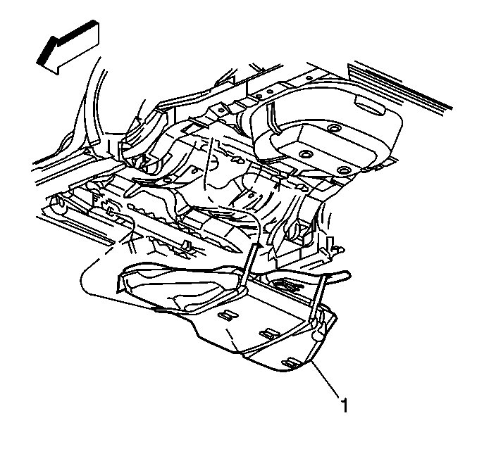

INSTALLATION PROCEDURE
pic 3
1. Install the fuel sender assembly to the fuel tank.
2. With the aid of an assistant, raise the fuel tank (1) to the vehicle.
NOTE: Refer to Fastener Notice in Service Precautions.
3. Install the fuel tank retaining straps.
Tighten the strap bolts to 35 N.m (26 lb ft).

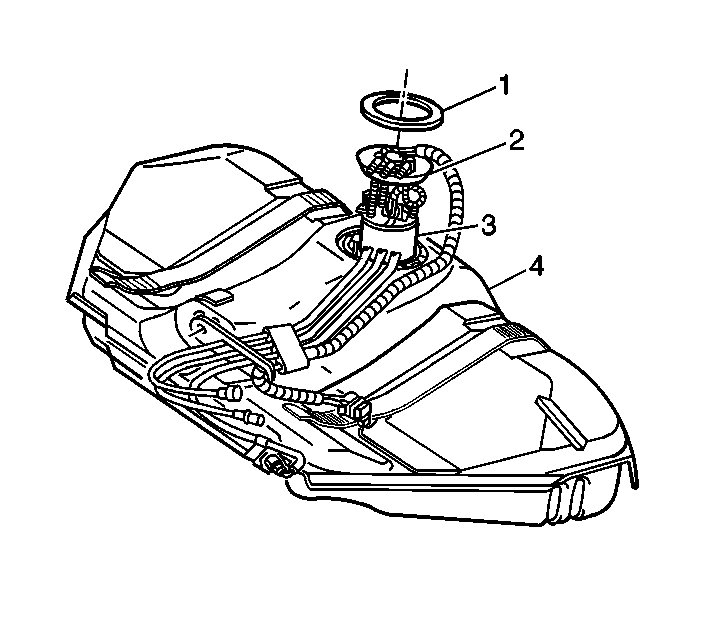

REMOVAL PROCEDURE
CAUTION: In order to reduce the risk of fire and personal injury that may result from a fuel leak, always replace the fuel sender gasket when reinstalling the fuel sender assembly.
pic 4
1. Remove the fuel tank (4).
2. Disconnect the wiring harness from the fuel sender and the fuel tank pressure (FTP) sensor.
IMPORTANT:
- The modular fuel sender assembly may spring up.
- When removing the modular fuel sender assembly from the fuel tank, be aware that the reservoir bucket is full of fuel. The reservoir must be tipped slightly during removal to avoid damage to the float.
- Carefully discard the reservoir fuel into an approved container.
3. Use the J 39765 in order to press down and rotate the retaining ring (1).
4. Remove the fuel sender assembly.
5. Remove the fuel level sensor from the fuel sender assembly.
