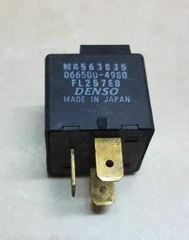

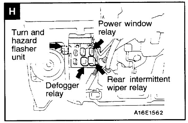

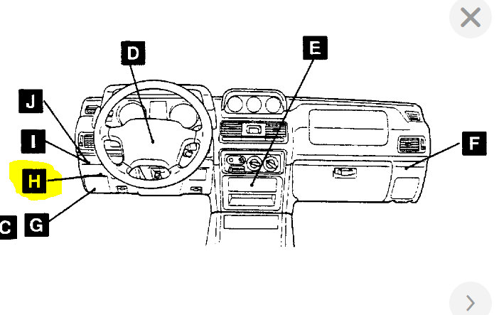

If the bulbs are good, then the first thing to check would be the flasher relay.
It is located next to the fuse box under the steering wheel.
https://www.2carpros.com/articles/turn-signals-not-working-blinker
I have attached diagrams below for your reference.
