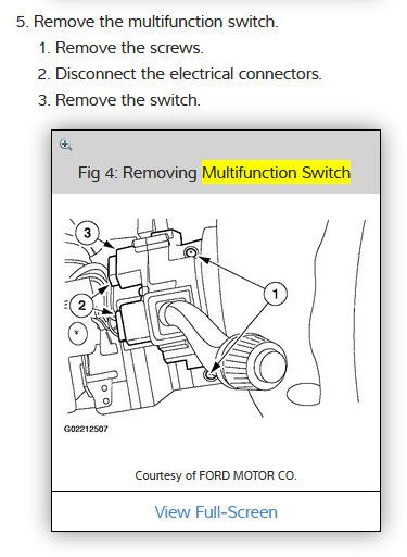

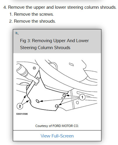

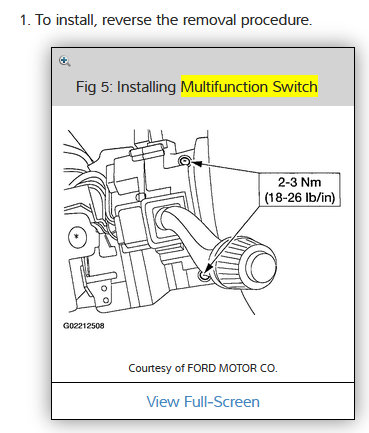

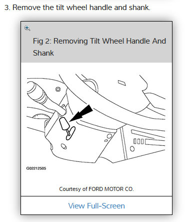

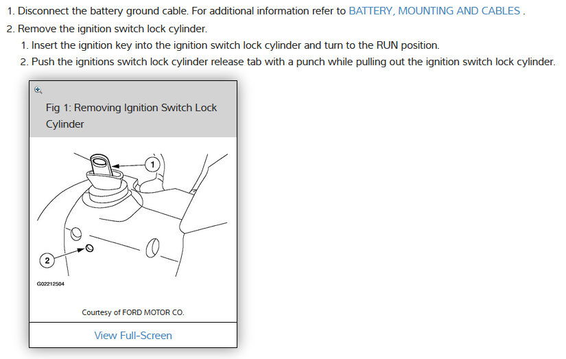

Turn signals work occasionally with steering wheel up. If tilted nothing works. Hazards work okay until tilt wheel.
Sunday, October 6th, 2019 AT 6:52 PM
94 TRANSAM
MECHANIC
680 POSTS
Hi and welcome to 2CarPros.
It sounds like your turn signal harness is broken from the repeated up and down of the steering wheel.
You will find the steps to replace it below.
Let me know if you need any further help.
Rich
Images (Click to make bigger)
