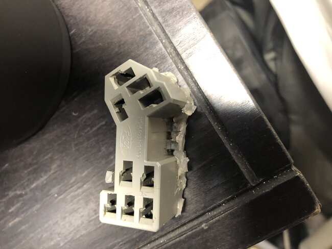

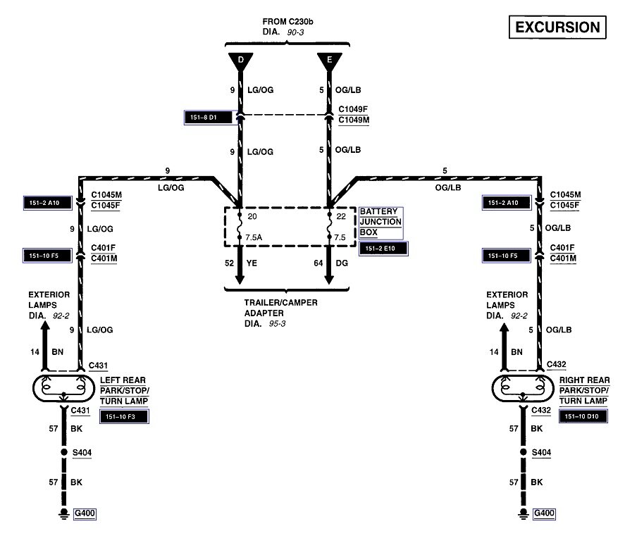

I'm trying to install a new connector, but my other one's wires popped out, so I don't know where they go.

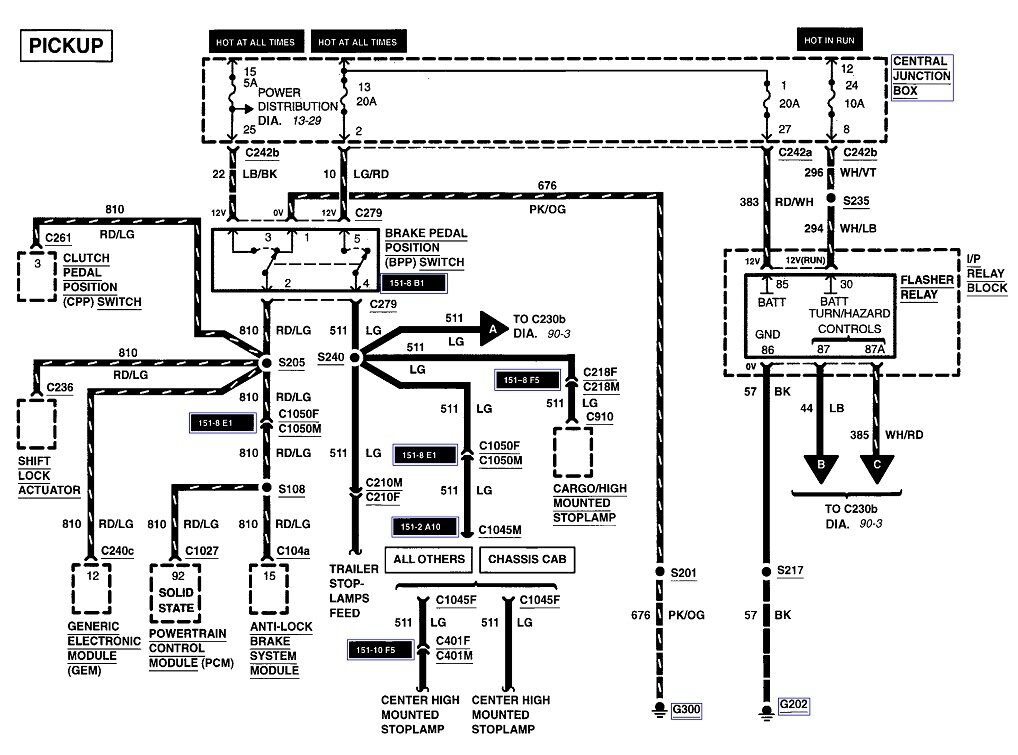

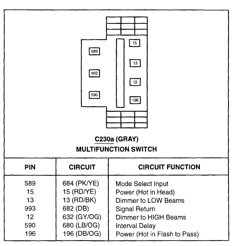

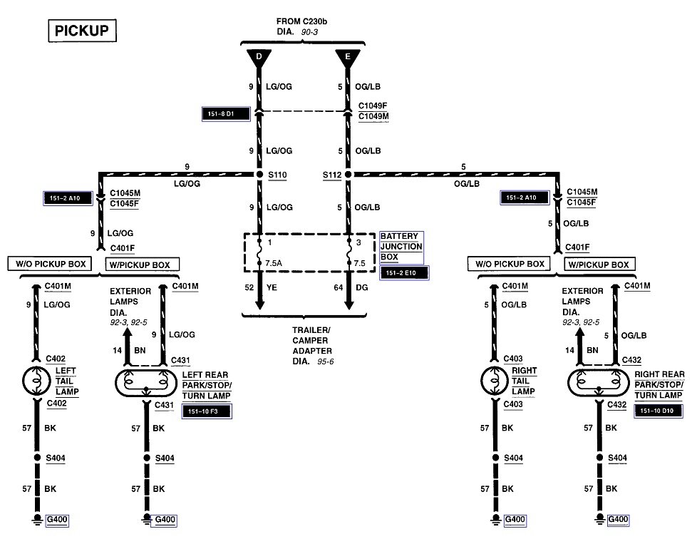

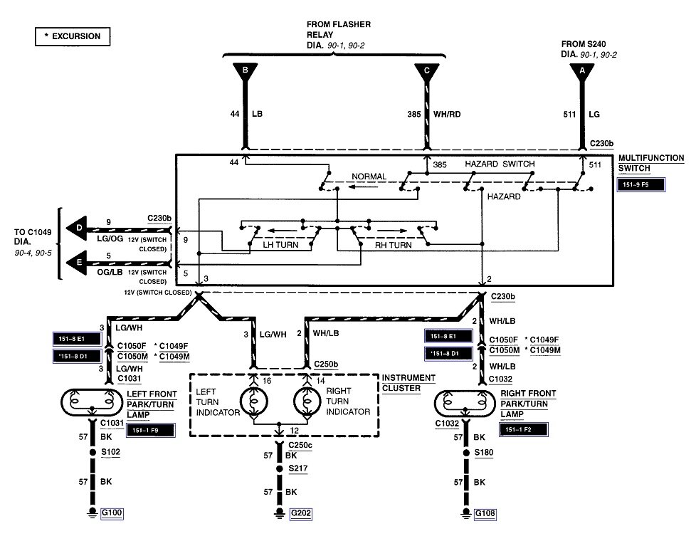

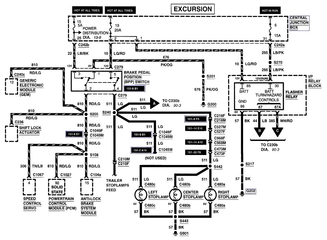

Here's the connector view for the multi-function switch. I added the exterior lights diagrams too in case you need them. The switch is in the third diagram.
+1
Friday, December 27th, 2024 AT 7:12 PM

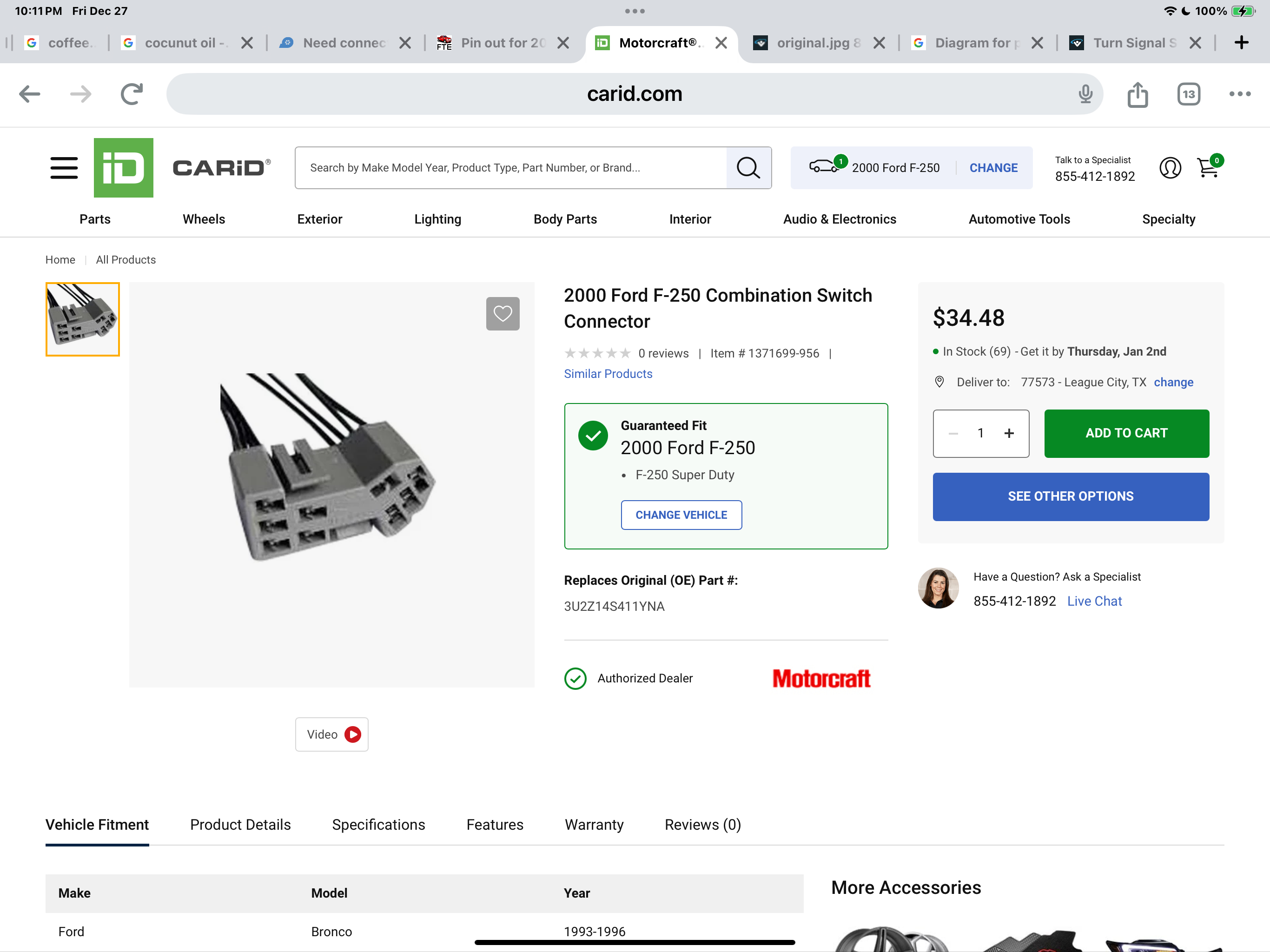

Sorry. I should have included a picture of the actual part. I need the wire diagram for this part.
+3
Friday, December 27th, 2024 AT 7:35 PM
ANNETTE ROWLADER
  • 7 POSTS
I can’t find this diagram for my 2000 f250 Supe-rduty E6DB-14489-DA.
Friday, December 27th, 2024 AT 7:37 PM

You'll have to tell me what it's connected to. I can't find the part number in my regular sources.
Friday, December 27th, 2024 AT 7:54 PM
CARADIODOC
  • 34,484 POSTS
I looked through about a fifth of the connector views. I'll have to continue tomorrow, but if you can't tell me what it's connected to, there's hundreds to look through.

The first drawing I posted is all they show for the multifunction switch. Do your wire colors match those shown in the list?
+1

I tried using an F-150 and different engine sizes, then looked at the wiper switch connector. All of them come up with the same drawing.
