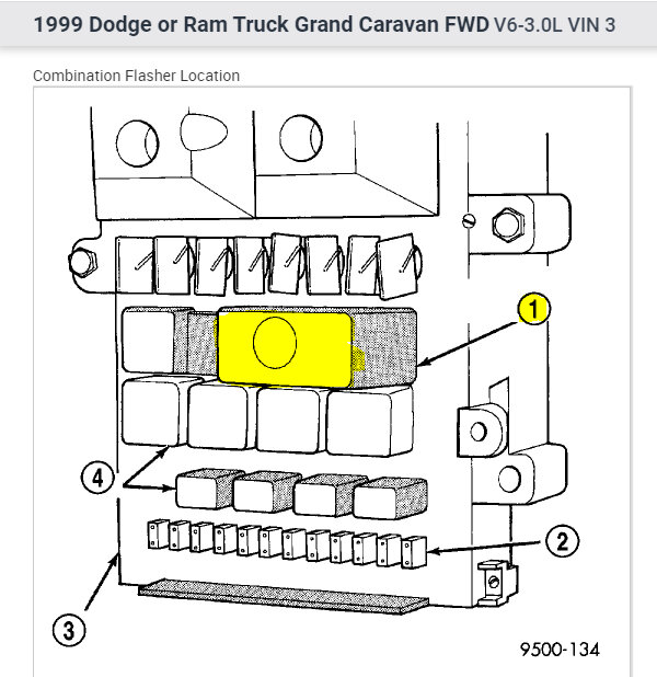

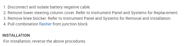

It sounds like the combination flasher is going bad. The idea that it works and then doesn't with a delay in restarting leads me to think it is overheating.
As far as grounds are concerned, they are at different locations. I wouldn't think all would fail at the same time. So, the flasher is my first suspect.
If you look below, I attached the directions for replacing the flasher.
Let me know if this helps.
See pic below.

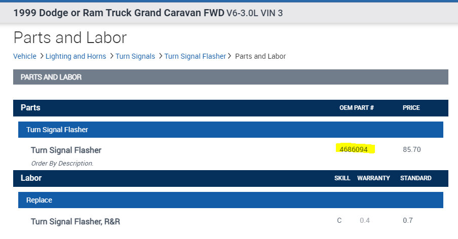

I will definitely give that a shot! I haven't been able to locate a part number for that though, the one's I locate look to be for a bigger relay and parts range from $170-$250 CAD. Any suggestions for a part number?

Wow! The OEM part is showing much less. If you look below, I attached the parts and labor for the replacement of the unit.
The part number has been highlighted.
Let me know how things turn out for you.

The part number ordered is: 4686094 (EFL15 Flasher)
The other part number shows as: (EFL88 Relay)
Any thoughts on this?

Hi guys. These symptoms reminded me of finding this problem on three or four of these vans at the dealership. The problem was caused by the excessive weight of the flasher pulling it down out of its socket. Simply pushing it back into place solved the problem temporarily, but the better fix was to tie it in place with a nylon tie strap.

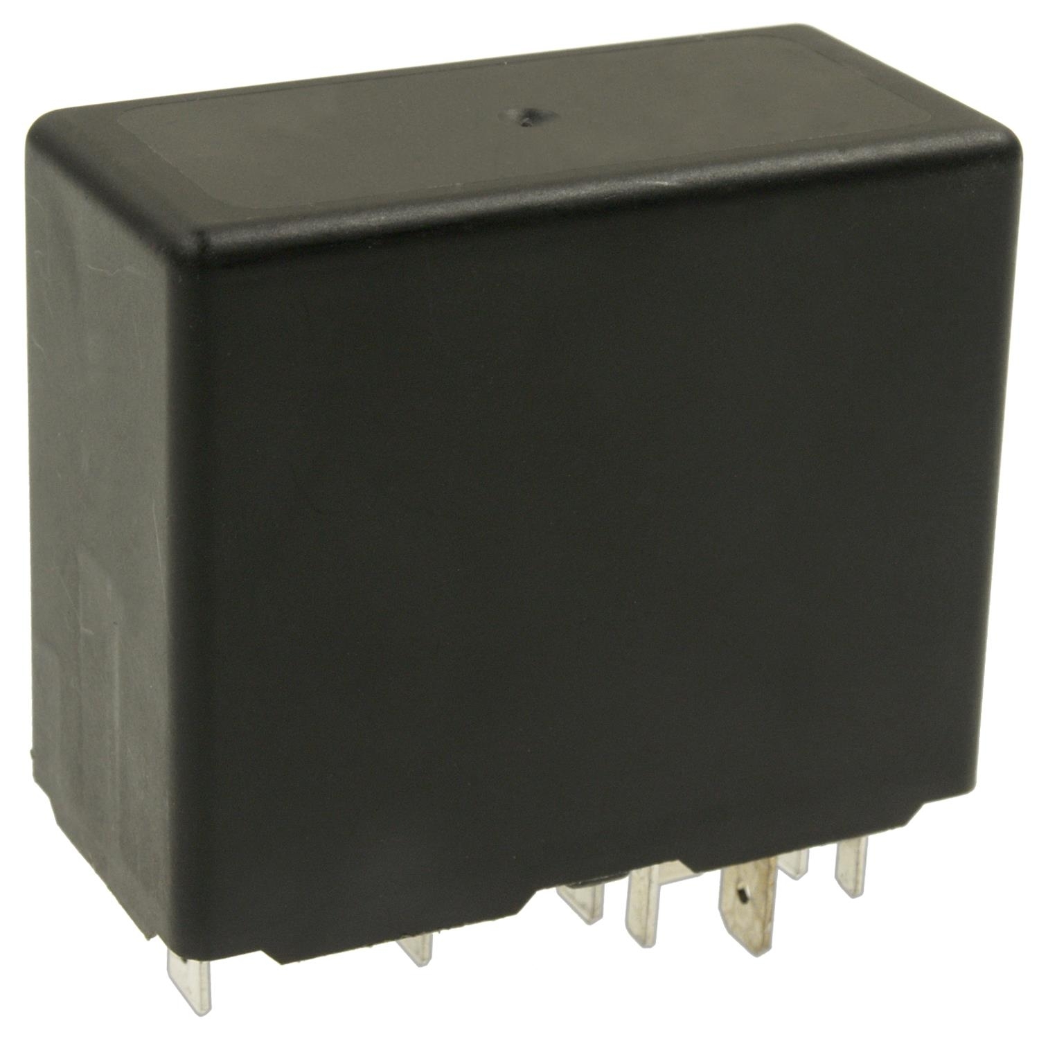

So Caradiodoc, you've absolutely nailed the solution here; the relay just seems to have excessive weight and a bit of wiggle. When the turn signals go out, I can push that up or down and manipulate it and they will kick back in. I've tried to locate a replacement relay in hopes that it'll simply suffice. This has proven to be a nightmare as most relays only come in as 1/2 of the double wide relay, I'm sure there is probably a way to tear this thing apart and insert the other half but I'm not going to attempt that.
The EFL88 part showed as being the double wide and arrived and wasn't so I think I finally found the right one on Rock Auto; my relay when I took it out lists the part# 4686190 so that's the one I have placed an order for.

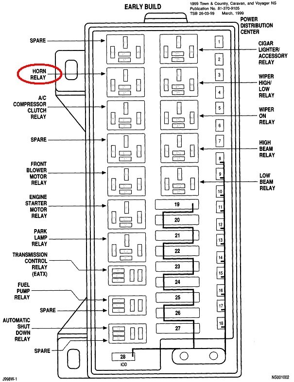

The horn still doesn't work; I checked the fuse, and it was blown, put a new fuse in and it blew right away again. Guessing there is a bad ground somewhere but it's snowing and wet and cold in Canada right now so until I can get the van inside and put it up on a lift, I don't feel like laying in the snow to pull back the wheel well to look for the horn, lol.

For the horn, grounds are not the issue. A broken ground would stop a circuit from working, but due to insufficient or no current flow. You have an issue of too much current flow.

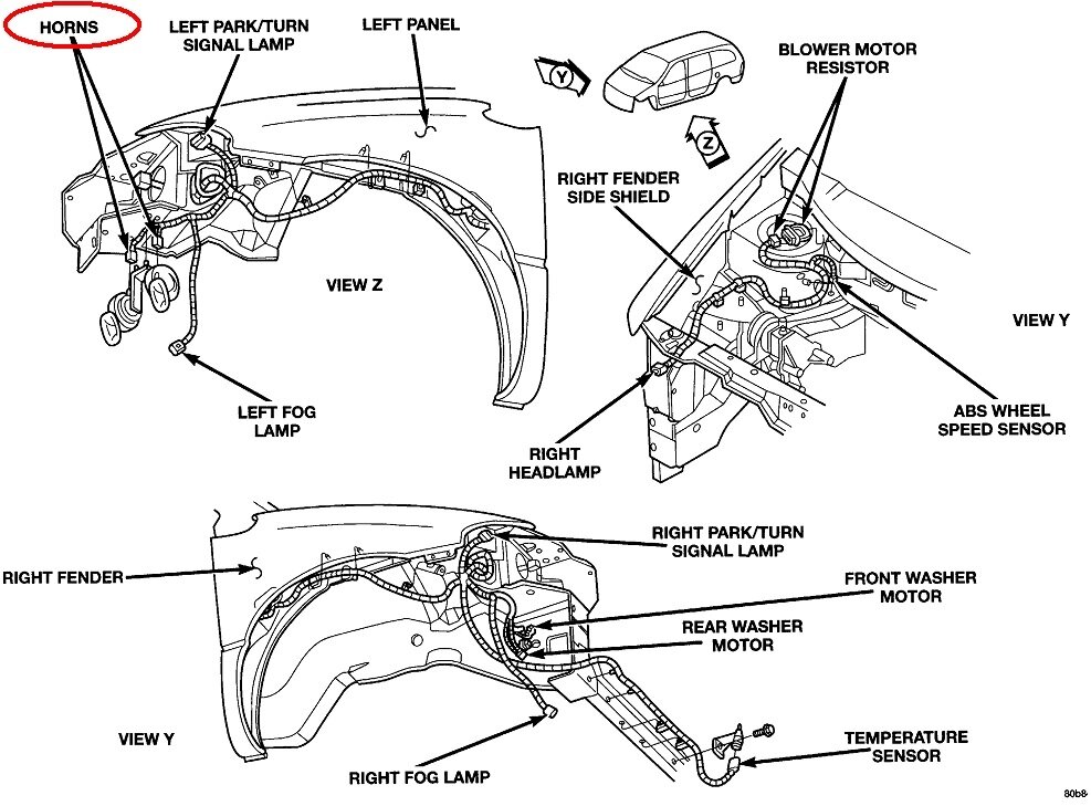

When you say the fuse blows instantly, do you mean as soon as you plug it in, or when the horn button is pressed? If it doesn't blow until you press the button, a shorted horn is the best suspect. They're under the driver's side headlamp housing. The fastest way to identify this is to unplug both horns, replace the fuse, then verify the horn relay clicks when you press the horn switch. If it does, everything else in that circuit has to be working. Now plug in one horn and try it. If the fuse blows, that's the one that's shorted. There's a "Lo" or a "Hi" molded on it to denote its tone.
