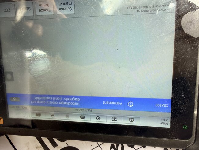

Car had a leaking oil filter housing so replaced that and all is good, but keep getting drivetrain malfunction message without a check engine light. Replaced the small auxiliary pump same thing. Code keeps coming back 20a503. Car drives fine

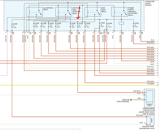

You’re right on the target area, 20A503 is for the turbocharger auxiliary coolant pump circuit-self-diagnosis, not a normal engine misfire or fuel code. It can trigger a drivetrain malfunction message without a check engine light.
Since the oil filter housing was just replaced, I would first recheck the connector and wiring at the auxiliary/turbo coolant pump. Next, I would check the 5 amp fuse #2 that runs the pump inside the intergraded supply module. It is only 5 amps so when the pump goes out it pops easily. Let us know how it goes. What do you think of the new site design?

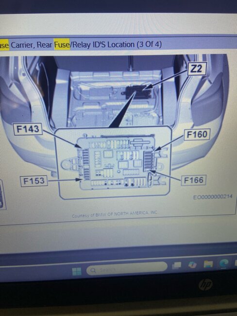

Number 2 fuse has a dummie fuse i replaced it but looks like there are no connections there. Can you recheck. Number 2 is in the e trunk by battery

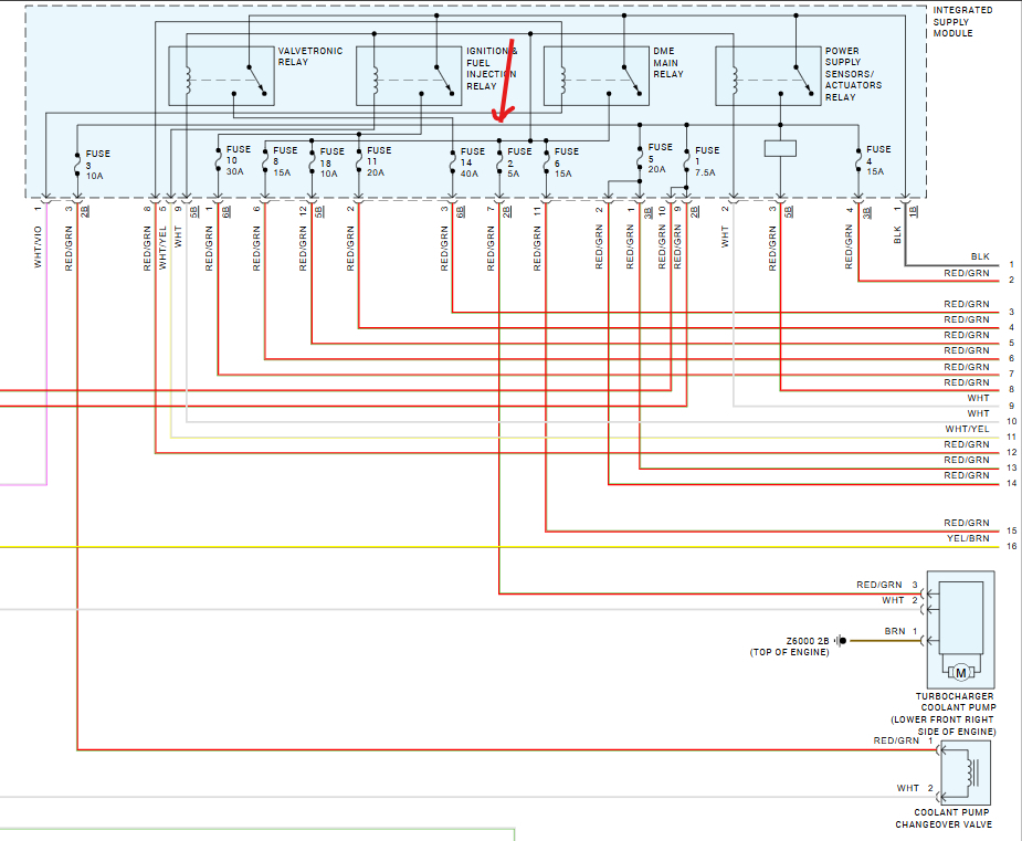

You may have blockage inside the turbo not allowing the coolant to flow. The fuse panel should be under the hood for the #2 fuse. Here is the wiring diagrams for the turbo water pump. Check out the images (below). Let us know how it goes

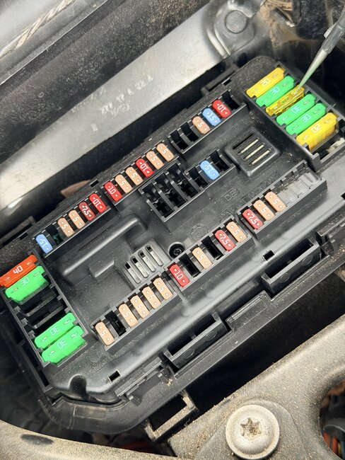

The fuse panels is not numbered. Any way u can find out which one is #2?

Only fuse i found burned is the one am pointing to which is a 20 amp fuse. Replaced it and now bleeding it again. I can feel the water in the hose coming out of the turbocharger coolant pump moving but i barely see any bubbles ir anything coming in any of the reservoirs

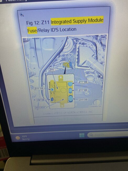

  • 54,487 POSTS
Yep, the fuse is a 5 amp unit so it doe not look like the fuse you are pointing too. You should be able to ground the white wire and brown wire, then put 12 volts tot he red/grn wire and the pump should run. You should check to make sure there is no blockage in the cooling lines as well.

I cannot find a diagram showing which fuse is #2 but all 5am fuses are good. There are 2 grounds showing with the probe. Ill have to find a way to do 3 wire jump while harness is connected its a tight space
May 12, 2026 at 3:25 PM
  • 54,487 POSTS
You can see the fuse in the wiring diagrams above.
May 12, 2026 at 3:45 PM
BHAMDOC1
  • 184 POSTS
Oh, where it says 1 thats fuse 1? Thought it has to do with the diagram labels or they were pointing to something
May 12, 2026 at 3:58 PM
  • 54,487 POSTS
It is fuse #2 in the fuse box. Just check all 5 amp fuses.

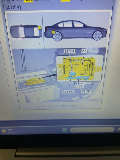

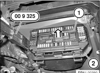

Contacted a friend who has alldata abd he said he repaired the ivm on manyof these. Has a non replacable fuse. I remember i did too on an older bmw which fixed power to the main electric pump not this one but ill check. But he sent me 2-3 different locations. Is the one under the hood like u mentioned where the fuse is tbh e one to look at?

YEs, the ECU grounds the circuit, the pump fuse gets is power from the DME control relay, please check out the wiring diagram above.

OK 2 QUESTIONS. The fuse for the turbo charger, does it only control the pump ? Also, the fuse is within the big fuse box under the hood correct? not the one in the trunk or the IVM by the fuse box under the hood which has no fuses, but rather have 3 connectors. The guy said there is a non serviceable fuse, and since there are so many fuse boxes I gt confused

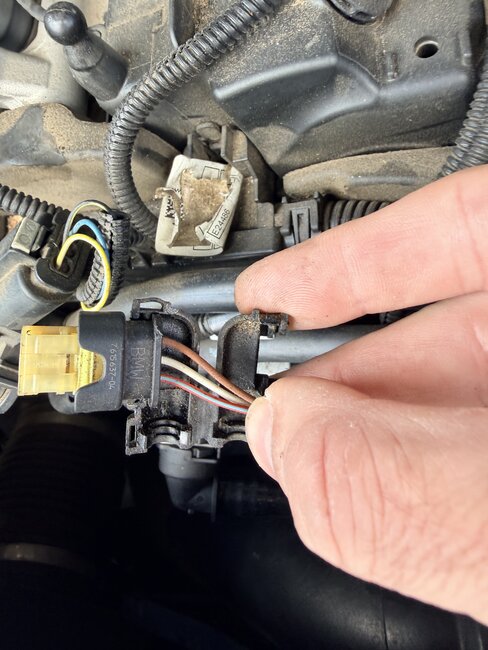

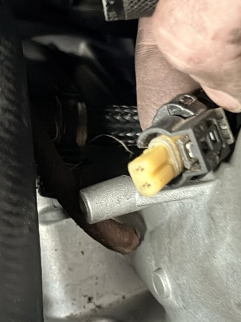

BHAMDOC1
  • 184 POSTS

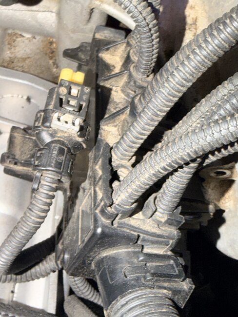

With ignition off the red and blue is ground, nothing on other 2 wires. With ignition on red and blue becomes power. White one is ground. With car running. With car running same as with ignition on. Nothing on the brown wire
May 18, 2026 at 5:21 PM
BHAMDOC1
  • 184 POSTS
Attached

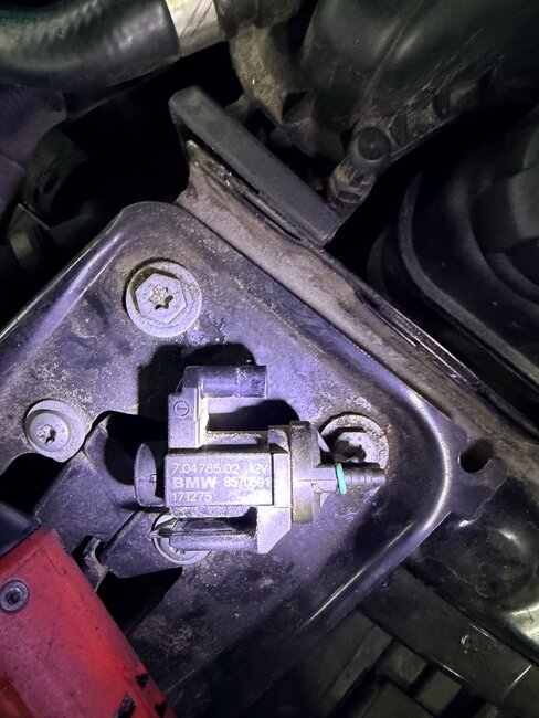

  • 54,487 POSTS

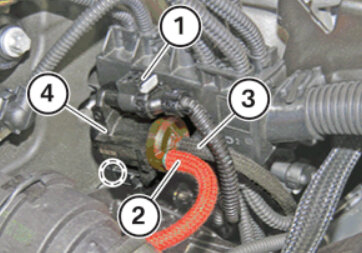

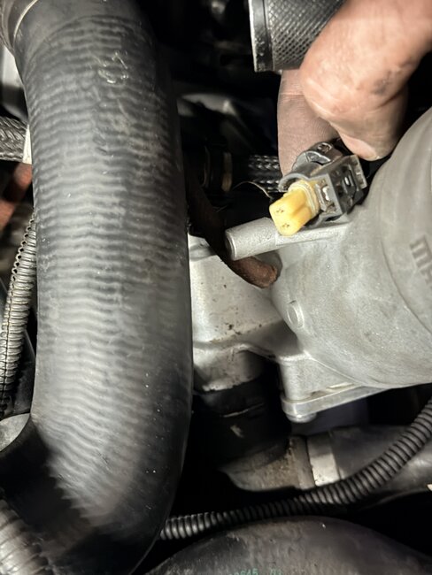

Okay, the wiring seems okay so that is good, since you changes the pump out I would check/change out the coolant pump change over valve. Here is the location. Here is the location.
May 19, 2026 at 2:24 PM
BHAMDOC1
  • 184 POSTS
ok I remember this valve, hopefully I just forgot the connector off and I remember two vacuum hoses maybe switched them. This is next to the oil filter housing. what does this do?

What is the job of this valve
May 19, 2026 at 3:30 PM
BHAMDOC1
  • 184 POSTS
Removed the i take again, no pinched or loose wires. Removed this change over valve. Any way to bench test it? Just ground and power? Also any idea if it could have a fuse?

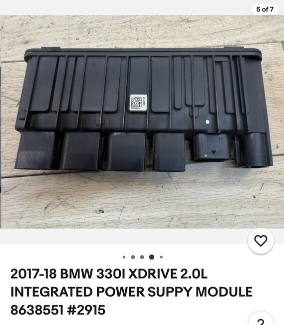

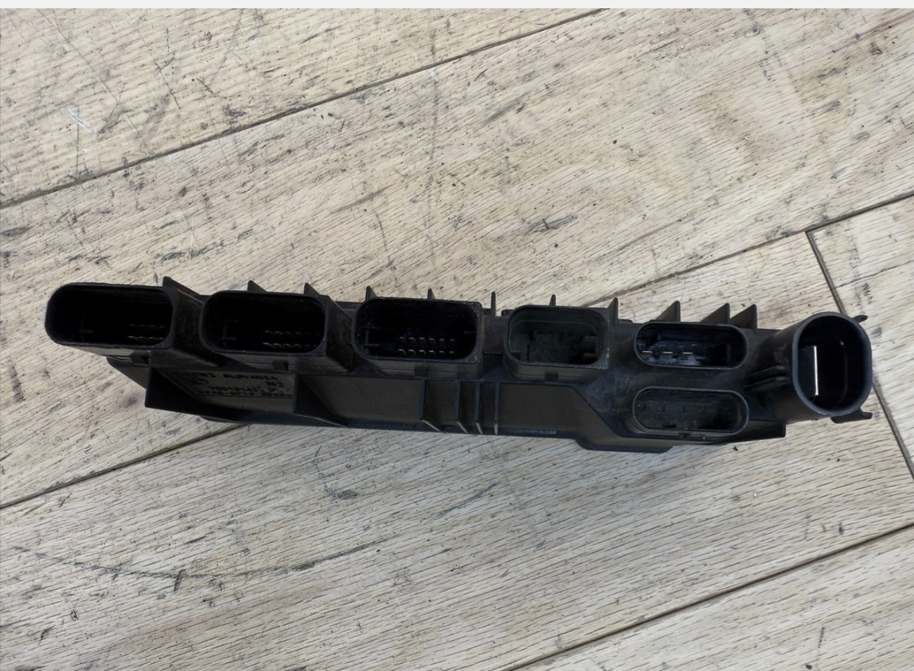

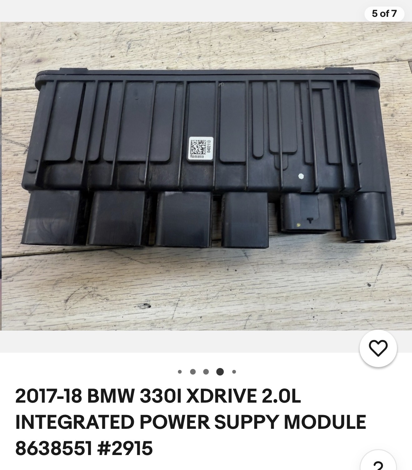

Also there is a power module by the ecu that i remove when taking intake out. Looks like this one in the picture. I opened the bottom slightly and saw fuses. Can you see if this change over valve has a fuse as well or where it gets power from. Also since it only has 2 wires, how does it come on without a 3rd signal, cant be coming on all day. And by the way pictures load up super fast now compared to previous site

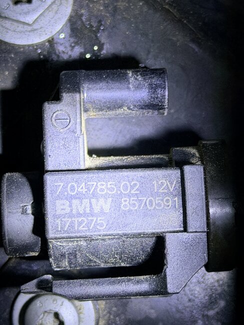

I looked up the number on the part you told me about and it says its a boost pressure and egr vacuu
Solenoid valve

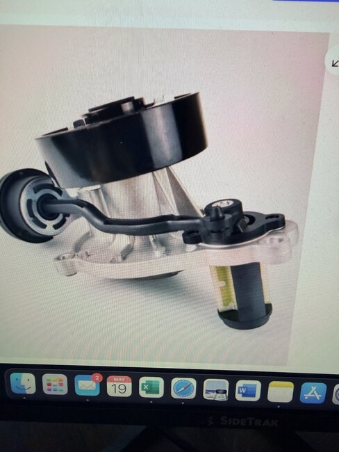

I saw the main water pump, which is mechanical, and it has on the side something like an adjuster. I pushed the adjuster using the arm and it creates a vacuum fine and then that small pump that creates vacuum has a vacuum hose, which goes to that piece i removed. It looks like this in the picture
