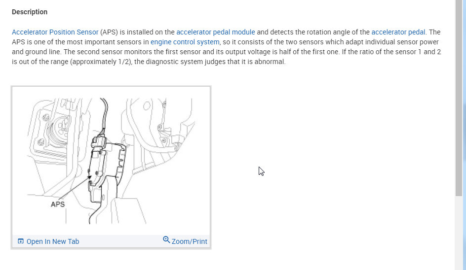

This clearly is a serious concern so while taking it to the dealer is important, it is even more important that you call the OEM directly. I would put a call into the customer support line even if to just document what it happening. The dealer is going to only take action if they can find something with this because it is a serious potential defect so they are not going to guess. So it is not surprising that is how your visit went with the dealer.
However, the OEM may get more involved just to make sure there is no emerging issue with the vehicles.
As for what the issue could be, we need to have them monitor the Accelerator position sensor while this is happening. That will tell us if there is a possible pedal issue. It could just be sticking or there could be a sensor issue.
