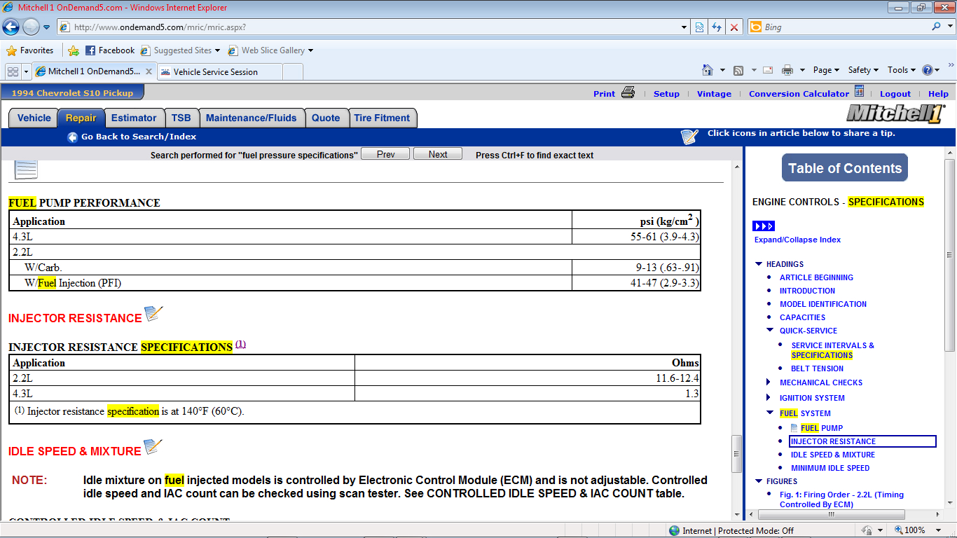

See attached image of fuel pressure specs.

Ok. Thanks again. I checked the fuel filter, a little dirty but not bad. With a listening device on the fuel tank, you can hear the pump start making weird noises right before it quits running and stalls out the engine. The battery power to the pump remains constant as does the ground, so it's looking like a fuel pump is needed. Do you guys recommend a fuel pump only or the whole drop in assembly? The parts stores are asking about a harness code? Where do I locate it? I examined the harness but no tags could be found? There are a few different ones for this truck, not sure which one to get.

The whole drop in assembly usually includes the fuel level sending unit and float, along with the filter sock. If the gauge isn't acting up, I would go with just the pump. I couldn't find anything about a harness code, so either take a picture of the connector, or take the old pump in.
