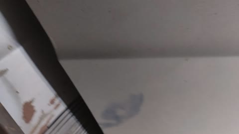

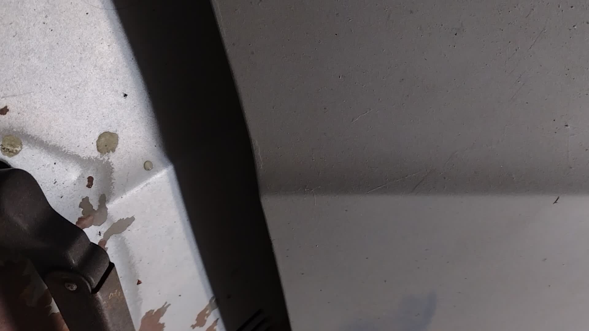

Here is the video. I hope the sound is good enough. If not, I can take another. And like I mentioned it started and ran for few minutes a couple times after the head gasket was replaced and now it's like this. The overall ability to start got a little better with the new battery and starter but that's it.

Thanks for the video. Yep, it sounds like the timing chain has jumped or the distributor is too far advanced. I would retard the timing to see if it makes a difference and then remove all spark plugs and try to crank it over, and then do a compression test to confirm the problem.
