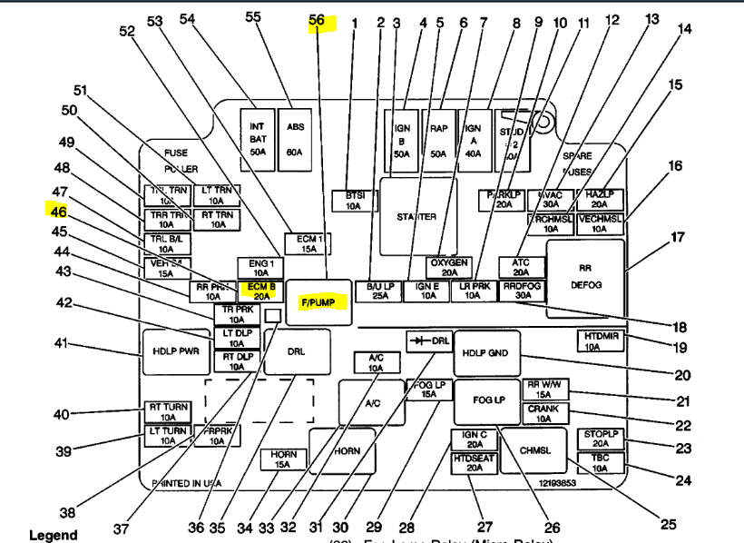

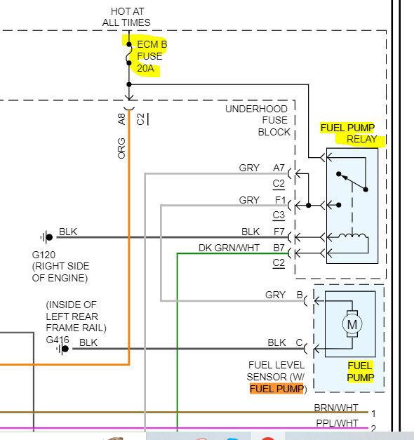

Let's try this. In the under-hood fuse box, you will find an ECM B fuse and the fuel pump relay (see pic 2). Remove them and inspect where they connect to make sure nothing is corroded, pushed in, or damaged. If everything appears good, switch that relay with a different one in the box that has the same part number. See pic 2 for fuse/relay location.

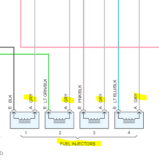

If there is no change, I need you to check the power to the fuel injectors when it won't start.
If you look below, I attached a schematic showing the injectors. See pic 3. Each injector has a gray wire. Check for power at each injector's gray wire with the ignition key in the run position. You should have power.

Okay. So, I checked ECM fuse it was good. I changed out the fuel pump relay and still nothing. If I spray starting fluid into the motor, it will run until I shut it off for at least 15 minutes then it won’t start back. I’m currently going to buy a code reader and see if it’s throwing any codes. I’m at a loss with this stupid a** truck!

Were you able to check if the injectors are getting power? If you did and they are, have a helper try to start the engine while you confirm power is still present at the injectors. You may be losing the injector pulse or power supply when the key is in the start position.

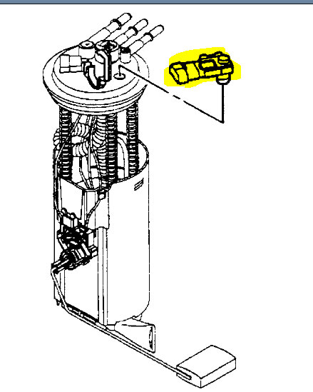

Okay, so I changed the fuel pump. It will start now but when it’s idling it sounds good but when you give it gas it sounds like it’s missing bad and will rev limit at 4,000 RPMs. I haven’t driven it yet to see what happens while going down the road, but I can tell something isn’t right. The code reader is only throwing a 02 sensor and a fuel tank pressure censor circuit low voltage. Would those have anything to do with it?
Saturday, February 11th, 2023 AT 7:03 AM
  • 110,192 POSTS
Either can affect drivability. However, the fuel tank pressure sensor is more likely because it is tied into the EVAP system.
Could you send me the specific codes you are getting?
Also, if that is a new code, you may have left the connector at the top of the tank loose or not fully connected. I attached a pic of the sensor below. Do you remember connecting it? Also, could you record what it is doing and upload it for me to hear?
If your scan tool has live data, let me know what the short-term fuel trims are when the engine is at operating temp. Also, watch the voltages from the oxygen sensors. They should be between 0.1v and 1.0v and change especially when you hit the throttle.
See pic below.
