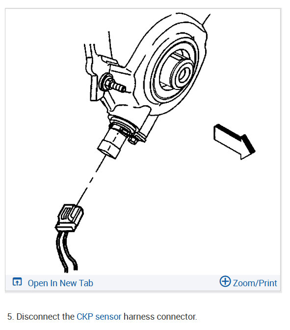

I use to work as mechanic but this one stumps me.I went to start it one day after it set for about 4 days. It would crank, has spark and I can hear fuel pump butt it won't start.I can wear battery down and then jump it and it won't fire.I had to move rig so I got tow and I put it in second gear and it fired up. If I start it every day it's fine but after two days I have to get a tow to start. Im going to add something here but reluctantly. After this issue started I misplaced key and had to move rig or get towed so I drilled out ignition carefully. Then found key but loose fitting it would trip security so I bypassed it by cutting one of the four wires at key and splicing it into the other wire to bypass it then did key relearn. My security light stays on all the time but ass long as I start it daily it's fine.I only mention that to rule out the security key issue.I plan on replacing key lock and using my old key by changing tumblers and relearn old key after repairing the bypass.I can't afford to do guess and check by buying random parts. My thought is ignition module because I know there is two parts to that. Once it reaches about 500 rpm the computer takes over and tells it when to fire.I had a 1994 c10 that when it got warm it would die and not start until engine cooled off. It wasn't overheating just bad modual.I have the 4L v6 I think it's 4.2 but can't confirm that. Know I should but rig is across town. Had to get a tow start again. Let it set 3 days. What do you think.I use to be on fixed income.I only got paid for what I fixed. Now I don't have income. But that is another issue

KEN L
  • MASTER CERTIFIED MECHANIC
  • 55,481 POSTS
I have seen a weak crankshaft position sensor cause this issue. Here is the location so you can swap it out. Check out the images (below). Please let us know what happens.
