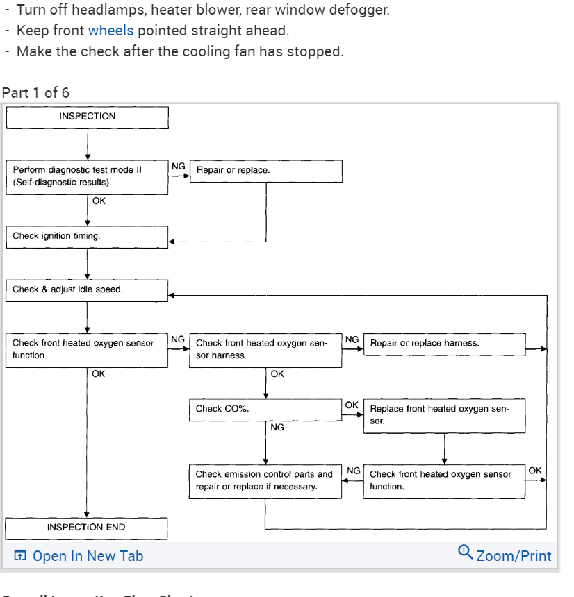

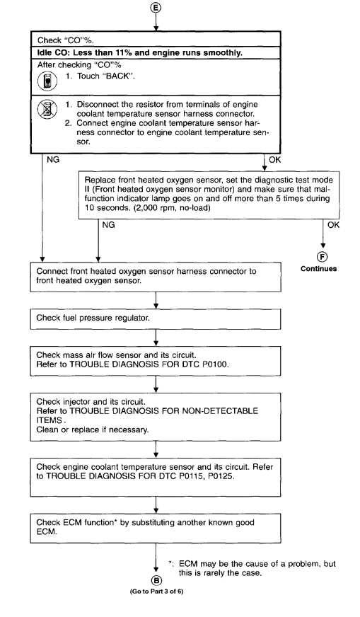

I just replaced my head gasket and timing chain. Truck ran fine until I put it back together. New chain new gears. I aligned marked links to proper punch marks number one cylinder at TDC. Put it back together now it will start only will take no acceleration at all shuts off instantly, idles okay. Little hard to start but not real bad. Now I've pulled the distributor back out with number one cylinder at TDC. I notice my rotor is pointing at about one o'clock instead of directly at number one spark plug wire on the distributor and the oil pump gear spindle is not pointing straight up and down at twelve o'clock like the manual picture shows. But is it possible the truck would even start if the timing is not right on? The truck ran great before the repairs. It has a lot of new parts; MAF, Map sensors, new distributor, new plugs, new fuel injectors, new fuel filter and new fuel hose. What could possibly be causing this problem? Timing my gut says but if timing was off I don't think it would start. I tried putting distributor on various spots but it will not stay running. Thanks in advance for your assistance. JC
Wednesday, February 13th, 2019 AT 1:49 PM
16 Replies
SCGRANTURISMO
  • 4,897 POSTS

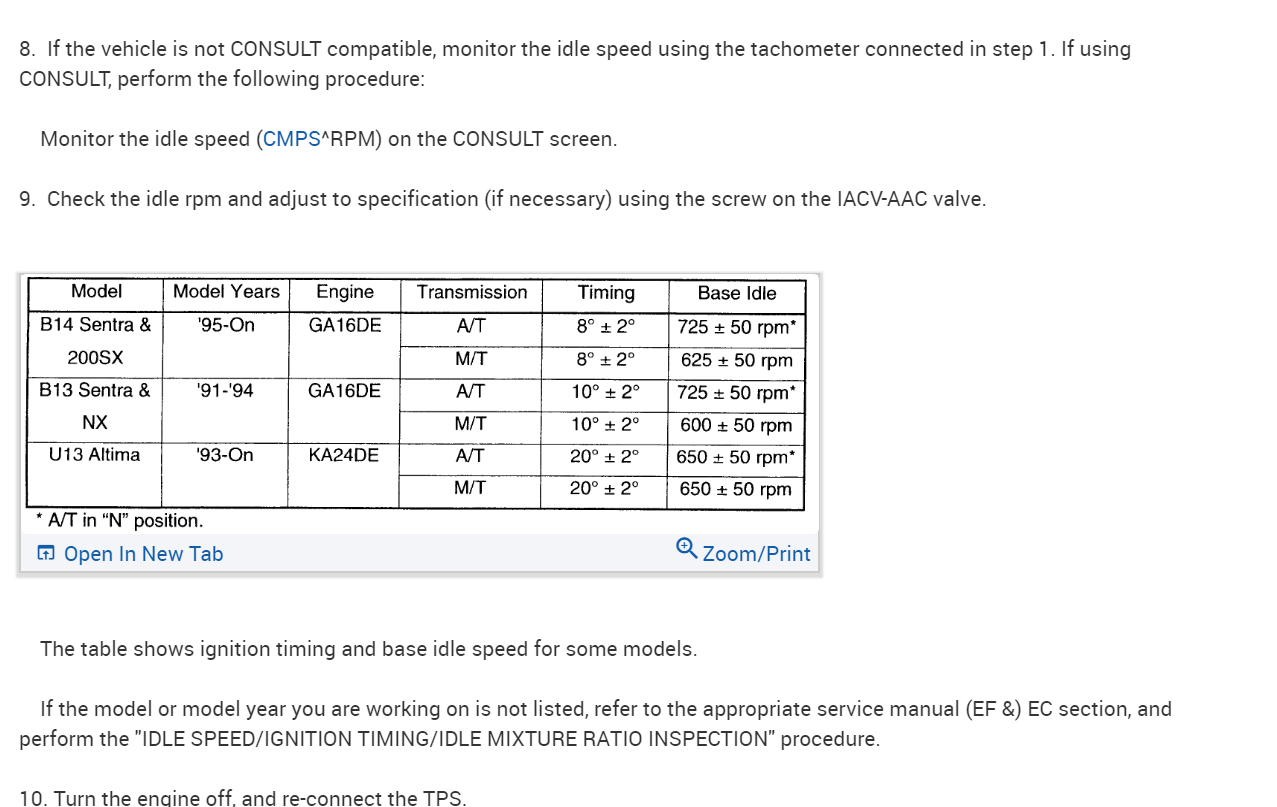

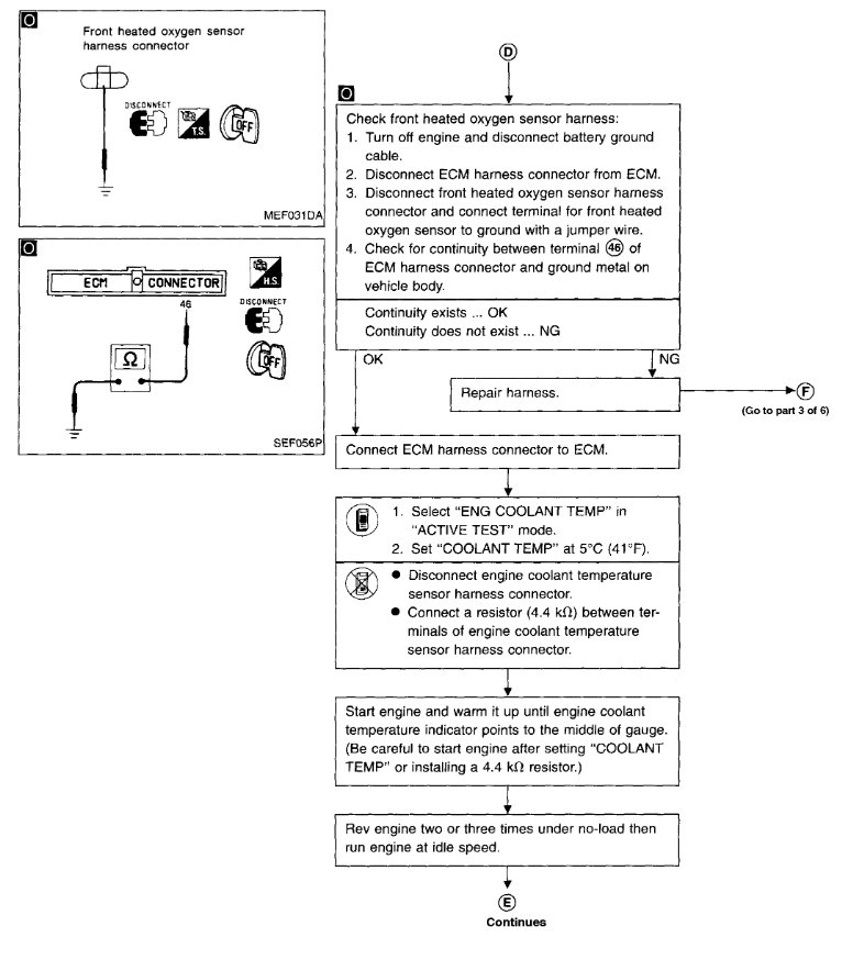

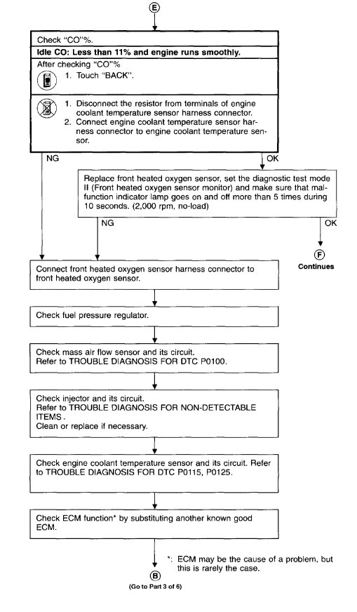

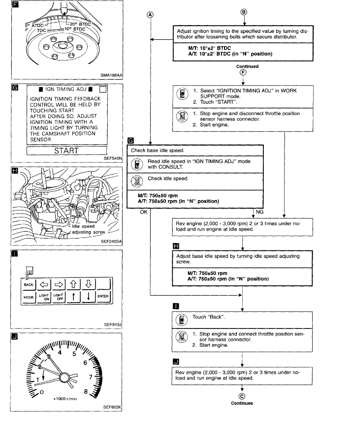

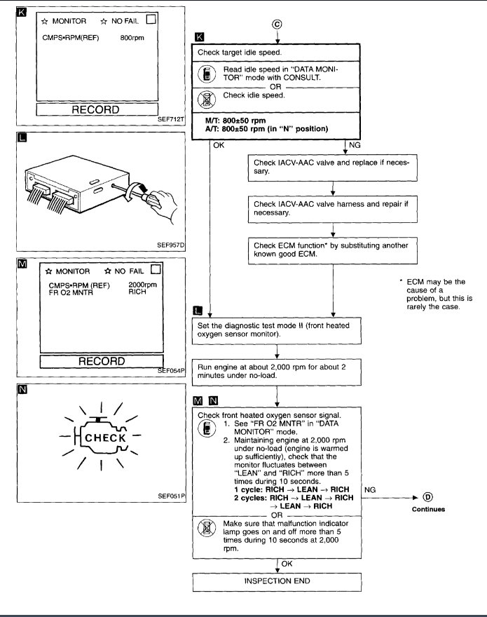

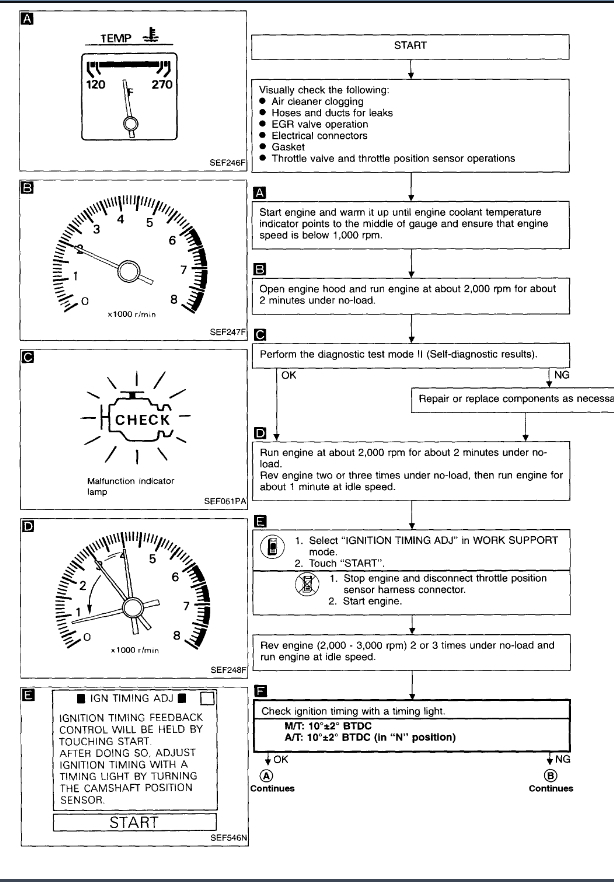

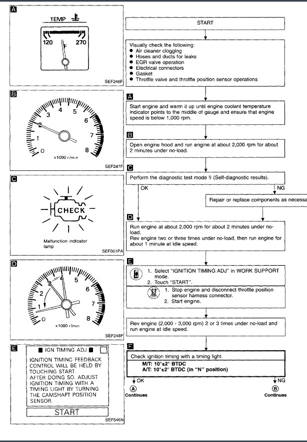

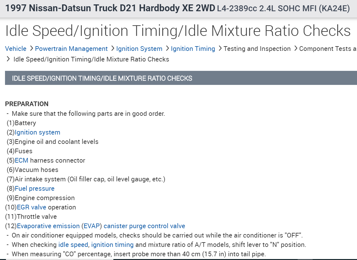

Yes, this does sound like a timing issue. Your vehicle will start with the timing off a tooth or two, but it will idle irradicly, sputter, and have no power at all. The danger is if the timing is off too far, you can do damage to the pistons and valvetrain, i.E. Bend valves and leave "kiss" marks on the tops of pistons. I have included for you in the diagrams below a step by step guide from the vehicle manufacturer on troubleshooting your ignition timing. Please go through it and let us know what you find out.

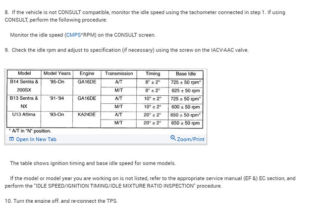

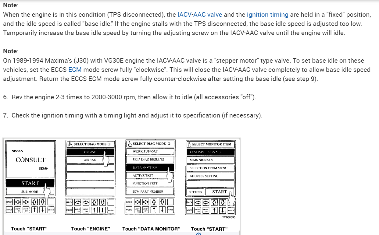

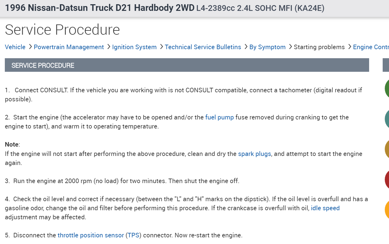

You said that number four plug is fouling. How is it fouling? Oil fouling, gas fouling? This will make a big difference as to how to proceed. Get back to me and let me know about plug. I have also included a hard start diagnosis Technical Service Bulletin (TSB) from Nissan. You might want to go through it and see if it helps at all?
