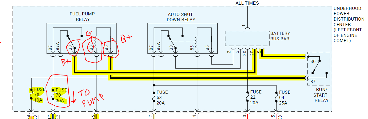

If the ASD checks good, we need to check a couple of fuses and the pump relay.
If you look below, I attached a pic from the schematic. Check fuses 70 and 78 in the underhood fuse box. If they are good, remove the relay and locate connector pins 85 and 30 for the relay. Connector 85 should have power when the run start relay is closed. Check if that is the case.
Pin 30 should have B+ at all times. Confirm that as well. If they both get power, then I need you to jump connector pins 30 and 87 of the fuel pump relay to see if the pump turns on. If it does, then we likely lost ground at connector 86 which is provided via the PCM. If it doesn't turn on, we need to check if there is power at the pump when these are jumped.

Okay, so, fuses 70 and 78 are both good. Now the Fuel pump relay on Rams is located inside the TIPM and is soldered to the circuit board. Is there a way to test that without taking the TIPM apart?
Feb 1, 2024 at 10:46 AM
  • 110,193 POSTS
The only way is to check for power and ground at the wiring. Is that something you are comfortable performing? Let me know.

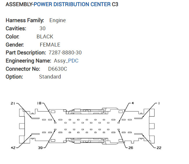

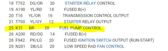

You know what, let's try this in a different way that will be easier. Fuse 70 shouldn't have any power when the key is off. When you first turn the key on, it should have power. Check that. Do this with a helper so you can tell if power is available as soon as the key is turned on.
If it is, then I need you to locate the C3 connector at the power distribution center, locate pin 25 (brown wire), and check for continuity to ground when the key is turned on. A ground path should be provided to actuate the primary side of the relay and engage the secondary.

Let me know if you are comfortable checking pin 25 on the C3 connector for continuity to ground. If you have a test lamp, connect the alligator clip side to the battery positive. The tester side goes to pin 25 on the PCM side. Have a helper turn the key to the run and then start positions to see if the test light turns on.

I located C3 and pin 25 and nothing once the truck was turned to the run or start position.
Feb 3, 2024 at 12:17 PM
  • 110,193 POSTS
That would indicate the PCM isn't providing a ground path. On the other hand, you also indicated there is no power to fuse 70 when the key is turned on. Based on that, we have two different problems. Are you certain there is no power to fuse 70? And on the PCM itself, pin 25 doesn't provide a ground path?
I want to say the PCB/TIPM is faulty based on no power. The ground is something different. I wouldn't think both would fail at the same time.

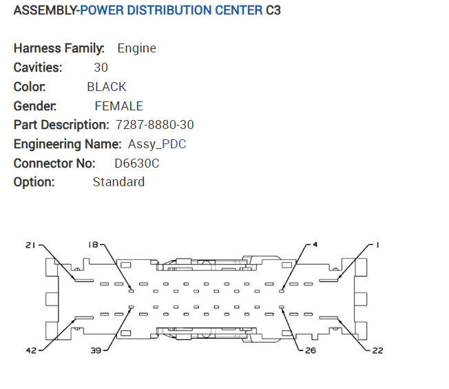

I'm wondering if the connection on pin 25 could be corroded? I have a digital tester and the I would either get nothing or a very very faint green rather than the bright green or red with a power reading. Fuse 70 doesn't have power I tested it a few times and got nothing. I was going to pull the TIPM tomorrow and check pin 25 to see the connection to the C3 connector.
Feb 3, 2024 at 5:52 PM
  • 110,193 POSTS
Anything is possible. I think checking the connector pin is a good idea. When you do it, make sure there are no cracks or damage on the pin. It is a somewhat common issue.

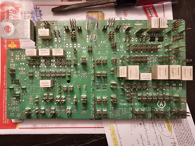

Good evening. So, I removed the TIPM and cleaned up the connectors along with the pin 25 and found it was a little on the dirty side. Now there was still no power at fuse 70 so I had opened up the TIPM to see if I could find the fuel pump relay and cannot find it. Before I order a refurbished one do you possibly know which one on the circuit board is the FPR? I have googled and nothing has popped up for a 2013 Ram 1500 with the 5.7. I took a picture of the PCB.
Feb 4, 2024 at 6:24 PM
  • 110,193 POSTS
You've been busy. I tried to find a layout of the PCB and there is nothing. Based on what you have already done, I feel funny suggesting this because likely you already have done it. However, check for cracks or burnt spots in the PCB. They can be hard to find, but use a magnifying glass to get an up-close look. You may be able to find it if there is one.

One quick question or idea I have. What if I hook the PCB back up to the truck and turn the key on, if the relay is bad when I use the tester it shouldn't do anything, should it?
Feb 5, 2024 at 6:24 AM
  • 110,193 POSTS
That is correct. Please keep in mind there could be an issue related to the PCM providing a ground path to the primary side of the relay. That would be something other than a relay issue.

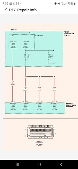

I have the truck listed above that will stall out when I hit a bump. It will crank but not turn over. I had talked with someone on here before and thought I we had figured it out. Before I wasn't getting any codes. Now I am getting a P0688. I have blown 3 fuses to the fuel injectors. With my diagnostic scanner it will give me a wiring diagram to follow, but I'm a little stumped on what F342 is or K51. Any help will be appreciated. I'm about to lose my mind with this.
