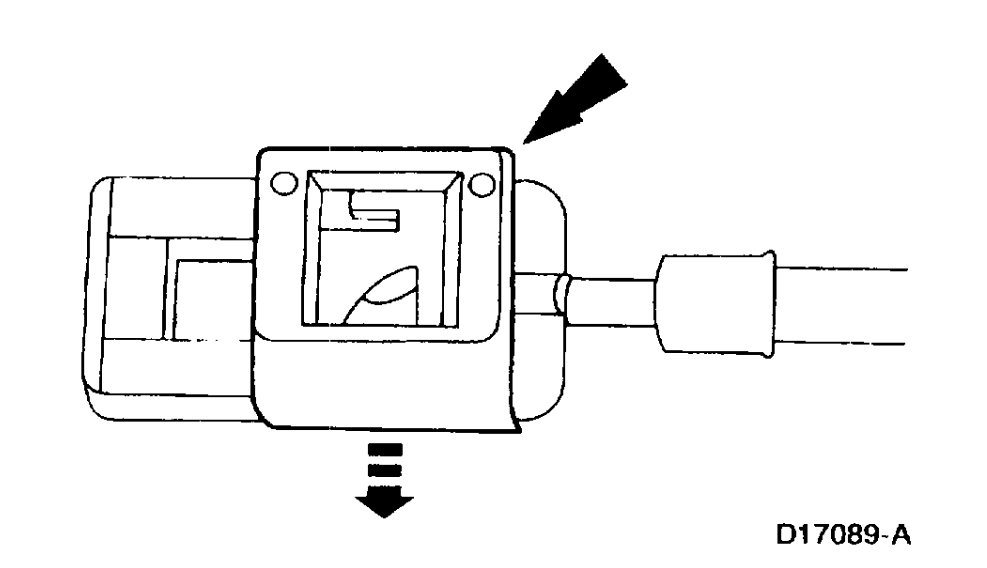

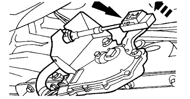

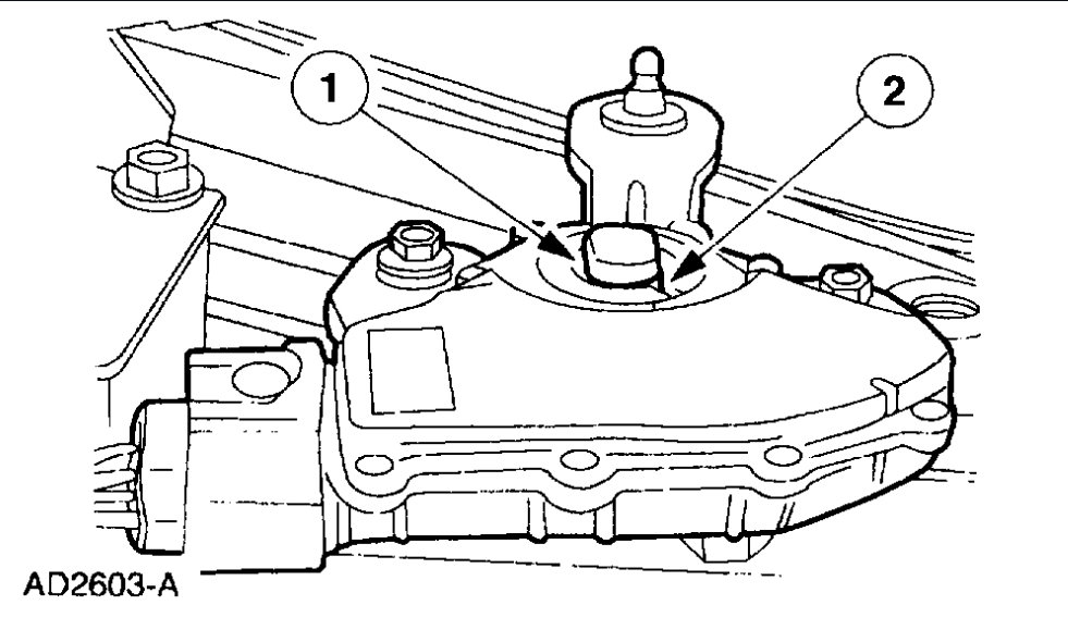

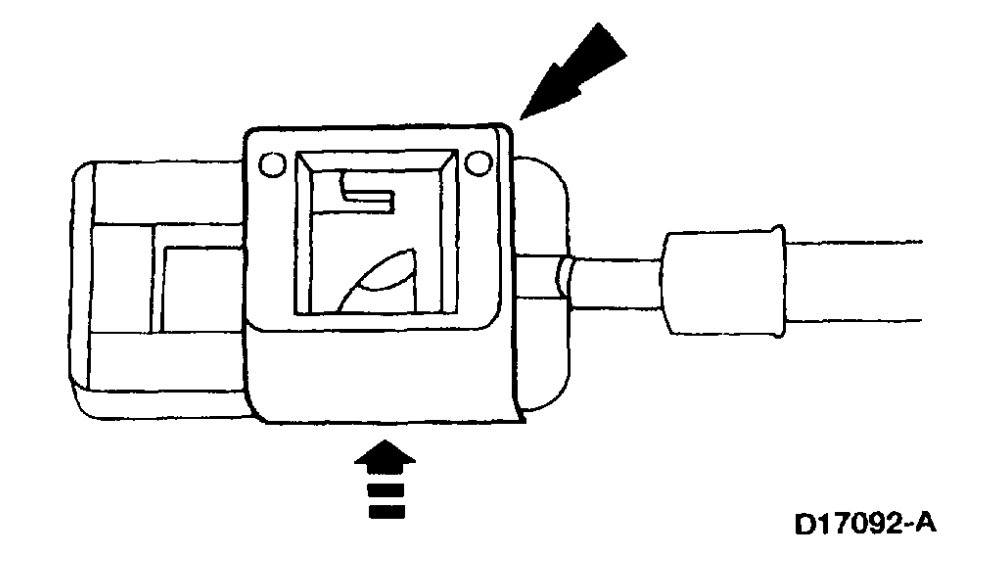

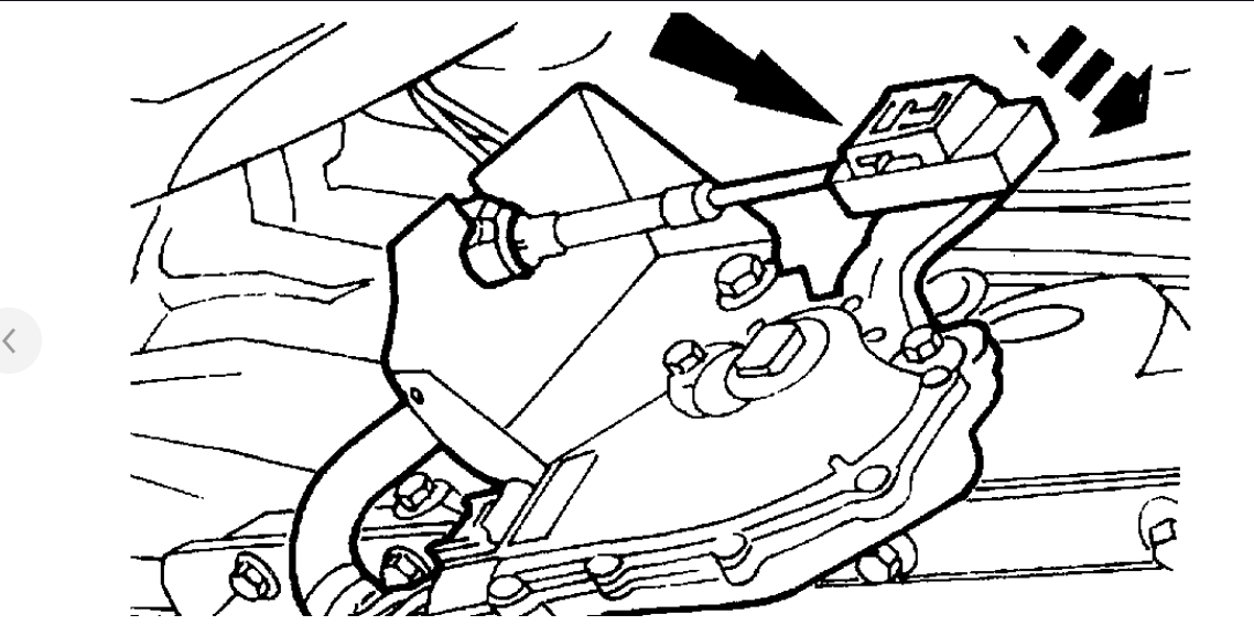

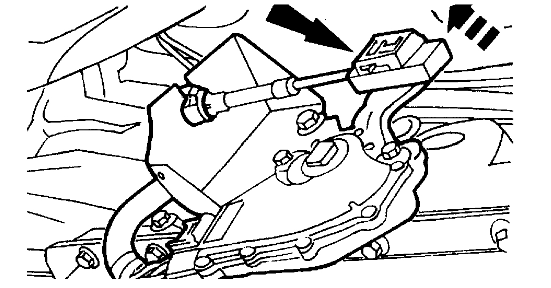

My truck comes out of park without having the key in it, or even pressing the brake. It doesn't go into reverse, it just comes out of park and will roll if on a hill.

I attached a procedure for adjusting the cable. It may be just an adjustment of the cable itself.
Cable and Bracket Adjustment -5.4L with 4R100 Transmission

3. Disconnect the transmission shift cable from the manual lever.

4. Unlock the lock tab on the transmission shift cable.

5. Place the manual control lever in the (D) position.
1. Place the manual control lever in the first gear position.
2. Move the manual control lever two detents to the (D) position.

6. Connect the transmission shift cable to the manual control lever.

7. Lock the transmission shift cable lock tab.
