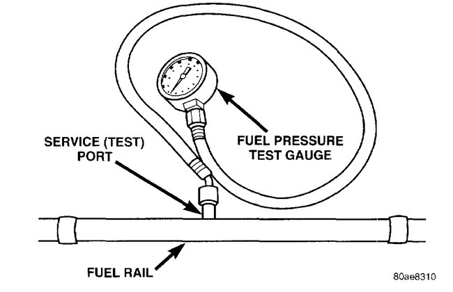

First 15 minutes driving home was fine, no issues. Came to a turn and slowed down then the truck (auto trans) started to stutter. She was having trouble keeping up with switching gears, then stopped at a red light (still stuttering while slowing down), when the light turned green I gave her gas and she stalled out. Emergency brake light was off the whole trip but when I started her back up the light blinked on. I pulled the E-brake release and it was only pressed about 1/4 down, barely applied. After I pulled the release she has been driving normal with no issues so far its only been a couple hours. Is this a transmission issue?

I don't think it's a transmission issue or related to the parking brake. Is the check engine light on and staying on when the engine is running? If there was an engine misfire, the light should be on. Also, weak fuel pressure can cause what you described as well.

Hey Joe, there is not a check engine light on. How do I check/fuel pressure?

Here are the directions specific to your vehicle. They include the manufacturer's specs. You will need a fuel pressure gauge. However, most parts stores will lend or rent one to you. The attached pic correlates with the directions.

Fuel Pressure Test Gauge (Typical Gauge Installation At Test Port)
Pic 1
1. Remove protective cap at fuel rail test port. Connect the 0-414 kPa (0-60 psi) fuel pressure gauge (from gauge set 5069) to test port pressure fitting on fuel rail.
2. Start and warm engine and note pressure gauge reading. Fuel pressure should be 339 kPa ± 34 kPa (49.2 psi ± 5 psi) at idle.
3. If engine runs, but pressure is below 44.2 psi, check for a kinked fuel supply line somewhere between fuel rail and fuel pump module. If line is not kinked, but specifications for either the Fuel Pump Capacity, Fuel Pump Amperage or Fuel Pressure Leak Down Tests were not met, replace fuel pump module assembly. Refer to Fuel Pump Module Removal/Installation.
4. If operating pressure is above 54.2 psi, electric fuel pump is OK, but fuel pressure regulator is defective. Replace fuel filter/fuel pressure regulator. Refer to Fuel Filter/Fuel Pressure Regulator Removal/Installation for more information.
