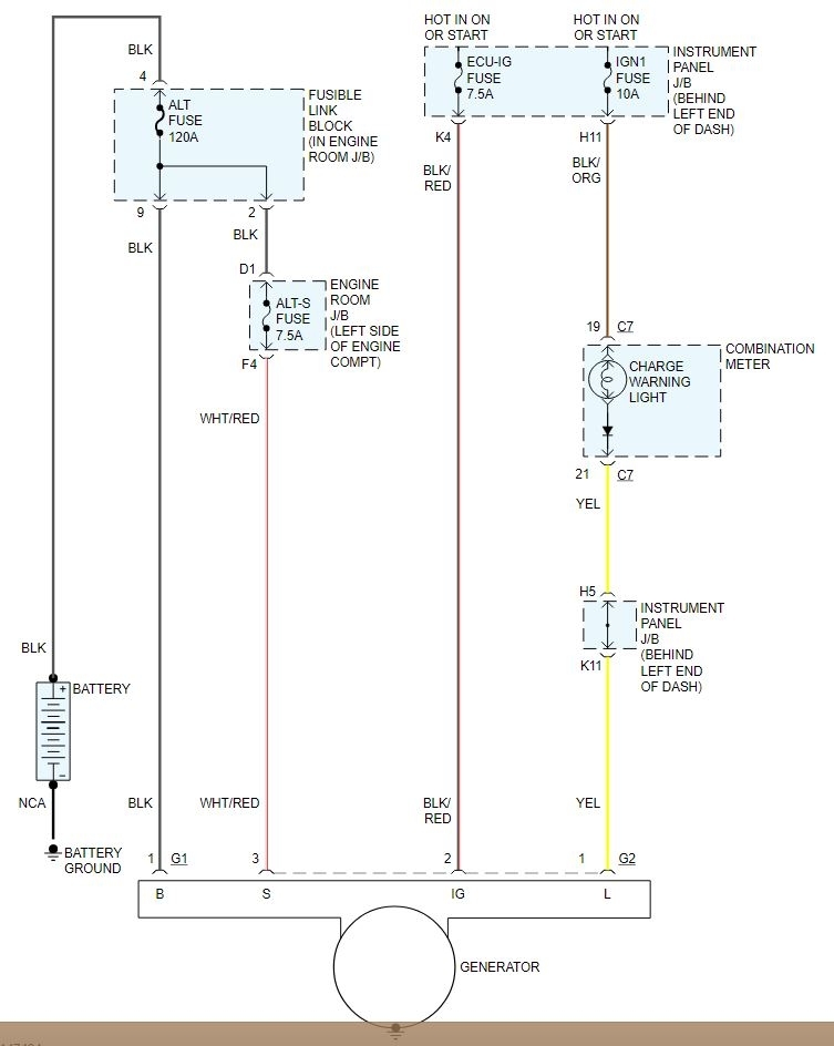

Welcome to 2CarPros. From your description I would say the problem is that you need to replace the battery hold down and the battery. The hold downs will keep the battery from moving which can easily damage the cables and the battery connections if they get twisted or moved inside the battery. The battery should be replaced as it may have bad internal connections at the terminals because of it moving around and because it has shown signs of internal failure (IE it works sometimes but then doesn't and the engine running off the jump pack but not when it is disconnected). Now those same issues could simply be that the terminals on the ends of the cables are bad and making and breaking contact in the same way. The way to test which is the problem would be to start the engine and then move the cables around while watching the battery terminals. If the terminals themselves move in the battery then it is in the battery. If the terminals don't move but moving the cables around causes it to sputter or shut off then it's likely the cables. This situation would need to be tested and repaired before you can test the alternator charging output however it also sounds like the alternator has failed as it should stay running even with the momentary battery voltage interruptions.
I attached the charging system schematic. I would check all the fuses as well. It's possible the battery moved enough that it shorted and blew the main fuse and that caused the light to come on.
