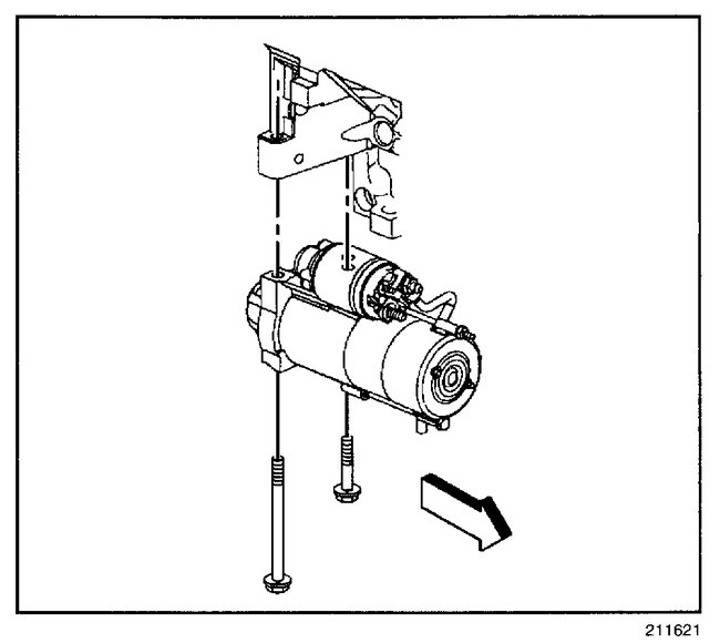

If my truck sits for a couple of hours when I go to start it, it starts but acts like it's missing or starving for fuel. I will let it sit for a couple of minutes and it starts. Also it just started once I put it in drive and pull out it cuts out a little bit like it's going to shut off then straightens up.

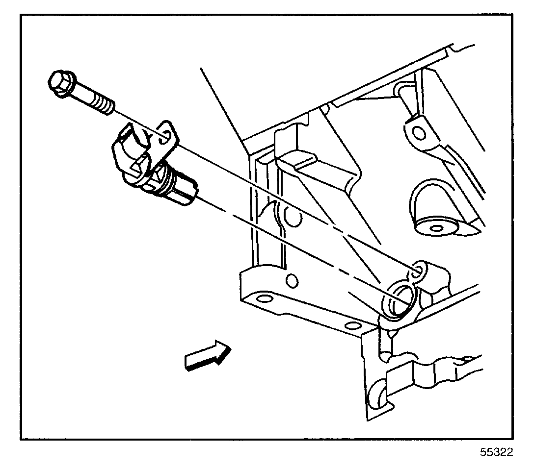

Okay, now the thing that I feel is most likely an issue is the crankshaft position sensor. Often times they will fail sporadically. Read through this link and let me know if it seems to mirror the symptoms you have.
If you feel the sensor is the issue, here is a link that shows how, in general, one is replaced.

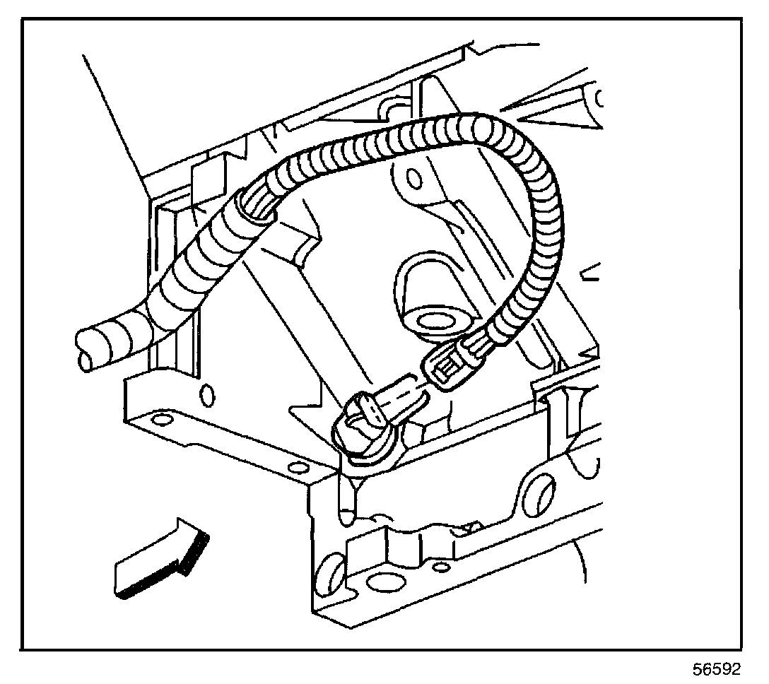

Here are the directions specific to your vehicle. The attached pictures correlate with these directions.

3. Remove the starter.
4. Disconnect the crankshaft position (CKP) sensor electrical connector.
5. Clean the area around the CKP sensor before removal in order to avoid debris from entering the engine.
6. Remove the CKP sensor retaining bolt.
7. Remove the CKP sensor.
INSTALLATION PROCEDURE
Crankshaft Position Sensor (CKP)
1. Install the CKP sensor.
NOTE: Refer to Fastener Notice in Service Precautions.
2. Install the CKP sensor retaining fastener.
Tighten
Tighten the bolt to 25 N.m (18 lb ft).
3. Connect the CKP sensor electrical connector.
4. Install the starter.
