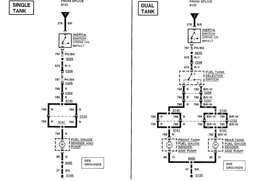

Was driving and truck shut off. Restarted after couple minutes. Few days later it shut off again. Has not started since. Have replaced coil, ignition mod, EEC mod, rotor, cap and even distributor. Still nothing. Help

Have you checked for fuel pressure? There is an access port on the fuel rail to test the pressure. If you do not have a tester, you can rent one at a parts store.

Pushed the value in and there is fuel pressure. Should I get a tester still?
Sunday, March 11th, 2018 AT 1:03 PM
That means the pump is not working. You need to test for power to the pump.
Diagram attached. Check for power to the inertia switch first.
Sunday, March 11th, 2018 AT 1:08 PM

Okay, but you can hear the pump when you turn the key on.
Sunday, March 11th, 2018 AT 1:20 PM
Okay, good. Glad you told me that.
Then the pump has failed. It can run and produce no pressure. I would replace the pump and filter and then be sure you have fuel in the rail.
