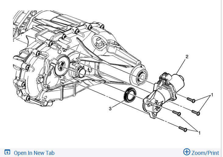

Have a rebuilt transmission, changed transfer case, rear end, drive shaft. Truck still won't move. Think transfer case may be stuck in neutral. Is there a way to manually shift transfer case out of neutral? Or what could be other things wrong with it? 2007 Chevy Silverado 1500 4wd 5.3l.

Yes, the transfer case can be stuck in neutral, can I ask if the transmission grinds when you put it in park? This would be a sign something is broken or in neutral after the transmission. Do you have any codes? I would run the PCM to see if any are stored, here is a guide to help
To manually shift the transfer case you will need to remove the encoder, (shift motor) here is the location. Also, if you leave the wiring on the encoder you can work the controls to see if it moves. Check out the images (below). Please let us know what happens.

Yes it grinds when putting in park. I will check the encoder motor like u said.

The encoder motor works. We put transfer case back in and hooked everything up. Still no movement. If it is the wrong transfer case, will this happen? Or do I have to relearn it to the truck?

You should not have to relearn anything for the tuck to move. Something must be broken inside the transfer case. On level ground, I would lift the rear end up and while in park try to rotate the rear driveshaft, it should not turn and if it does the transfer case will need to come out and be rebuilt.
