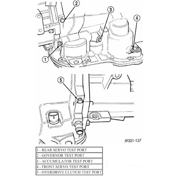

There is no electronics to control going into gear. That is mechanical.
The main line pressures need to be checked to confirm there is sufficient pressure to apply the clutches. I attached a flow chart for this process.
Hydraulic test pressures range from a low of one psi (6.895 kPa) governor pressure, to 300 psi (2068 kPa) at the rear servo pressure port in reverse.
An accurate tachometer and pressure test gauges are required. Test Gauge C-3292 has a 100 psi range and is used at the accumulator, governor, and front servo ports. Test Gauge C-3293-SP has a 300 psi range and is used at the rear servo and overdrive ports where pressures exceed 100 psi.
Pressure Test Port Locations
Test ports are located at both sides of the transmission case.
Line pressure is checked at the accumulator port on the right side of the case. The front servo pressure port is at the right side of the case just behind the filler tube opening.
The rear servo and governor pressure ports are at the right rear of the transmission case. The overdrive clutch pressure port is at the left rear of the case.

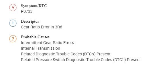

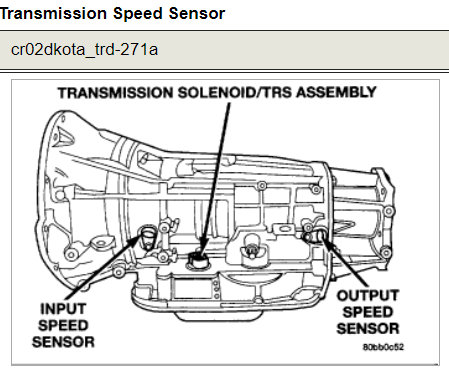

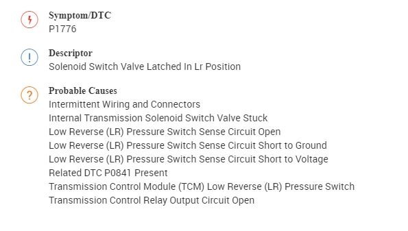

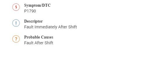

Truck will not shift past second. Truck shifts into second then rpm's increase and then acts as if shifts into neutral. Truck will drive in second gear manually, but not in overdrive no second to third or third to fourth shift. Codes pulled from scanner are :
P0700 standard transmission prob code.
P1776 solenoid switch valve latched in L/R position. Low/reverse.
P1790 fault immediately after shift.
P0733 third gear incorrect ratio, P0734 fourth gear incorrect ratio.

This sounds like your input shaft speed sensor for the transmission is not working right. Here is the location please let me know what happens:
Cheers

Good evening,
The last 2 codes are the key. Incorrect gear ratios are the signs of a slipping clutches in the transmission. That means the internals are worn out and the transmission needs to be replaced.
The 700 is an information code.
I attached the other codes below.
