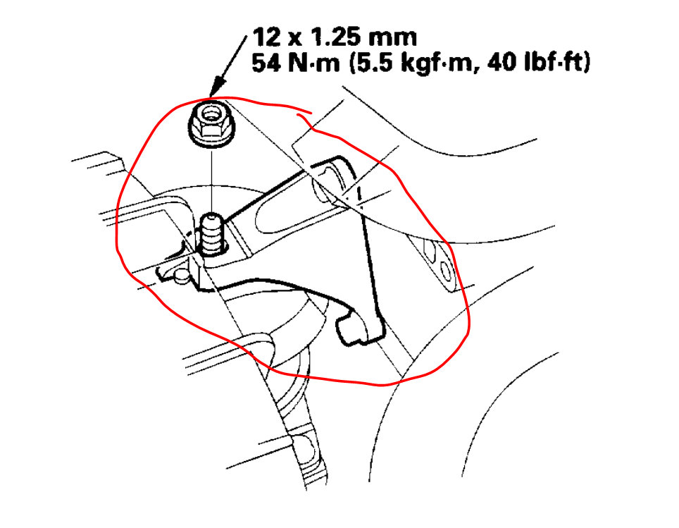

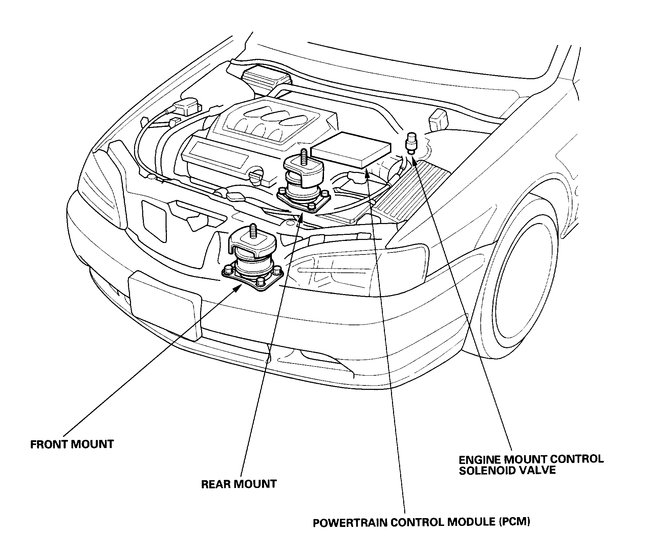

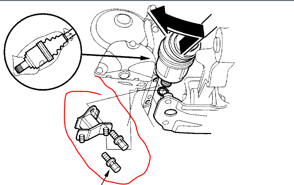

When i shift the car from park to reverse, drive, or anything even neutral i get a loud thunk noise as it goes into gear. it even does it shifting from a gear back to park. I also slightly feel it when driving as it goes into various gears. Could it be transmission or engine mounts?

Hi. No it doesn't make a noise when i turn, the noise sounds and feels like it is maybe a torque converter, or something associated with the transmission. it's like after i shift from Park to whatever gear a second later i feel and hear a loud thud as it goes into the gear. it stops but when i first push the gas and start driving it shuts off it briefly before car moves? It's freaking me out. There is no slipping of gears, just feels like it shifts hard.

Okay, then I would suggest checking both transmission mounts and the engine mounts.
Try this: Get a helper. Start the engine and open the hood. Place the engine in drive and with your foot firmly on the brake and the parking brake engaged, gently press on the throttle. Do the same in reverse. While you do this, have your helper check to see if there is excessive up and down movement from the engine.
As far as the transmission, check the forward mount for condition. Check the lower rear mount (pic 1) and front mount (pic 2). Pic 3 shows where the motor mounts are located. Check them as well.
