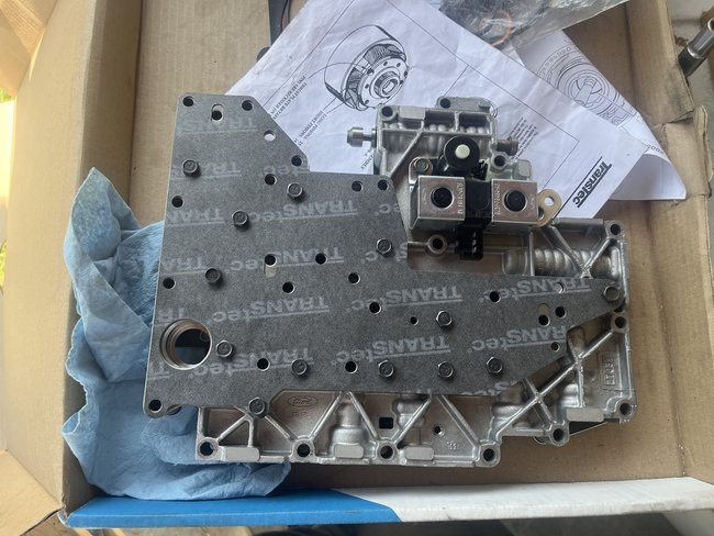

I was looking at the pics trying to figure out the torque sequence for the valve body bolts but the one you posted has bolts in a different spot than this one.
Wednesday, July 13th, 2022 AT 11:07 AM
ARIANADANIELLE5345
  • 393 POSTS
And yes, I know the gasket doesn’t go there. Lol It was the only way the bolts would show up really well in the picture.
Wednesday, July 13th, 2022 AT 11:22 AM
SQM
  • 6,383 POSTS

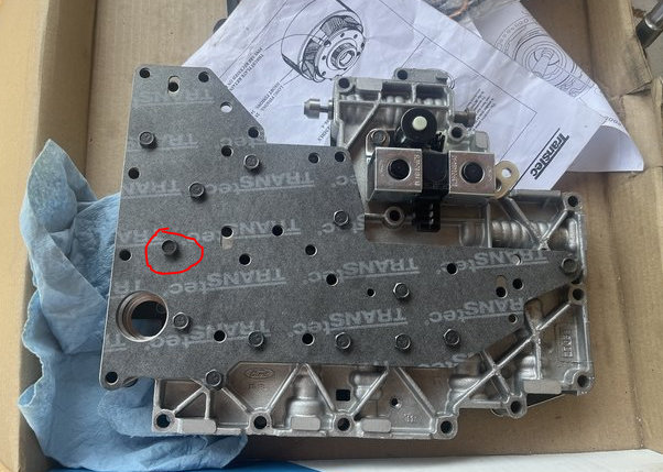

They might look a little different but still have the same number of bolts. See the image below, use the one I circled as the number one bolt.
