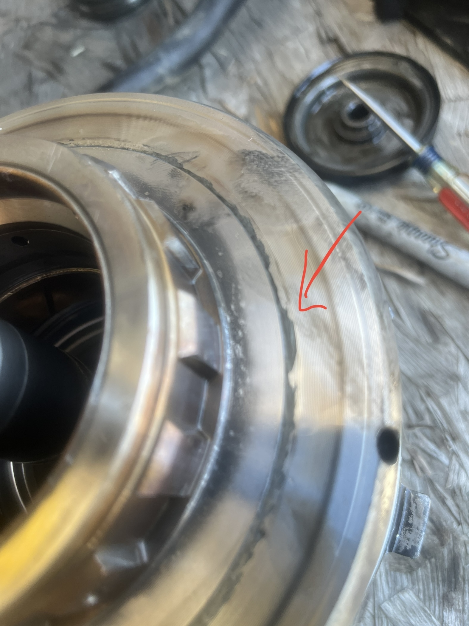

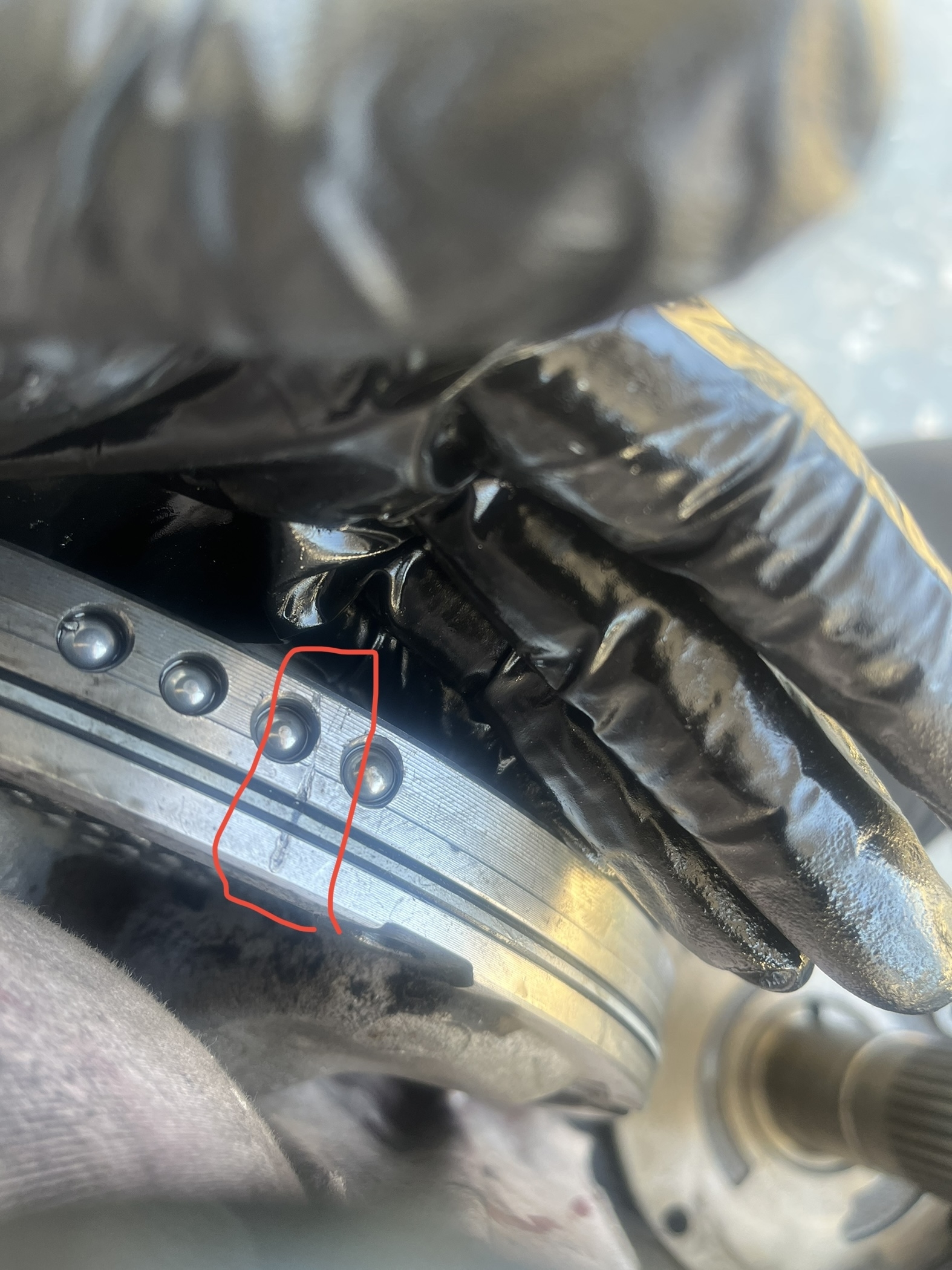

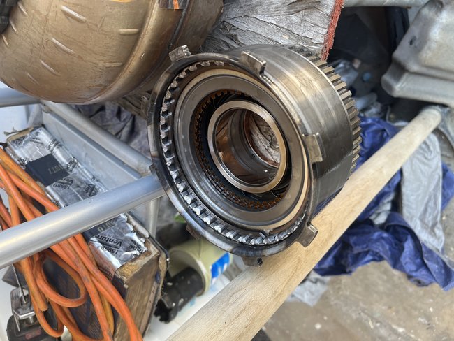

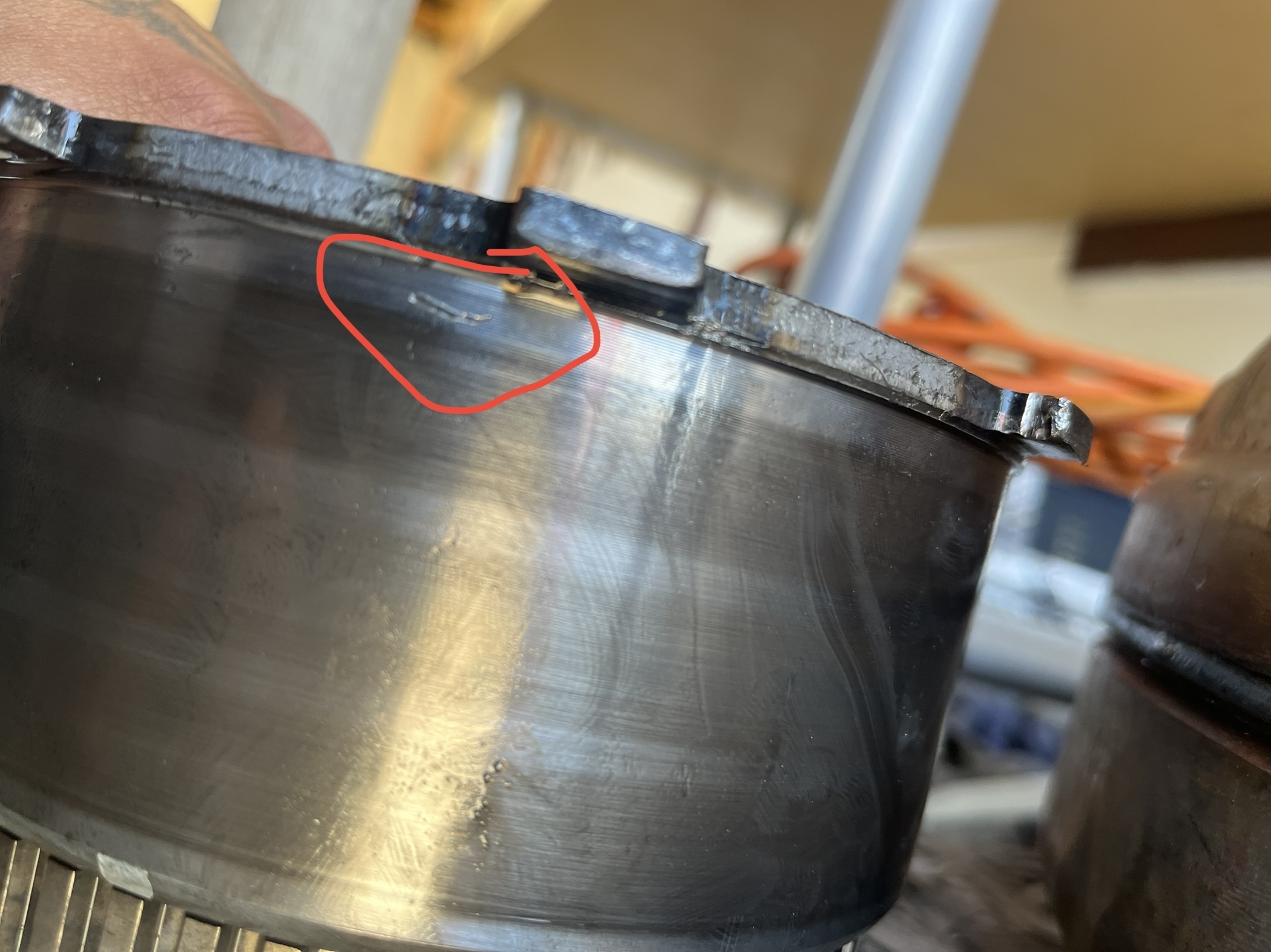

And this. There was a tiny piece of metal stuck where that gouge is.
Saturday, June 18th, 2022 AT 11:11 AM
ARIANADANIELLE5345
  • 393 POSTS
My fingernail catches in those circle scratches.
Saturday, June 18th, 2022 AT 11:14 AM

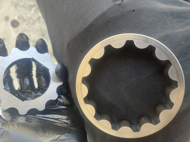

ARIANADANIELLE5345
  • 393 POSTS
There are a couple of these around this part.
Saturday, June 18th, 2022 AT 12:38 PM
ARIANADANIELLE5345
  • 393 POSTS
Maybe this is the issue.
Saturday, June 18th, 2022 AT 12:51 PM
SQM
  • 6,383 POSTS
Well, for the most part these components have typical wear due to mileage, not really jumps out of being 'the' issue. The last picture could be the cause of concern.
Saturday, June 18th, 2022 AT 7:14 PM
ARIANADANIELLE5345
  • 393 POSTS
So just a complete rebuild?
Saturday, June 18th, 2022 AT 7:44 PM
SQM
  • 6,383 POSTS
That is probably your best option. That way you know you covered all typical worn items.
Saturday, June 18th, 2022 AT 8:01 PM

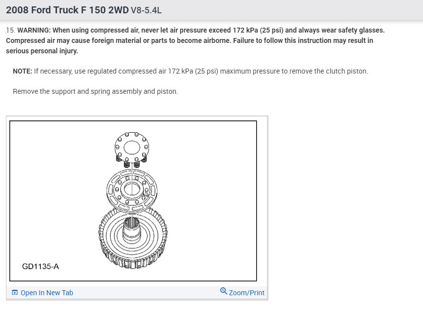

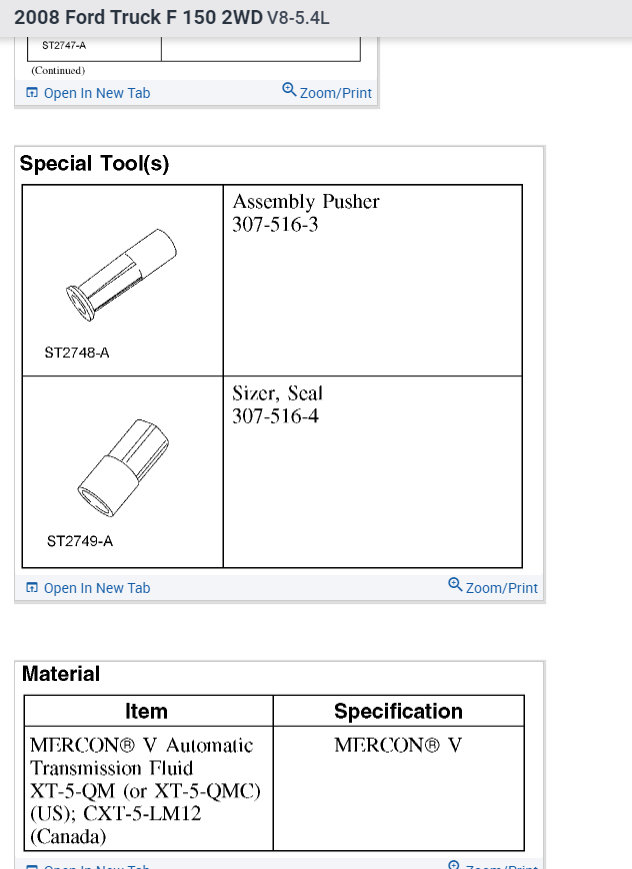

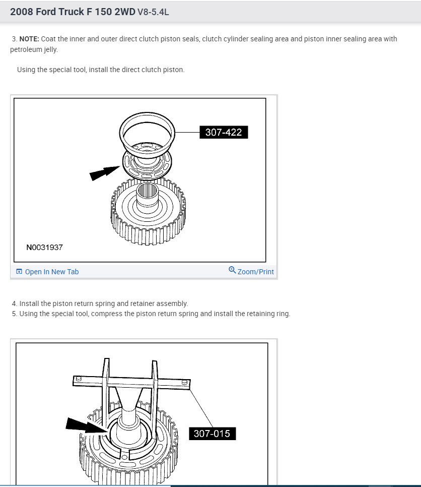

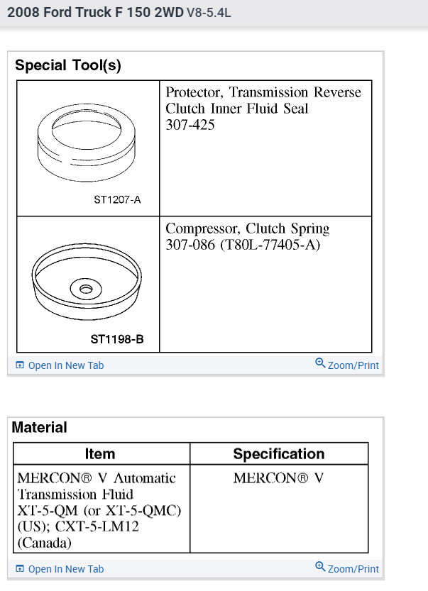

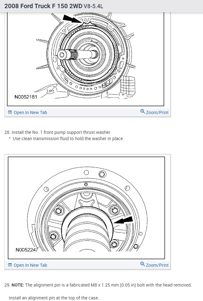

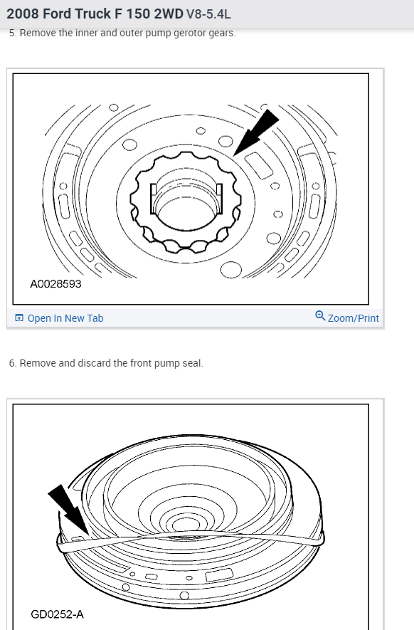

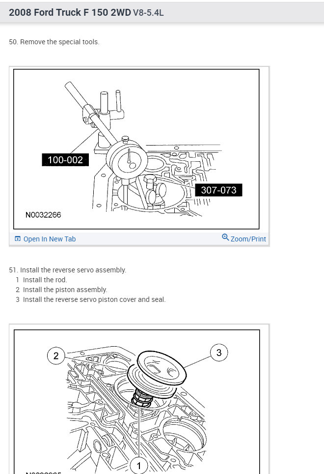

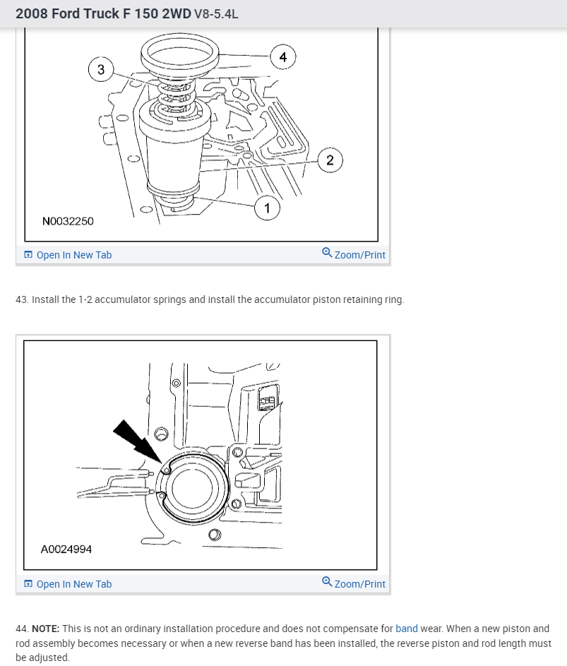

ARIANADANIELLE5345
  • 393 POSTS

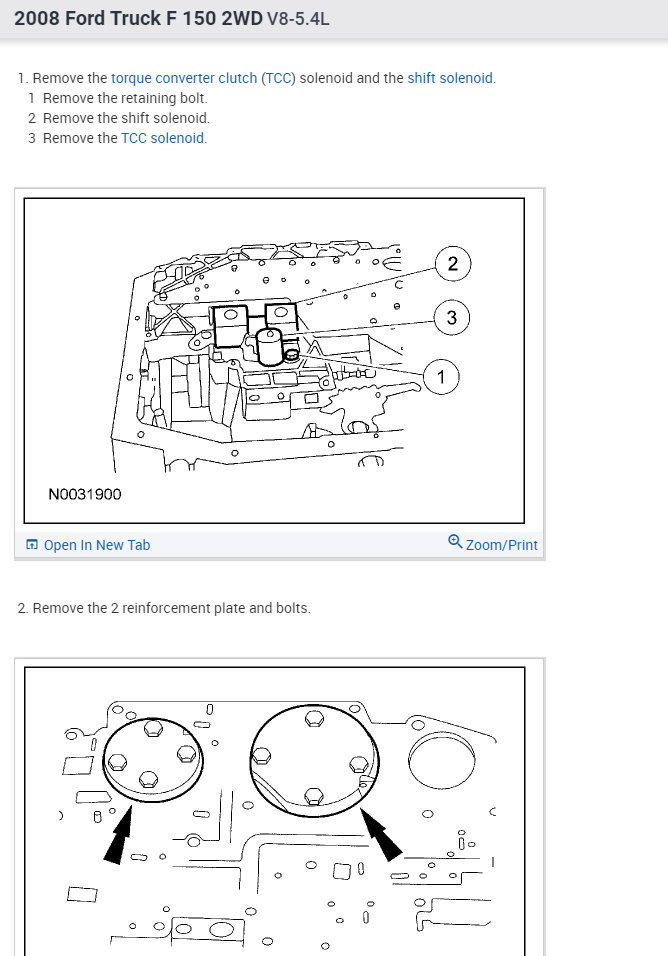

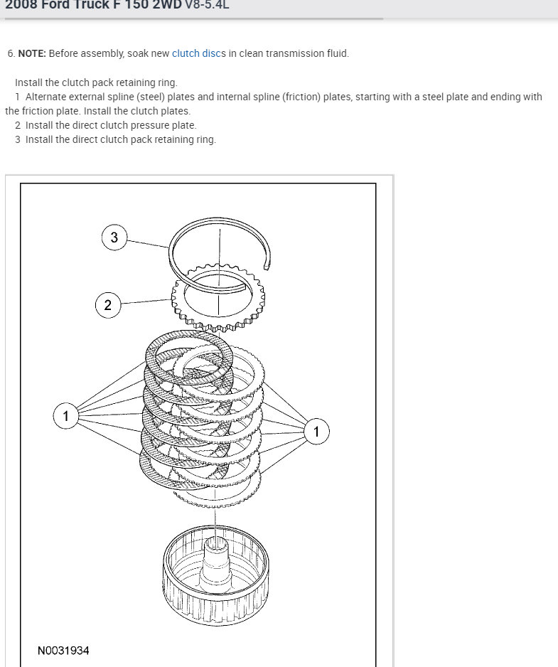

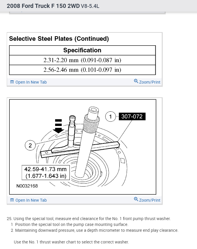

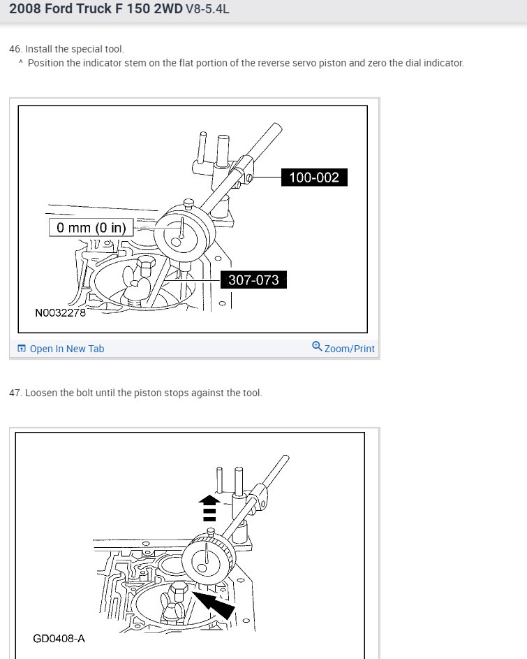

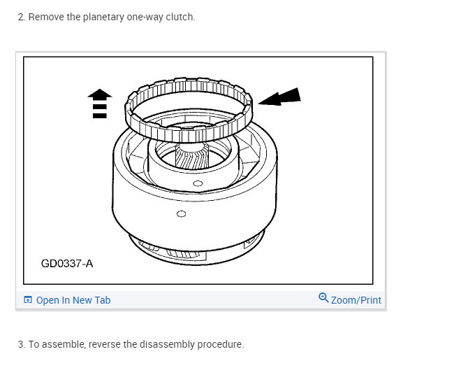

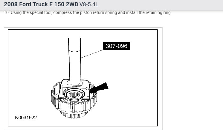

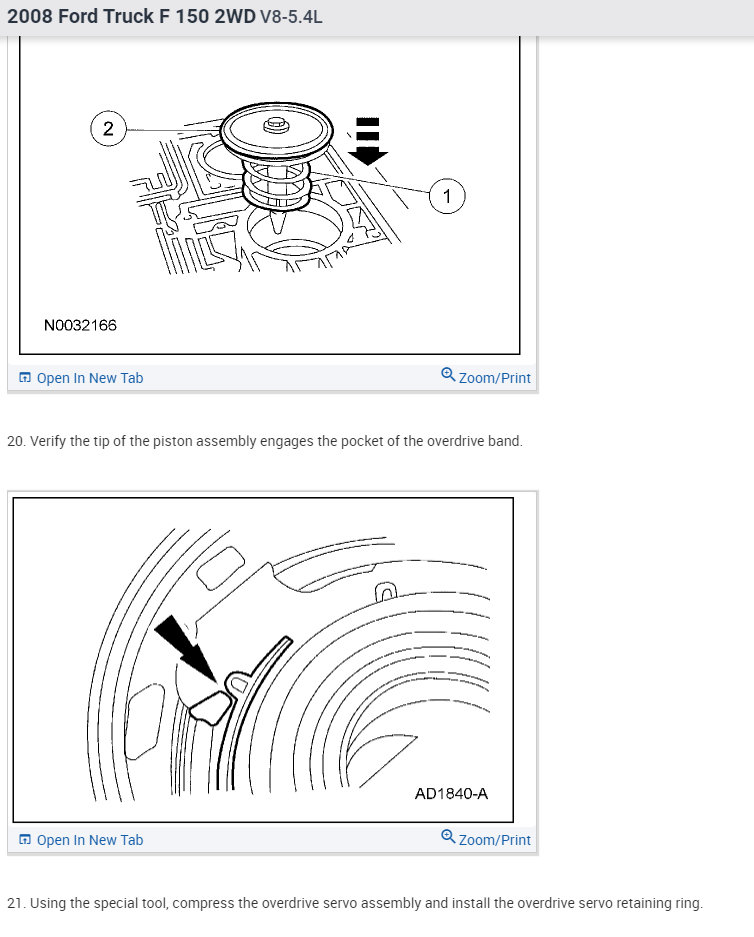

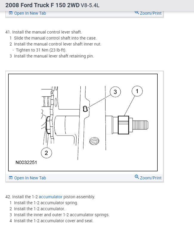

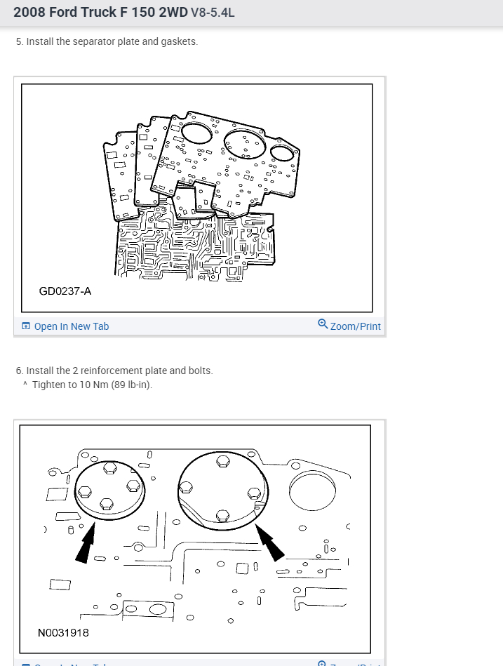

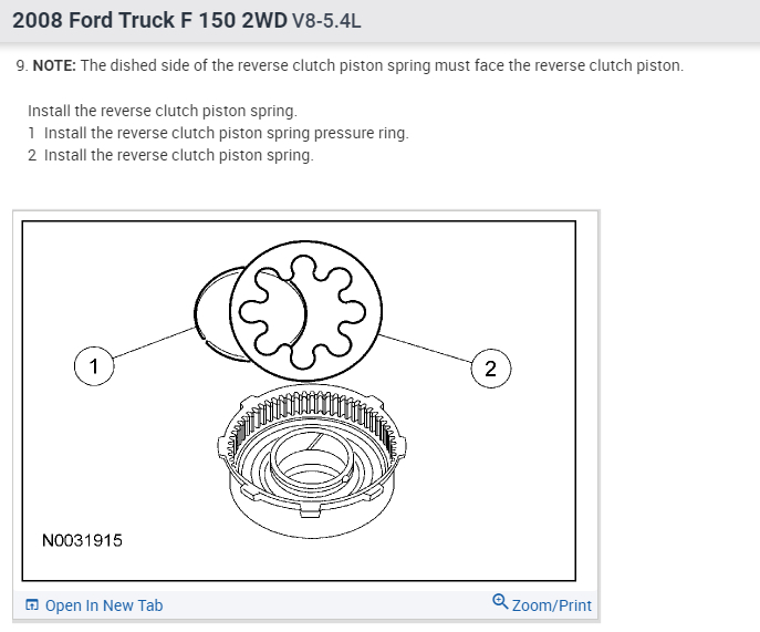

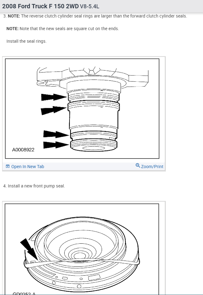

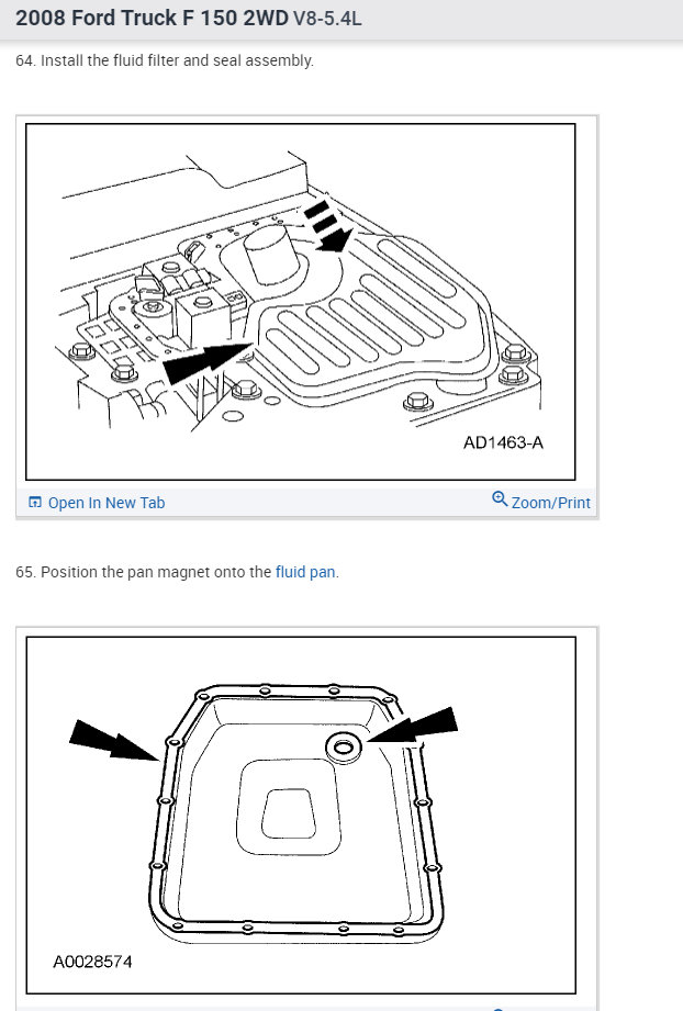

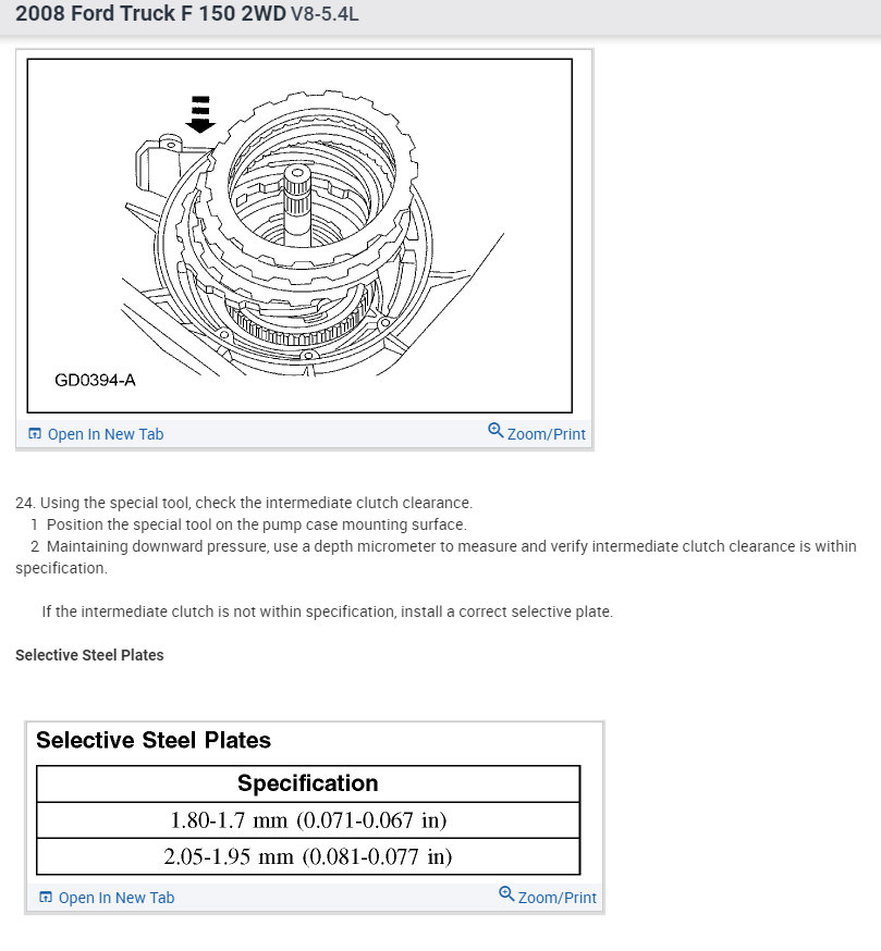

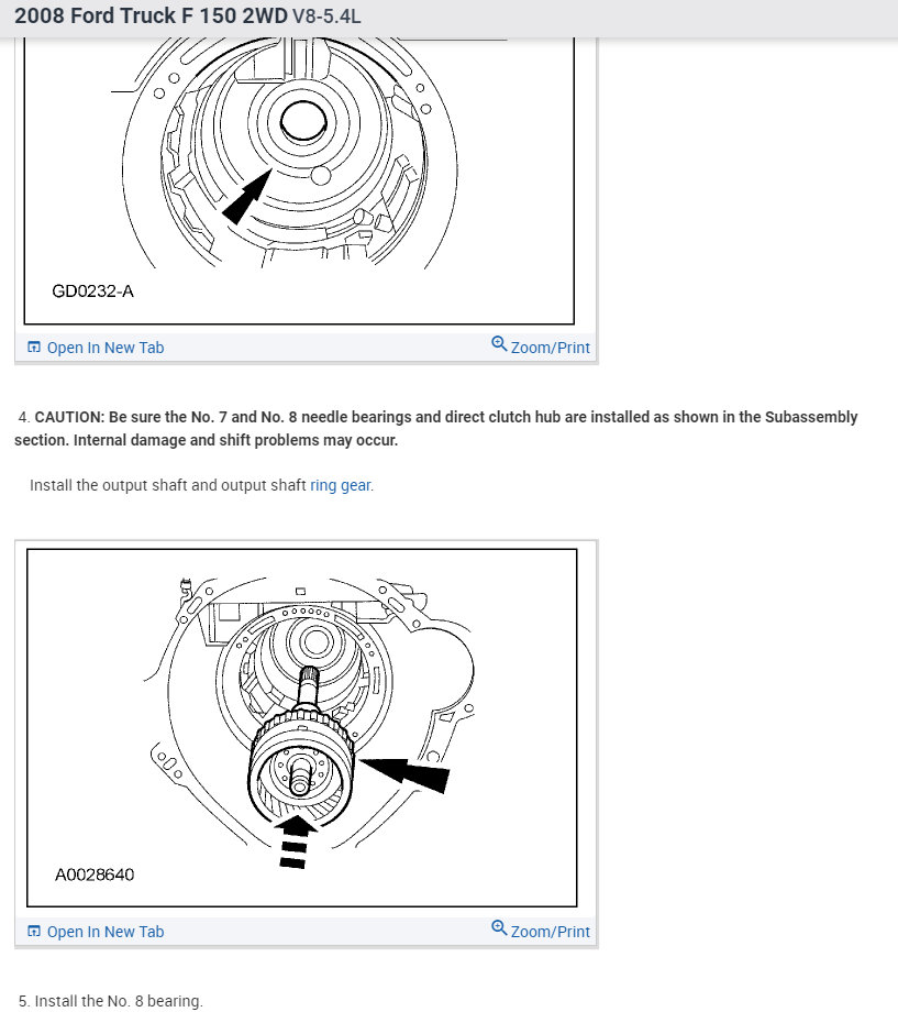

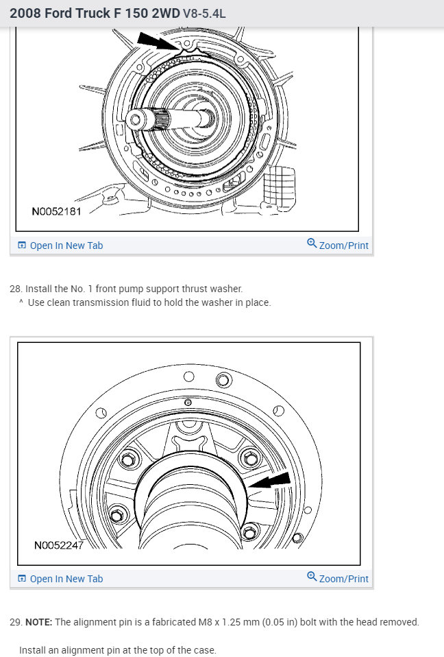

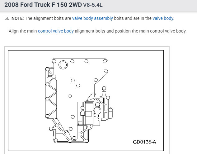

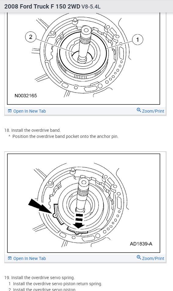

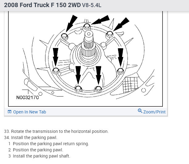

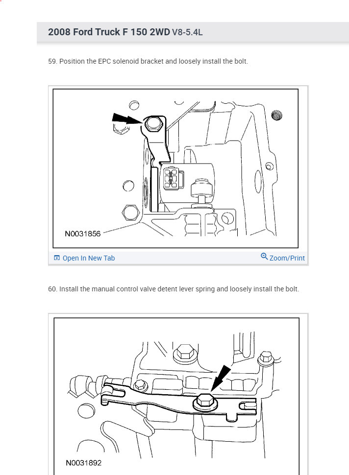

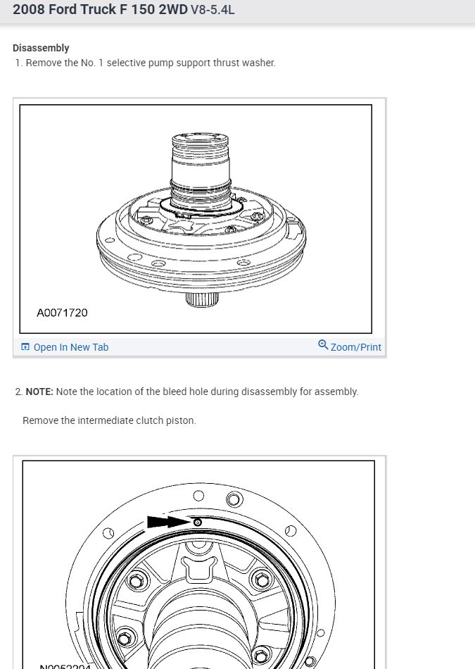

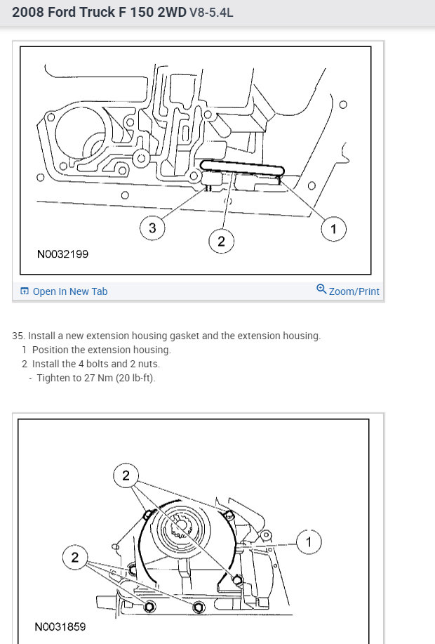

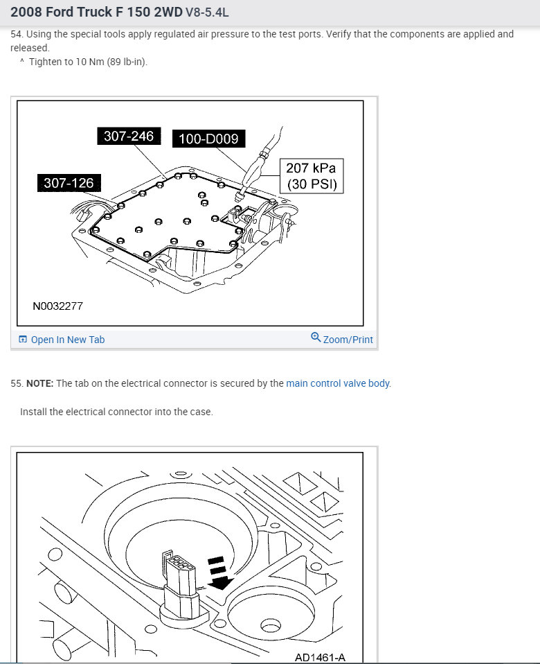

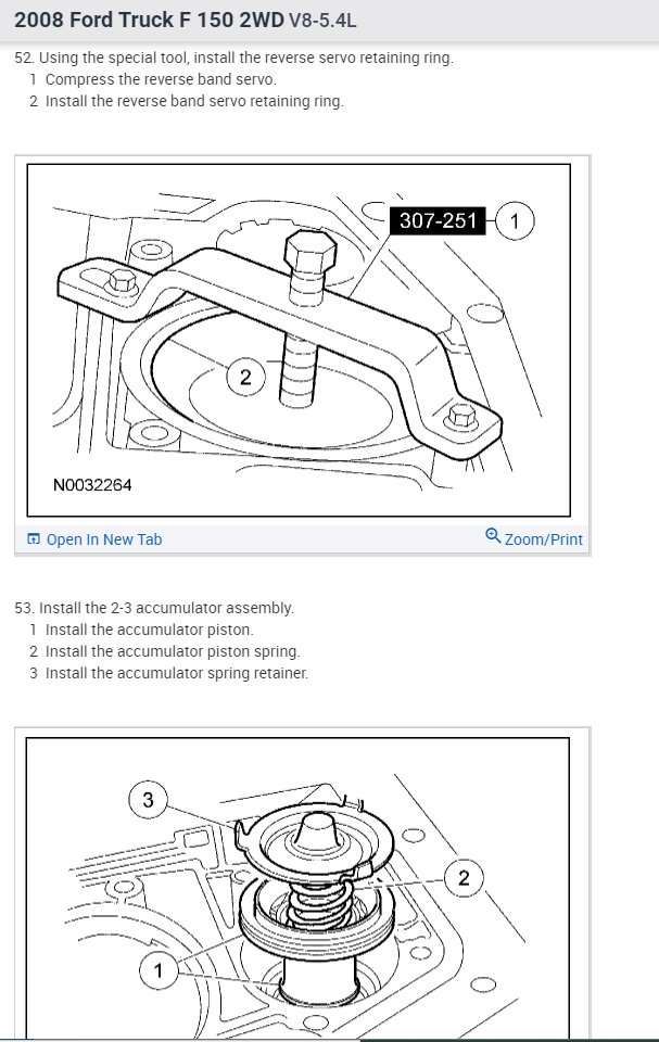

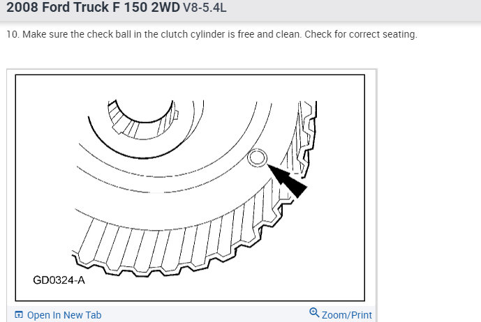

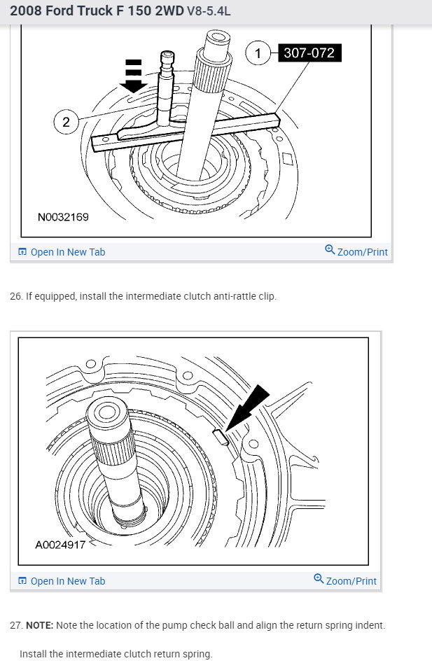

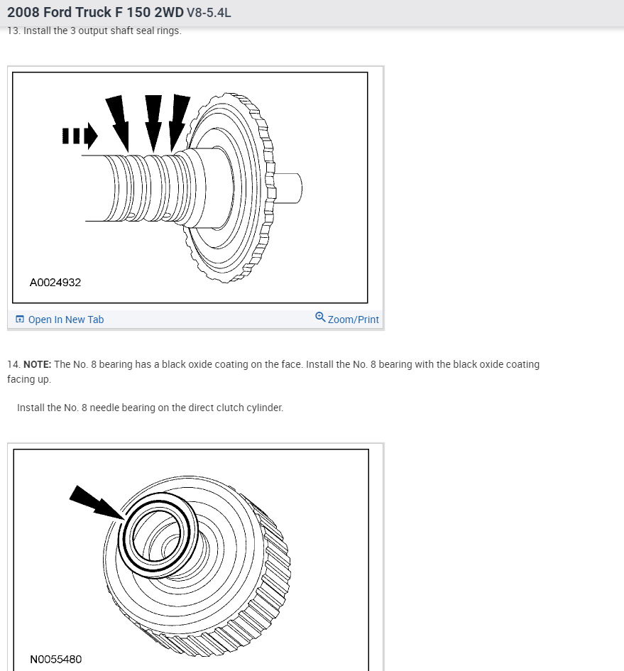

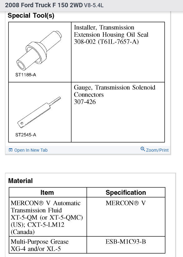

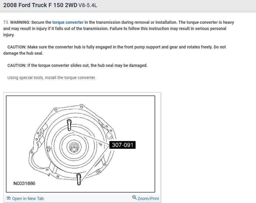

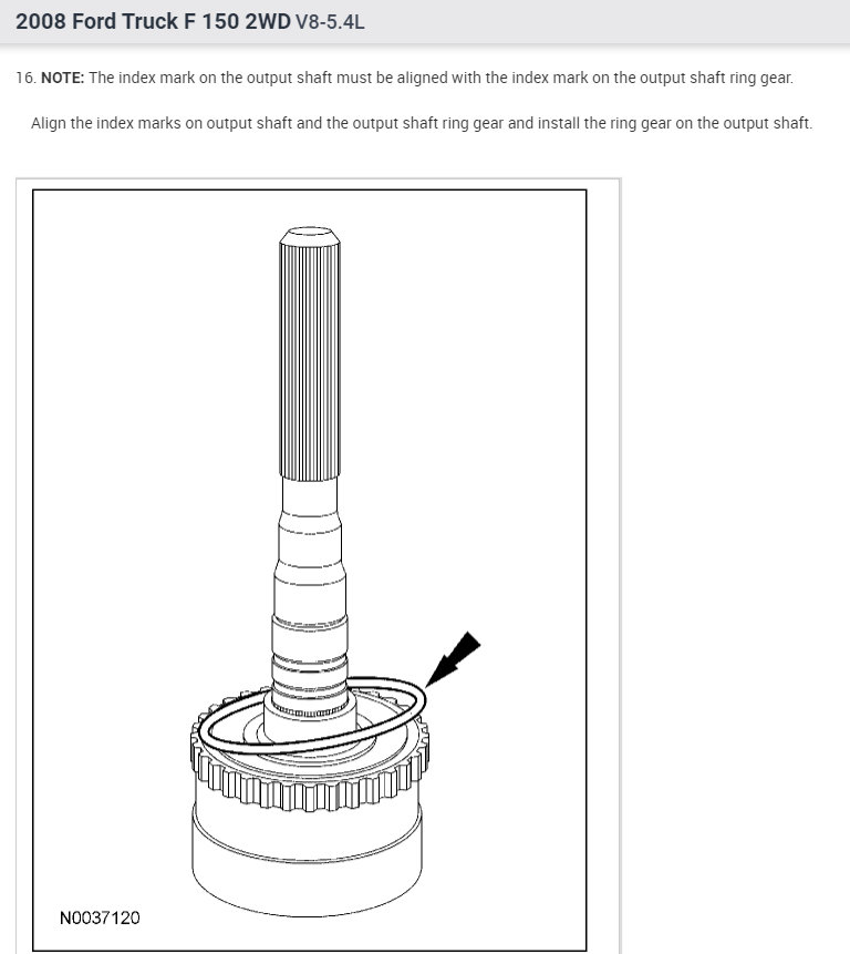

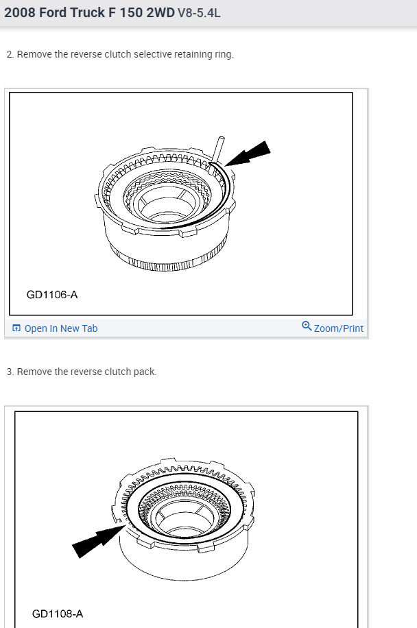

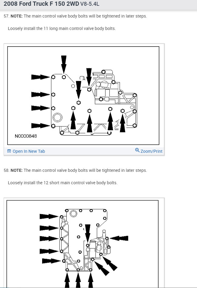

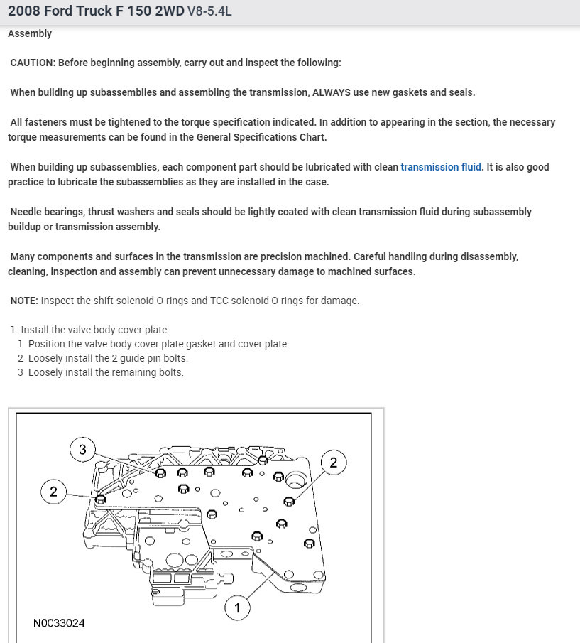

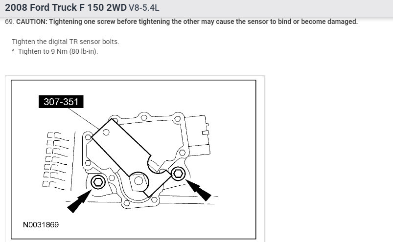

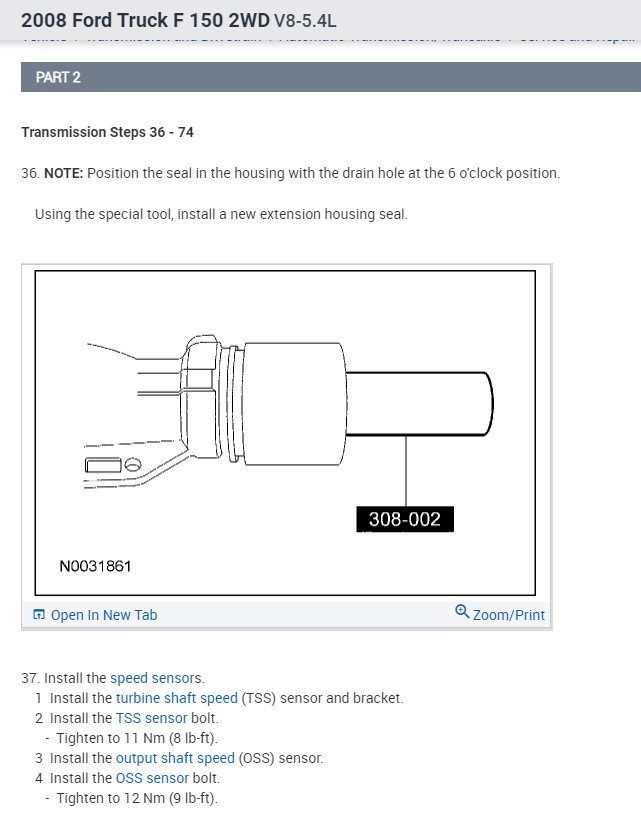

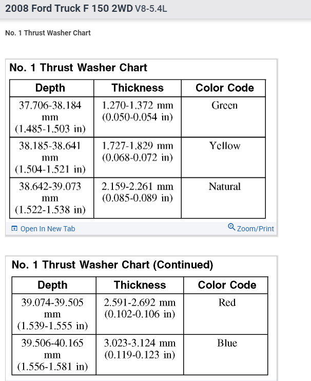

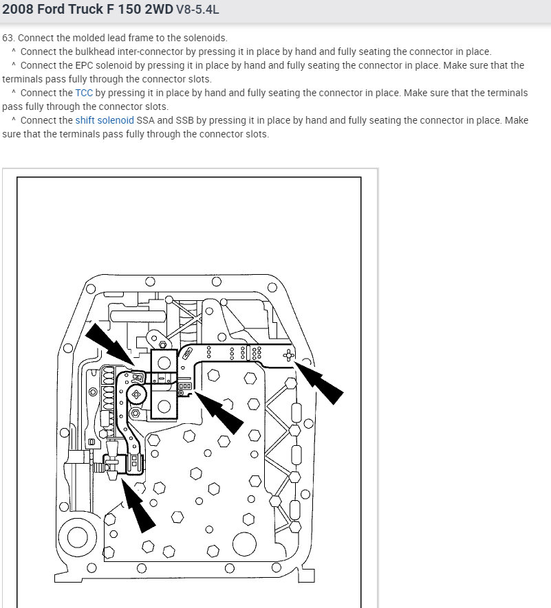

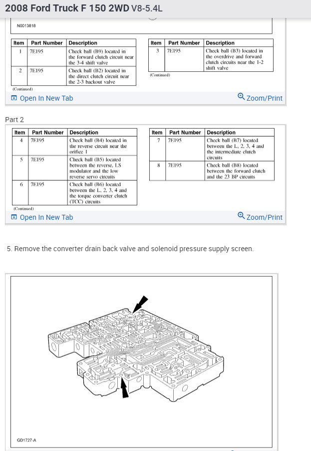

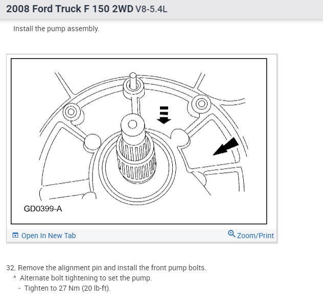

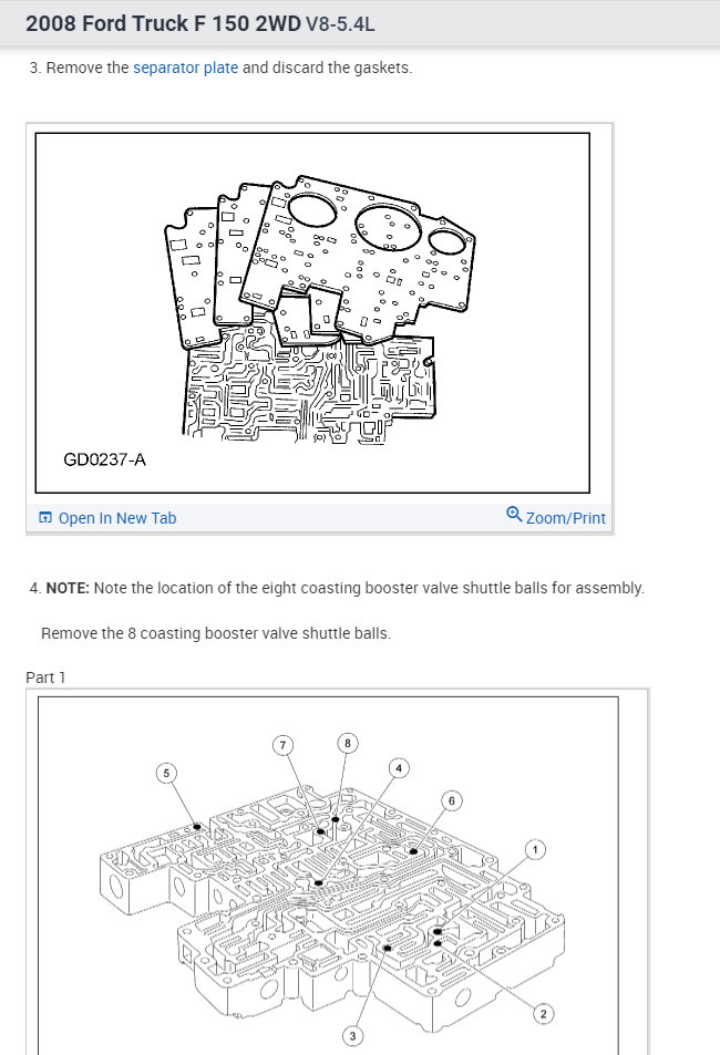

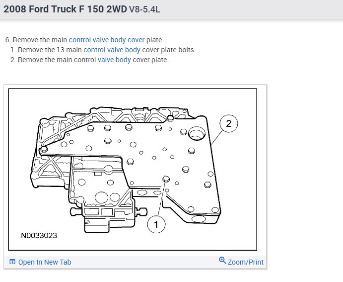

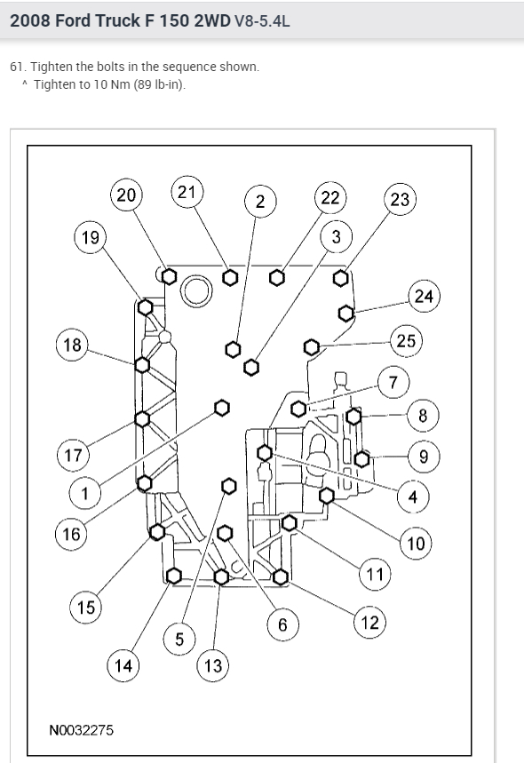

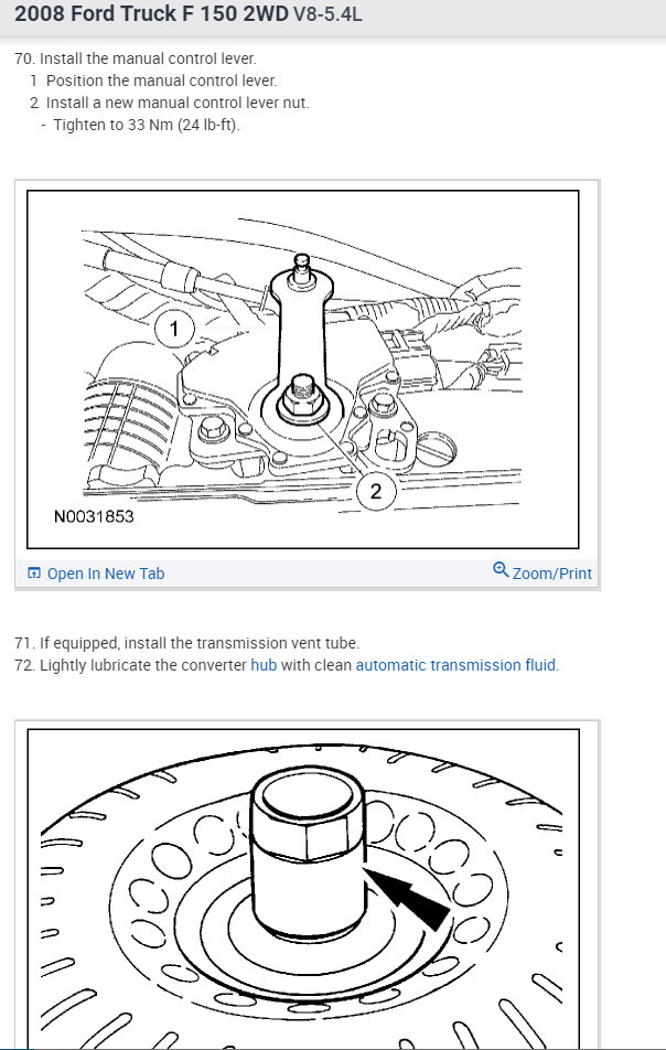

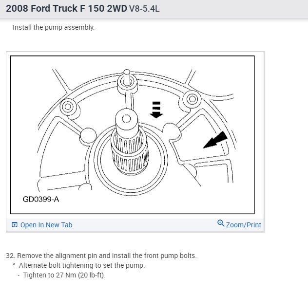

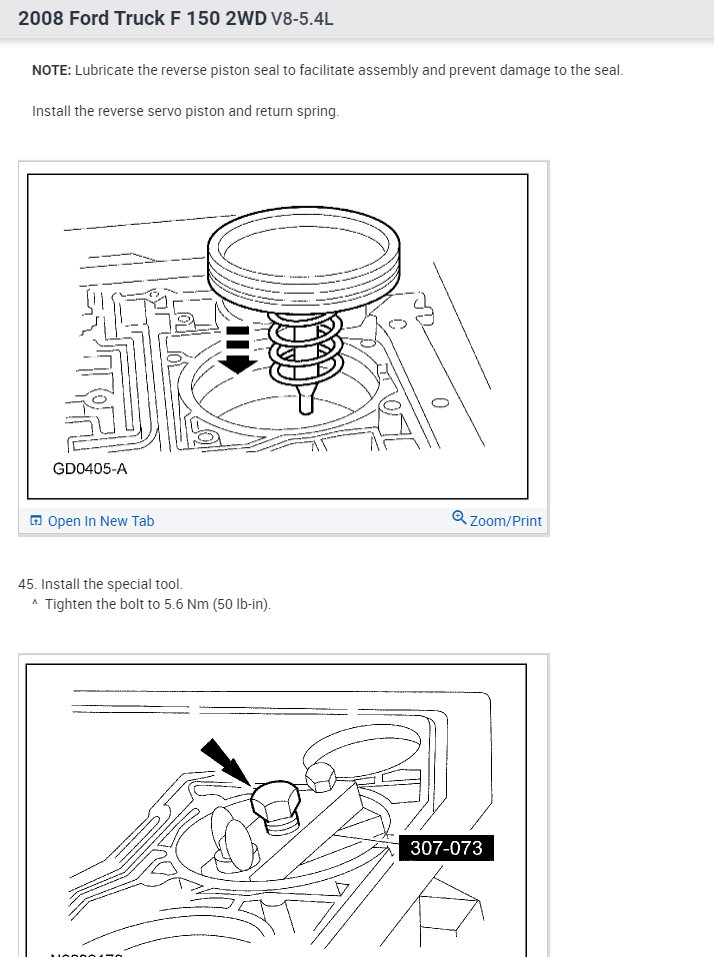

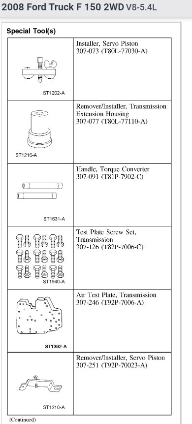

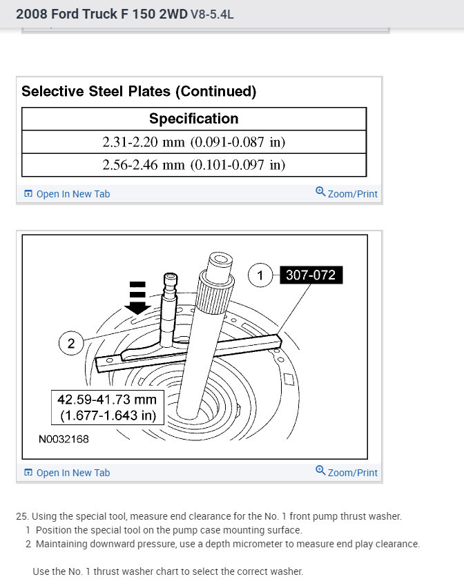

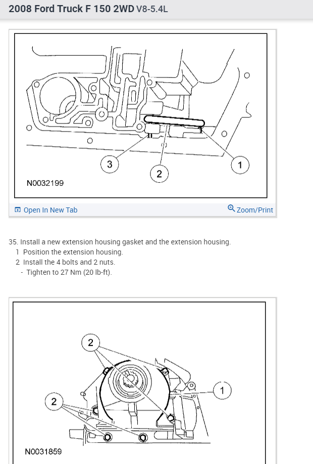

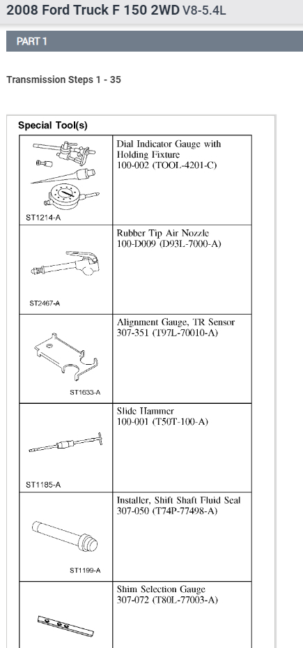

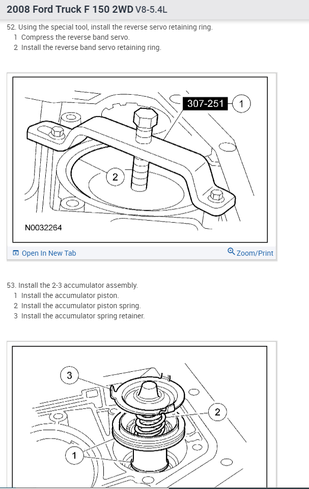

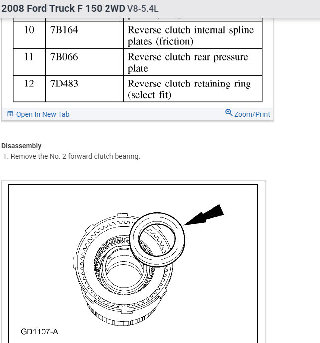

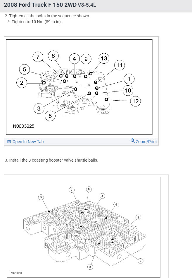

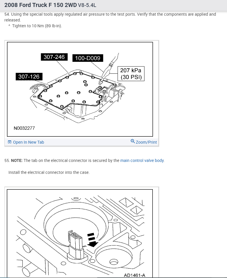

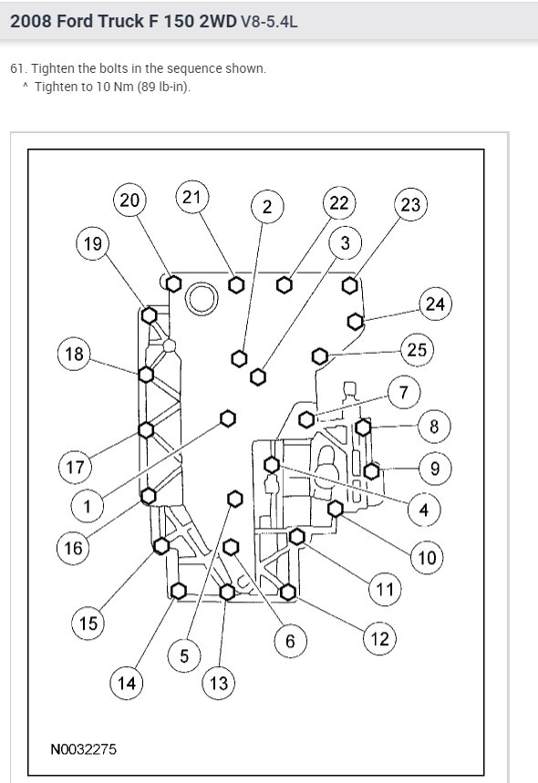

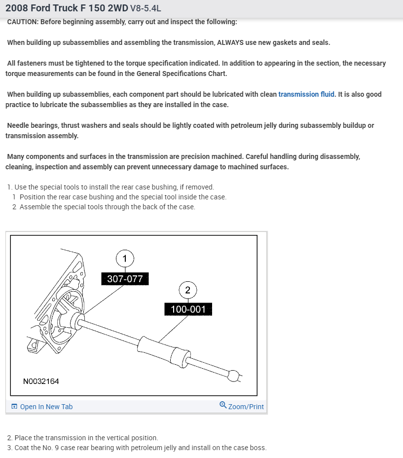

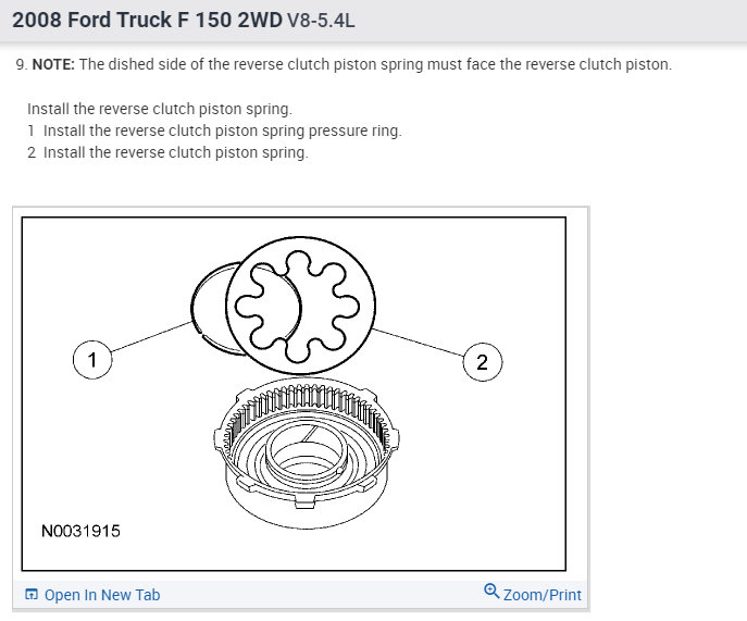

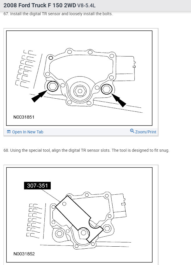

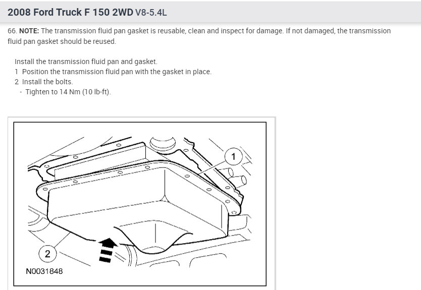

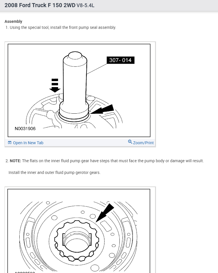

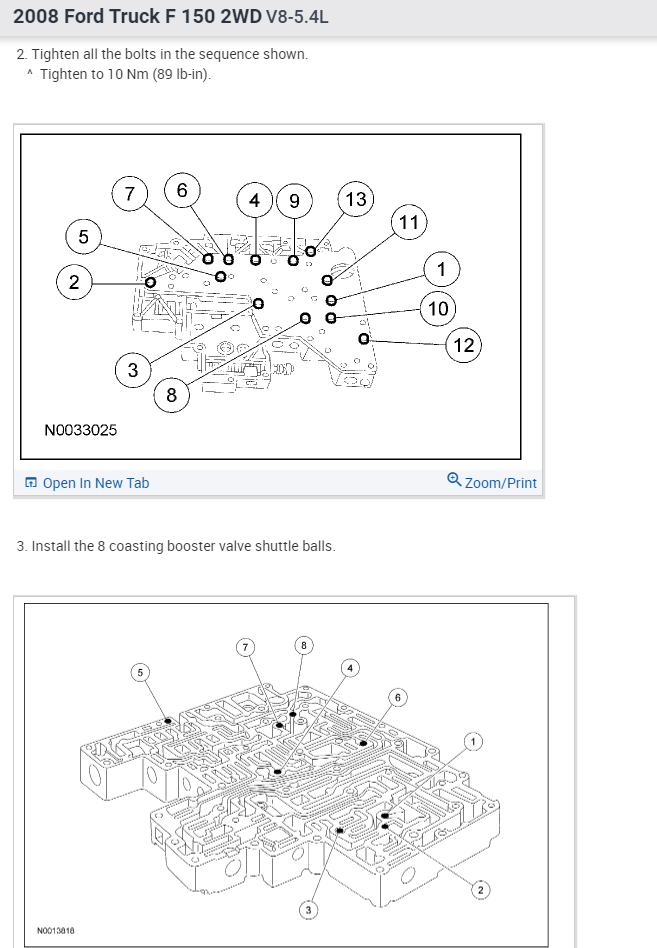

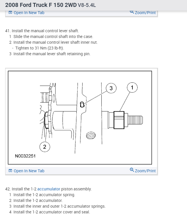

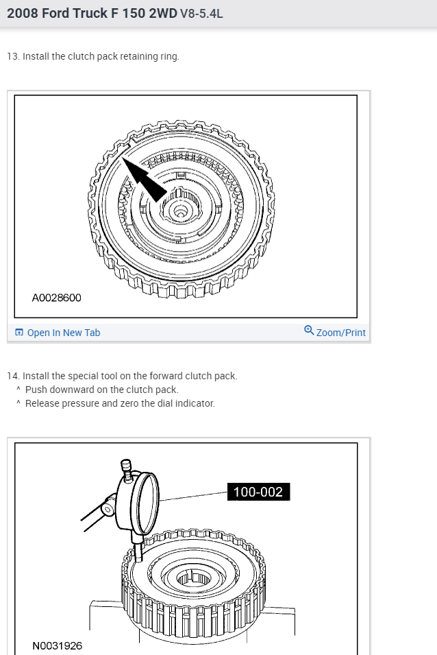

I'm assuming the assembly is the reverse of disassembly instructions from above, but do you have instructions with torque specs for the valve body bolts?
Friday, June 24th, 2022 AT 11:49 AM
SQM
  • 6,383 POSTS

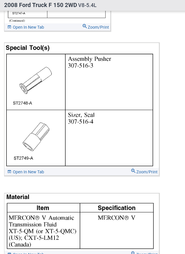

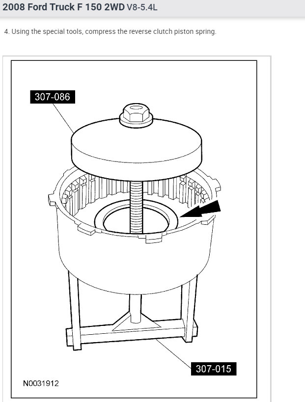

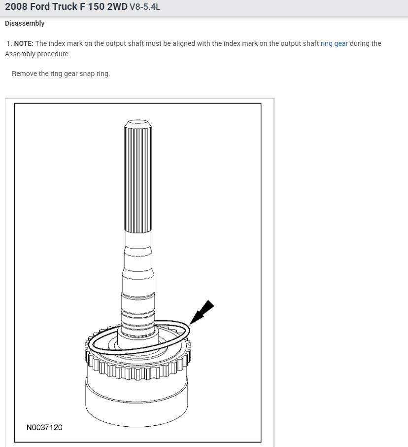

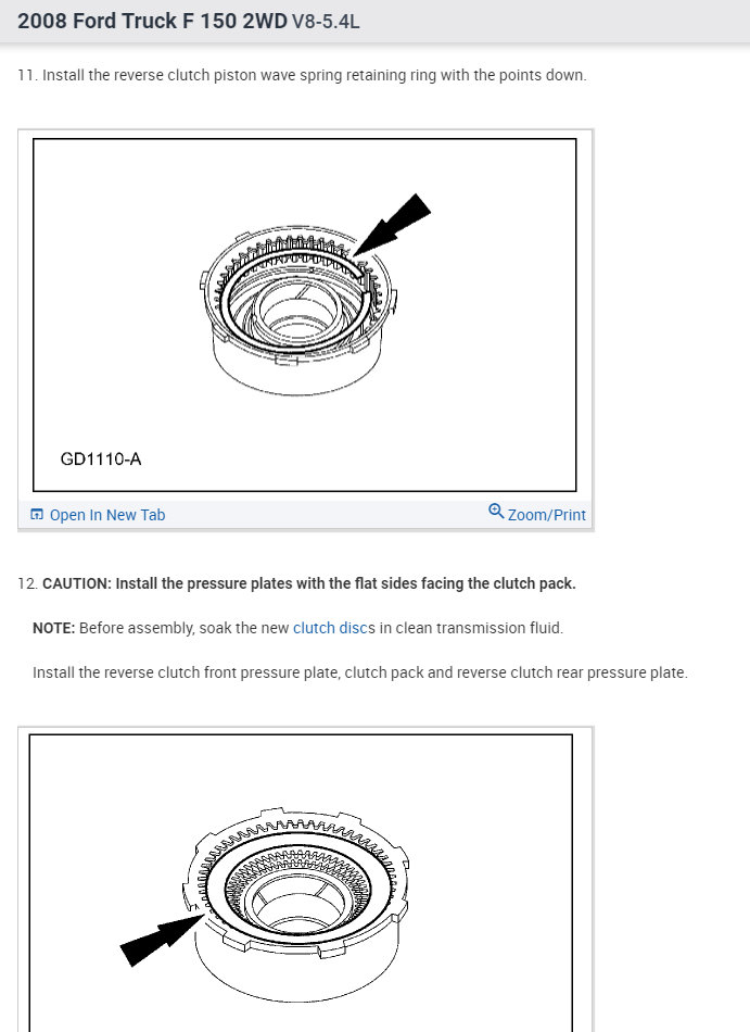

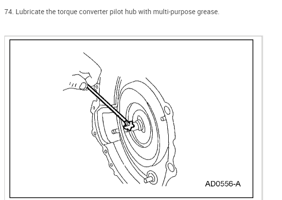

See attached for the transmission reassembly procedure as well as the valve body instructions. You will find all the torque specifications as well as the very important torque sequence.
Friday, June 24th, 2022 AT 1:43 PM

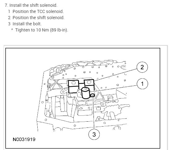

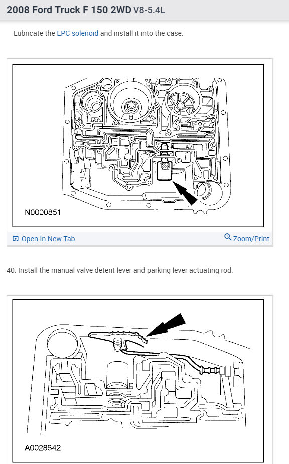

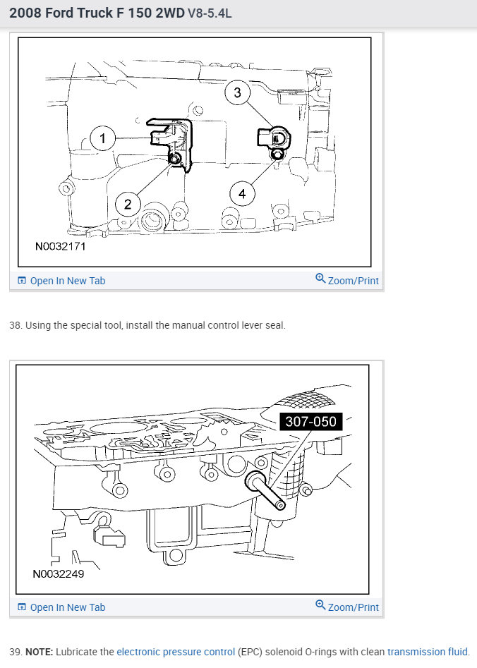

Is it necessary to replace the solenoids during a rebuild?
Tuesday, June 28th, 2022 AT 9:58 PM
SQM
  • 6,383 POSTS
Only if it is a concern (typically shifting issues). Might be a good idea if many other components are getting replaced.
Tuesday, June 28th, 2022 AT 10:47 PM

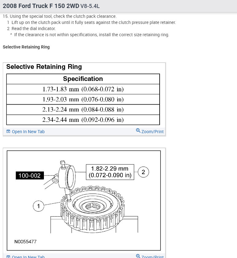

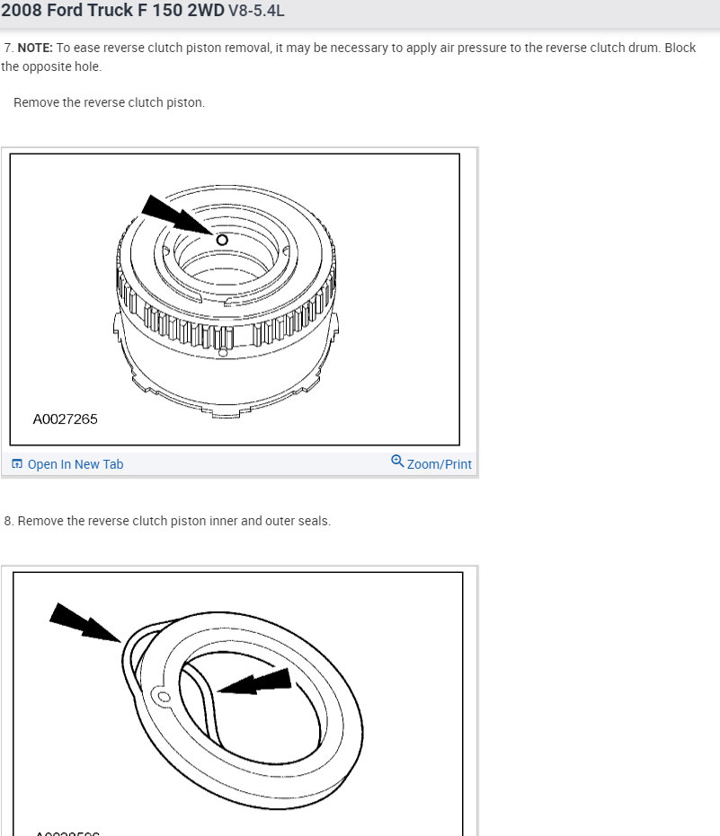

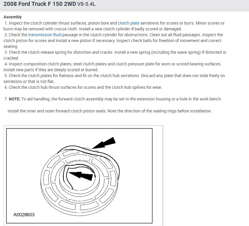

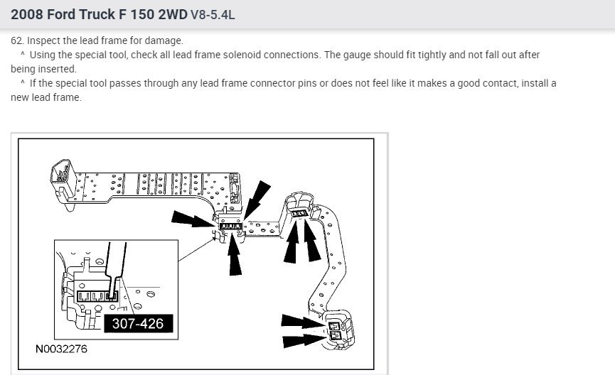

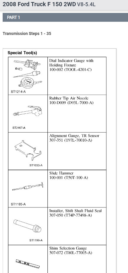

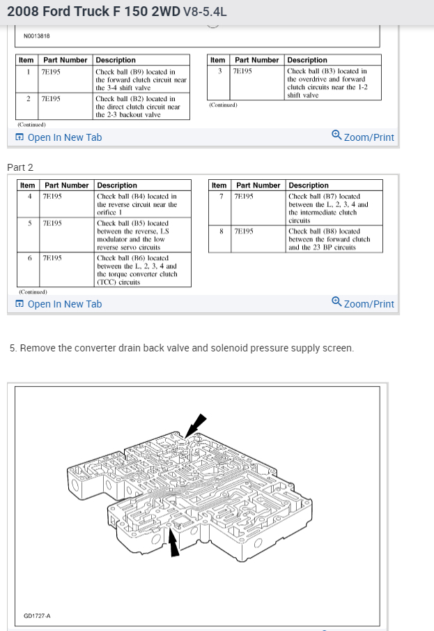

ARIANADANIELLE5345
  • 393 POSTS

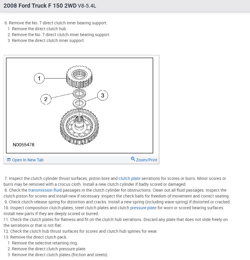

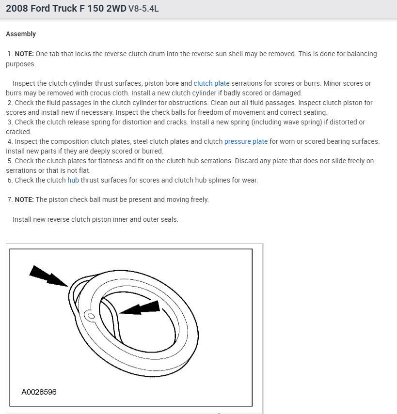

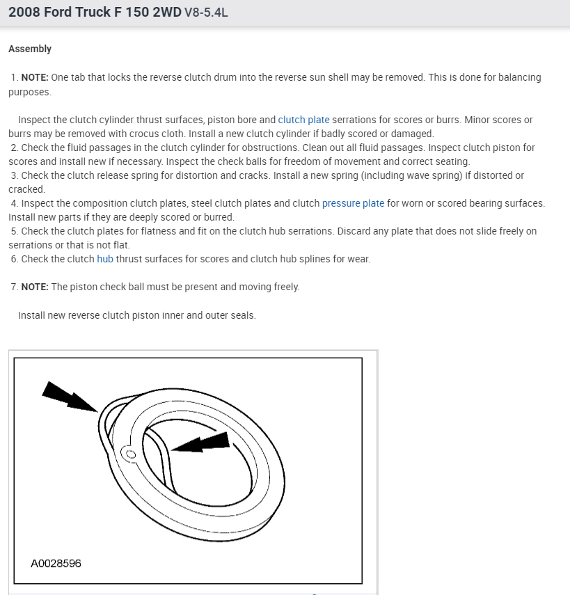

Are there inspection instructions you would be able to post for the transmission parts or at least for the valve body? I am finding that things that would not be okay in an engine are seemingly fine in a transmission. It’s very different and I really don’t want to mess this up. I'd like to be as thorough as possible.
Thursday, June 30th, 2022 AT 2:45 AM
SQM
  • 6,383 POSTS
Unfortunately, the repair manual does not provide an inspection guide, just rebuilding and replacement.
However, there are some helpful videos on YouTube on this subject.
Take a look at this video.
https://youtu.be/EBuQNkJcKhA
Thursday, June 30th, 2022 AT 8:36 PM

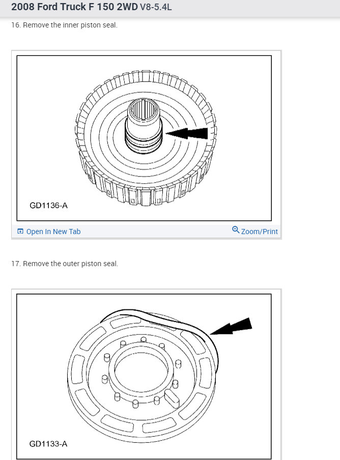

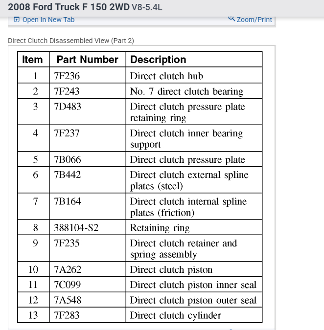

ARIANADANIELLE5345
  • 393 POSTS

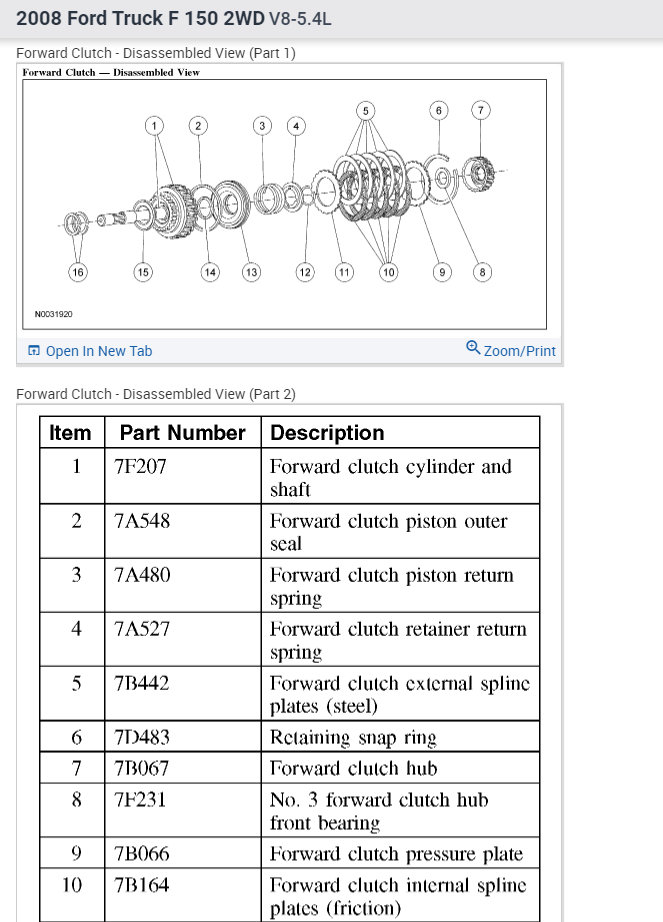

Okay, I will, thanks. Should I replace the bushings in the transmission since it has around 300,000 (maybe more) miles on it?
Friday, July 1st, 2022 AT 11:55 AM

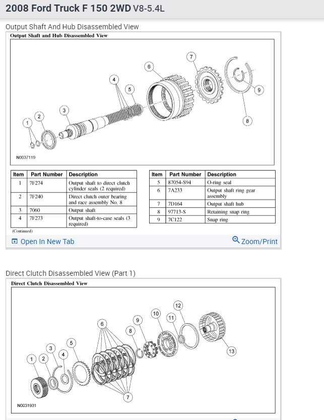

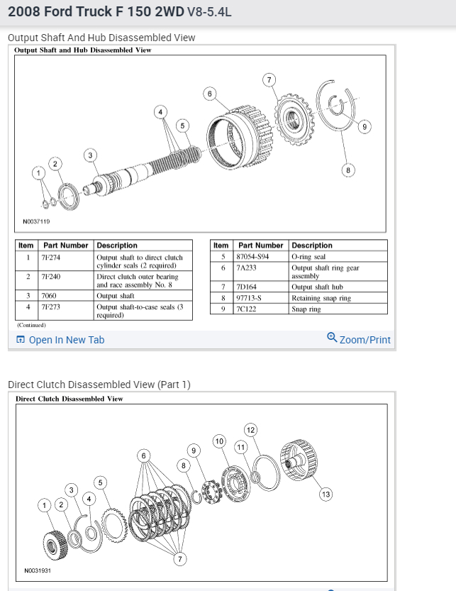

ARIANADANIELLE5345
  • 393 POSTS

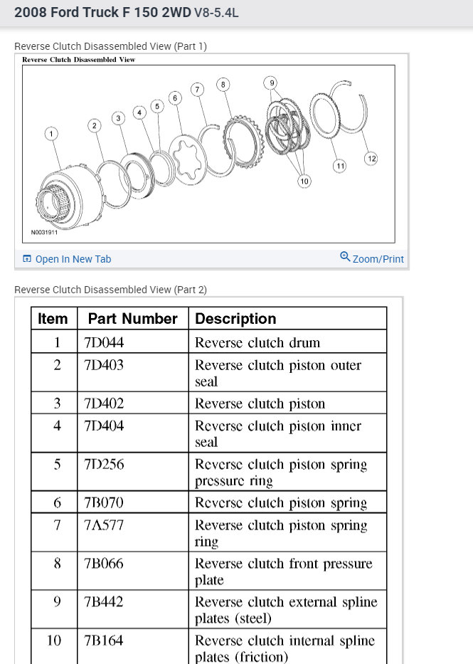

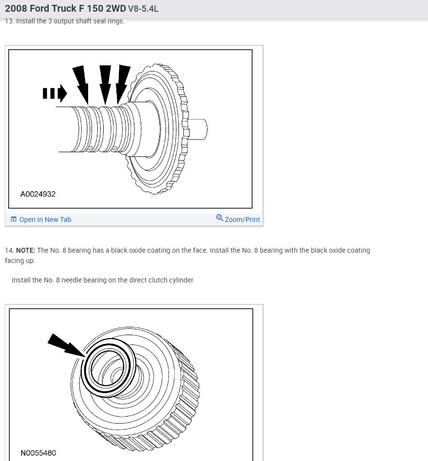

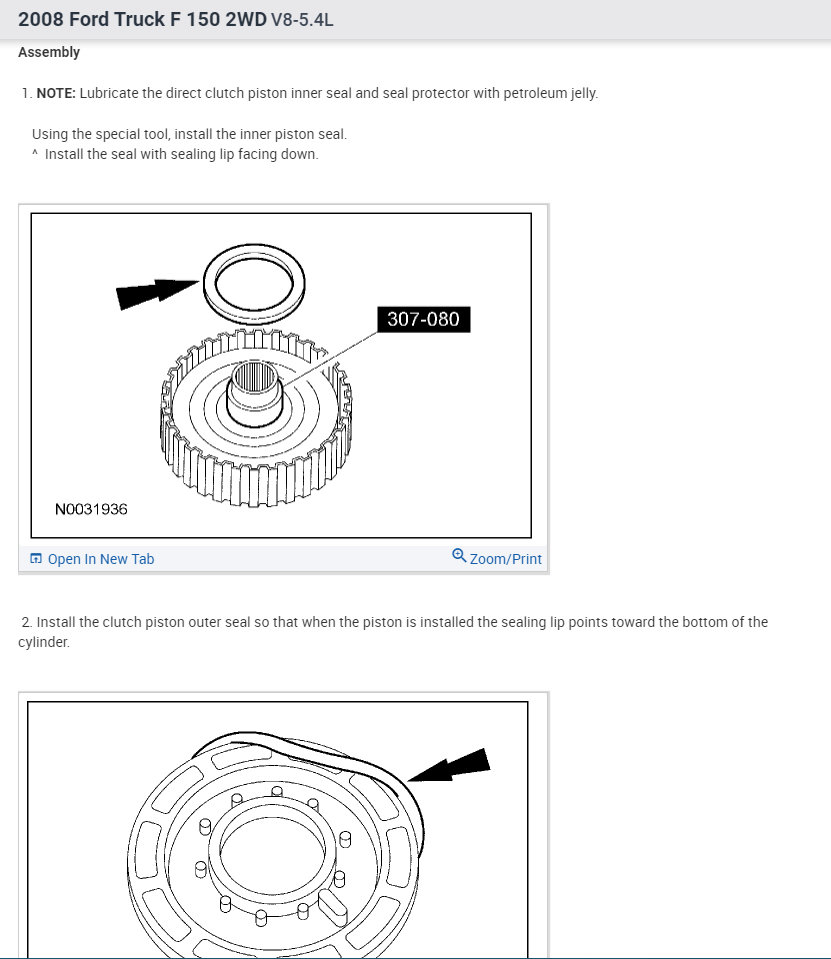

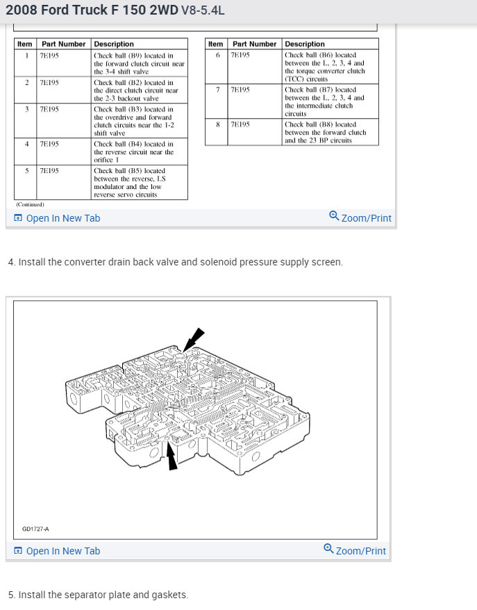

Also, I can't really see the different o rings in the pictures posted. How can I identify which one goes where other than putting them where they fit?
Friday, July 1st, 2022 AT 1:24 PM

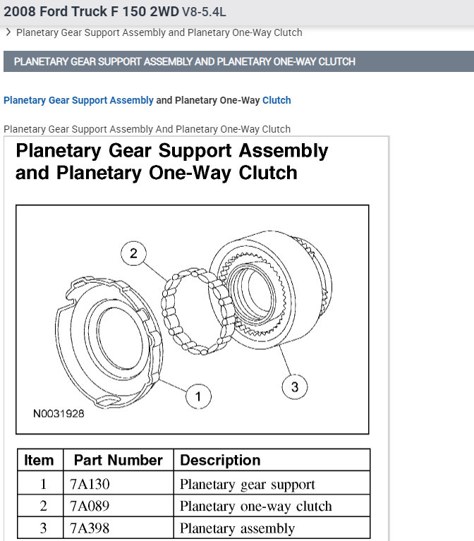

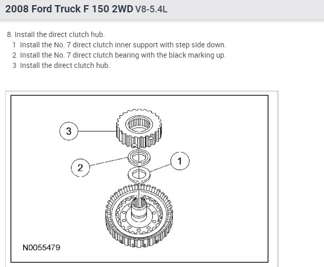

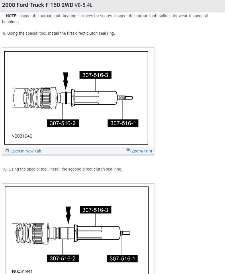

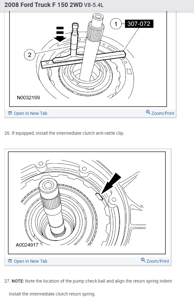

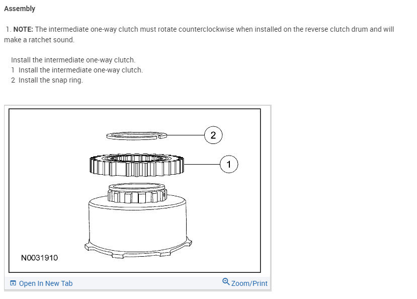

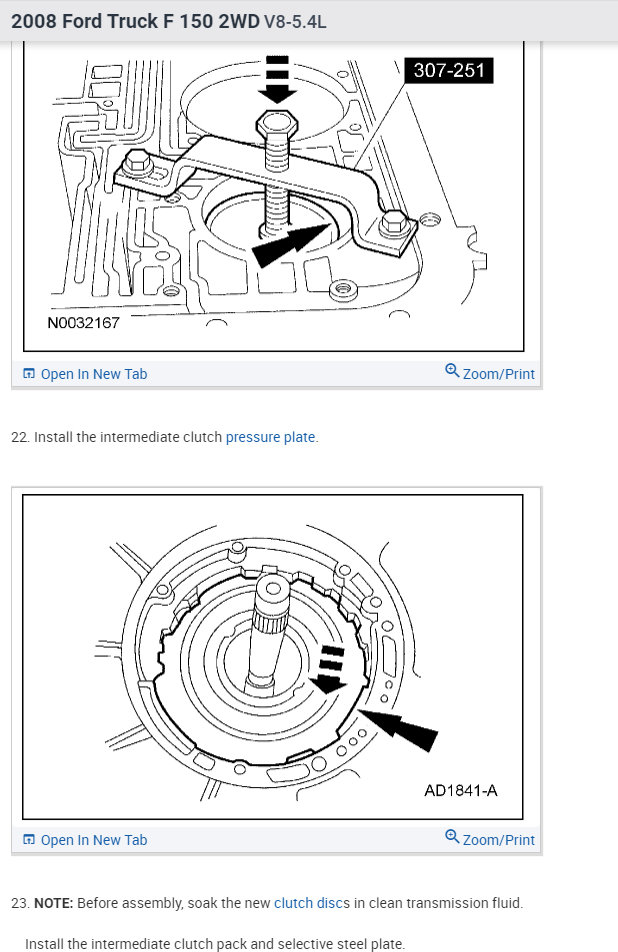

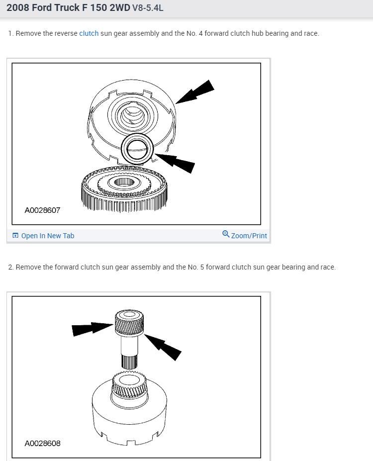

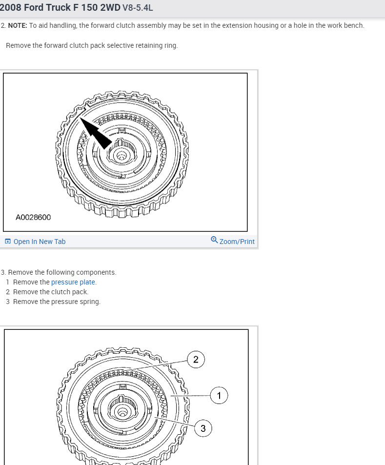

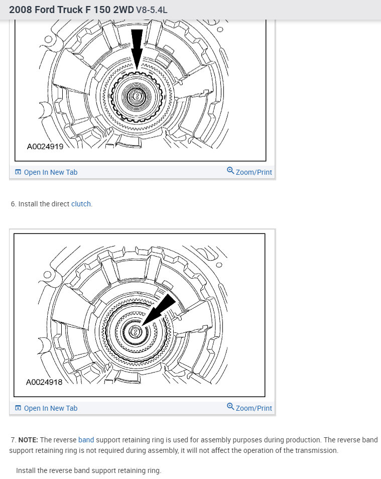

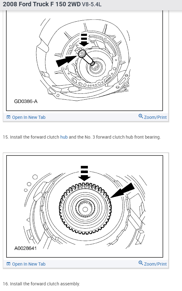

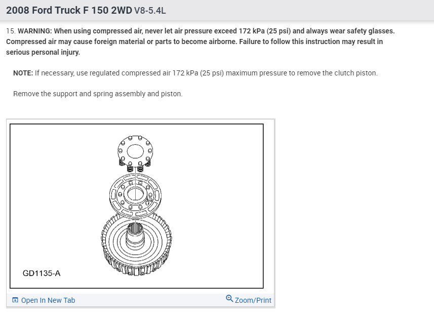

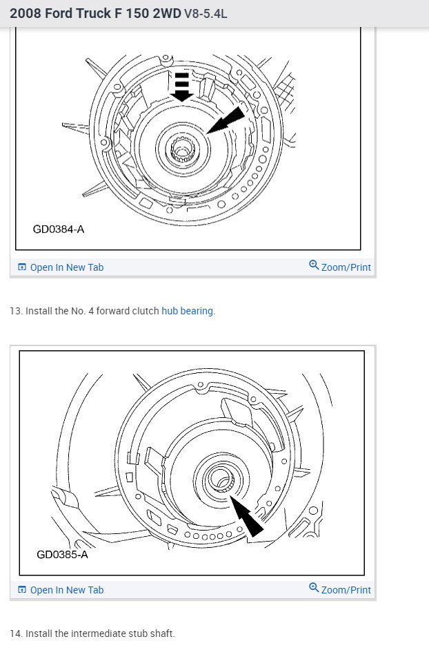

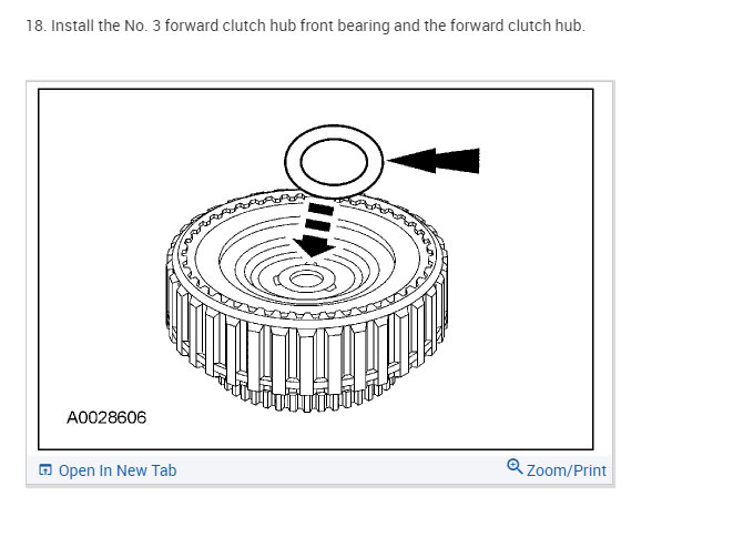

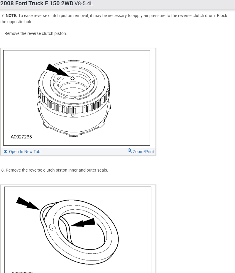

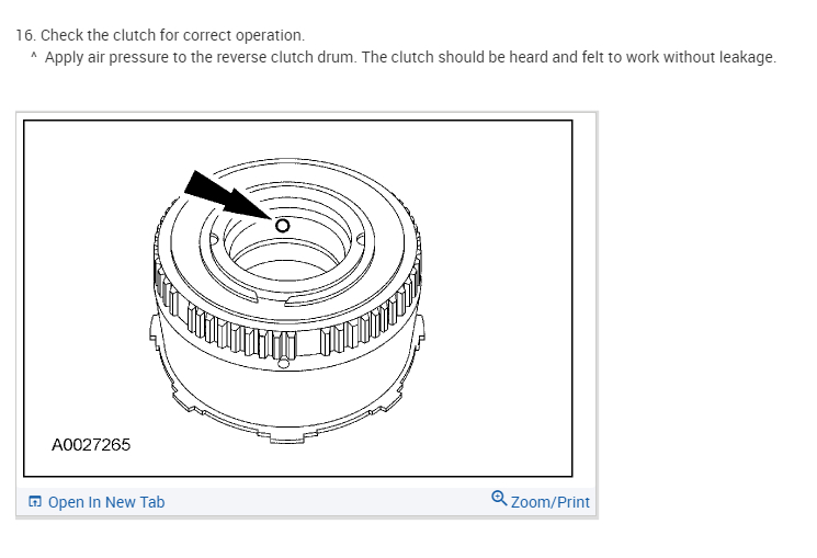

ARIANADANIELLE5345

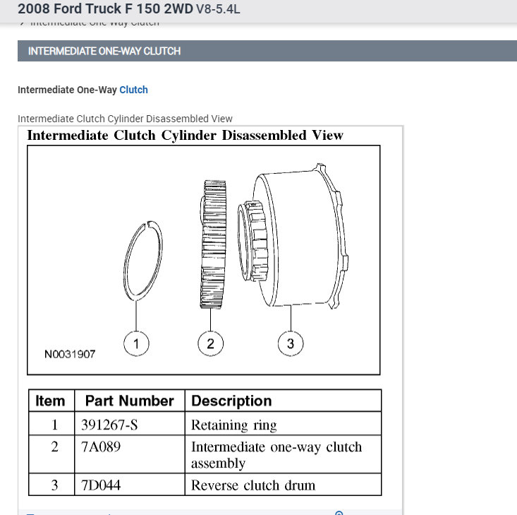

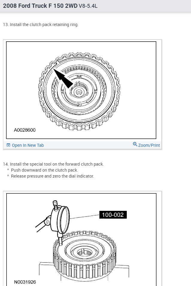

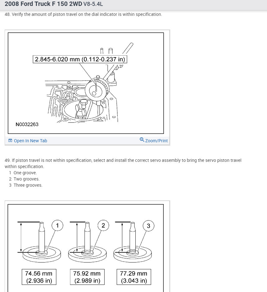

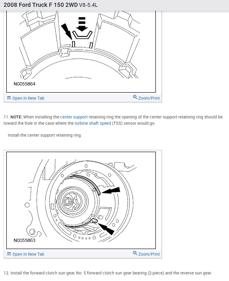

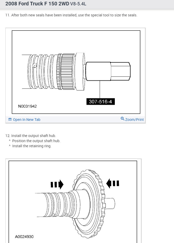

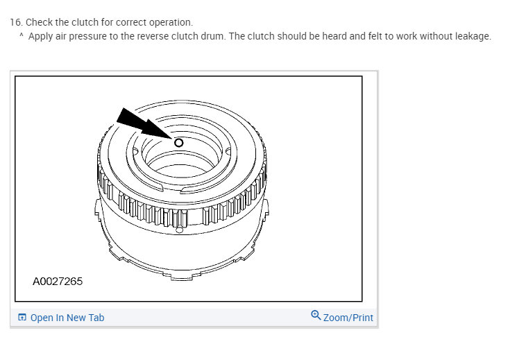

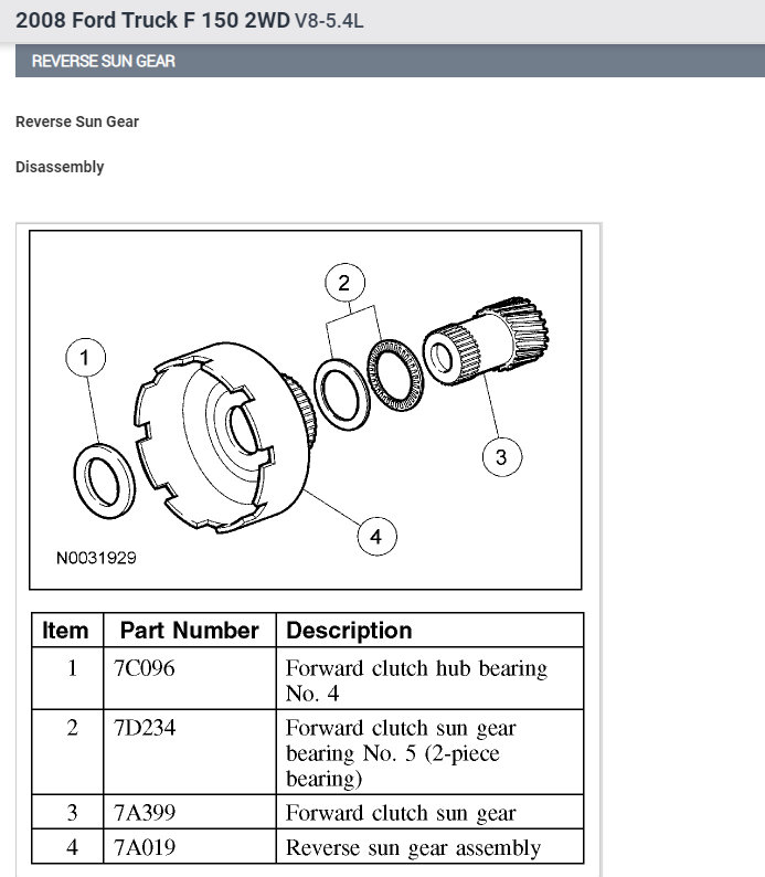

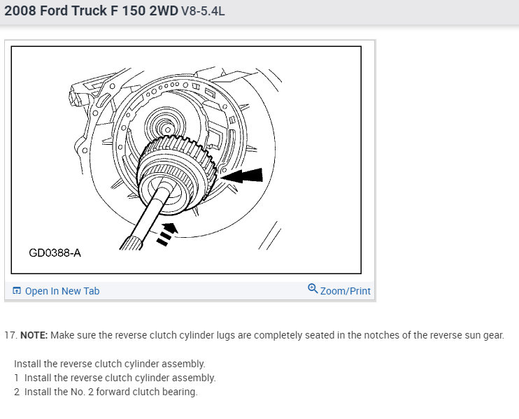

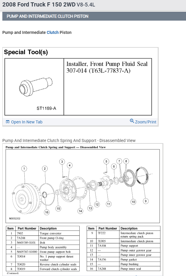

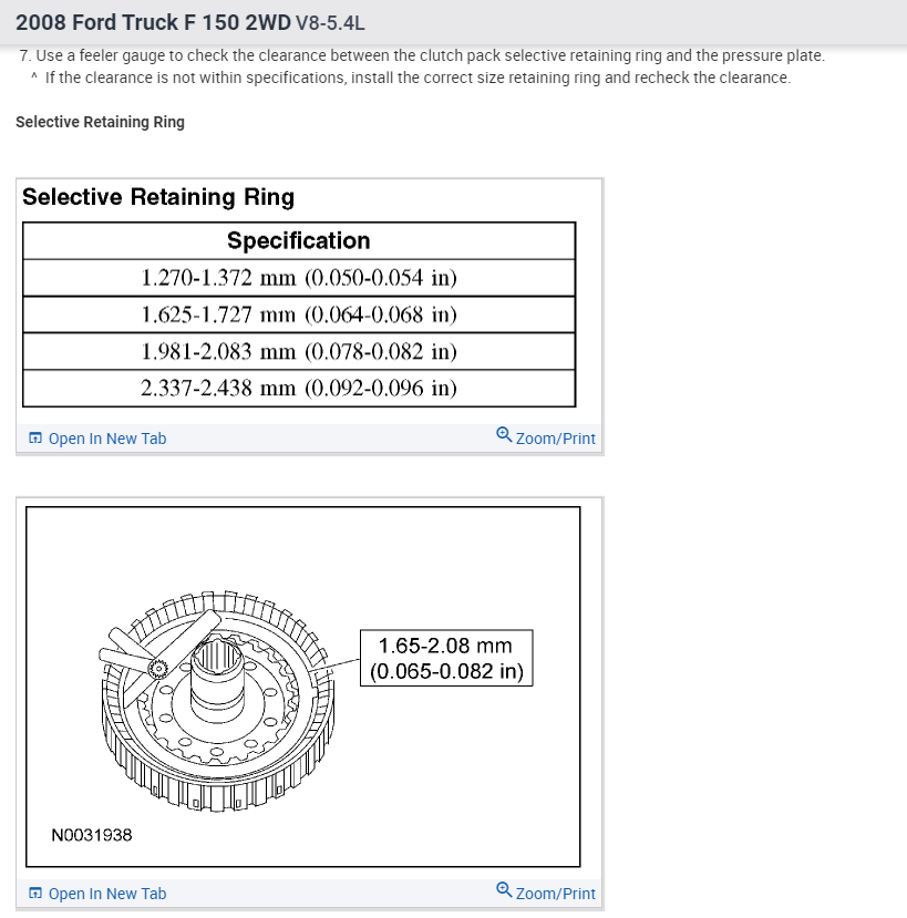

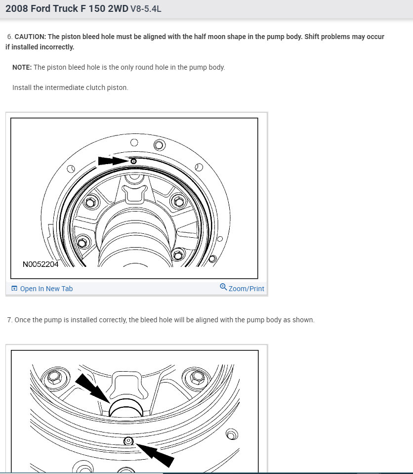

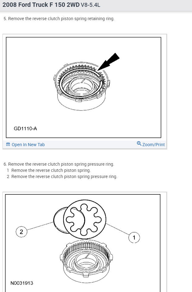

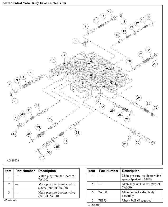

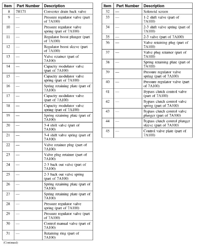

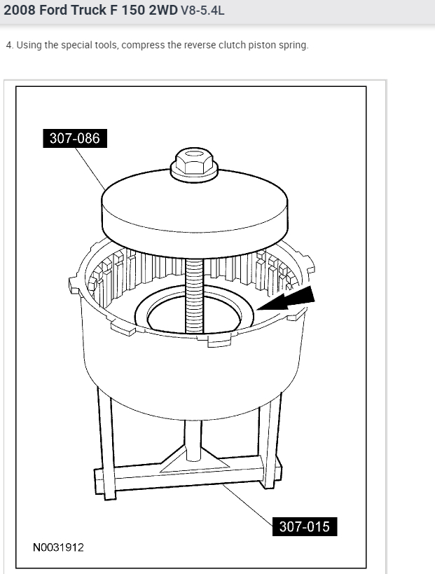

  • 393 POSTS

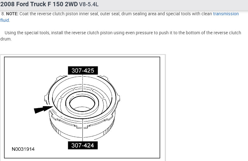

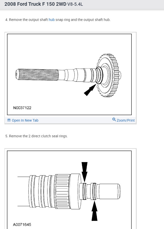

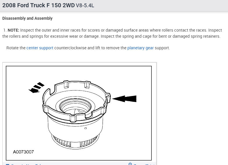

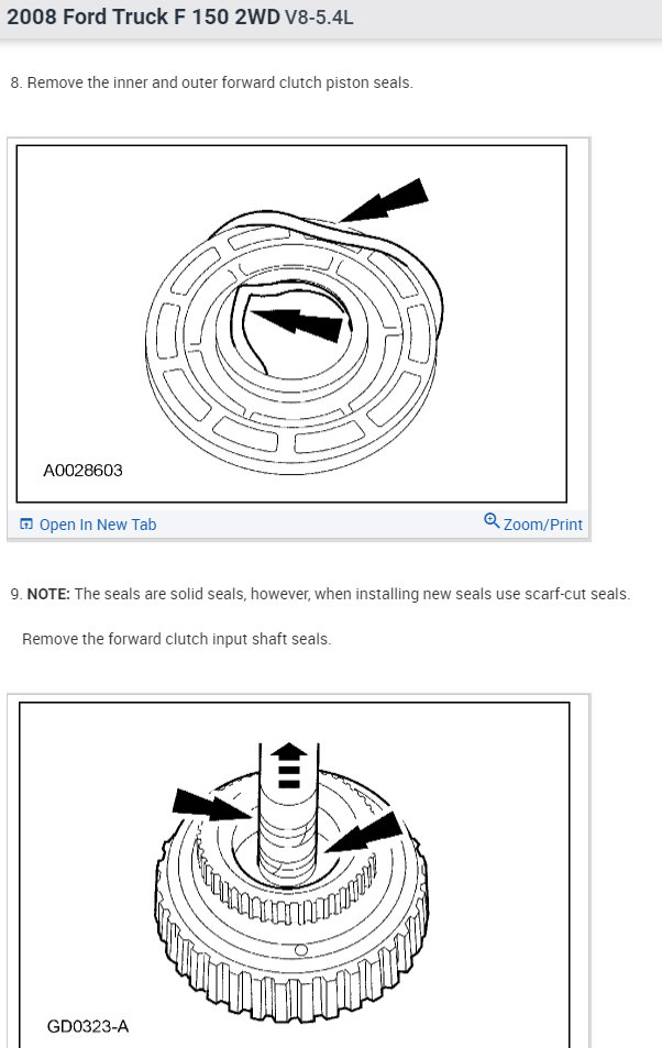

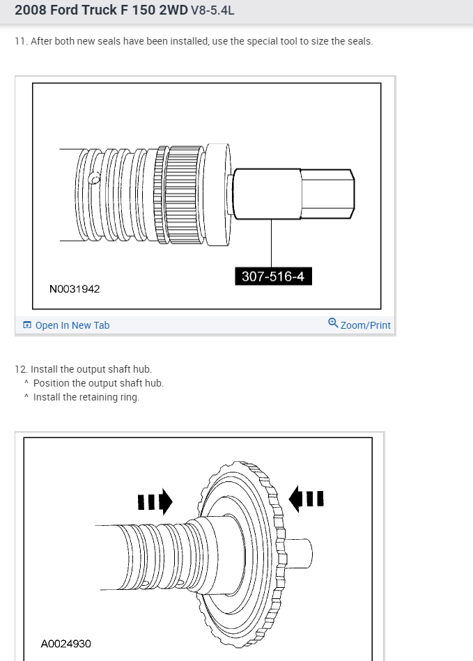

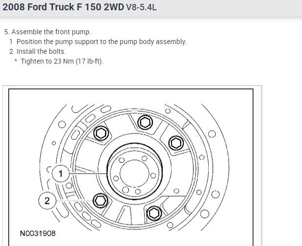

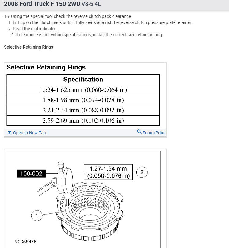

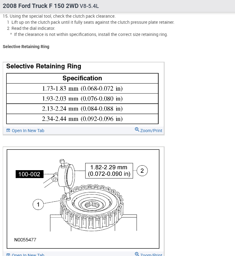

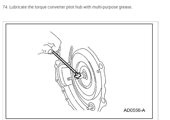

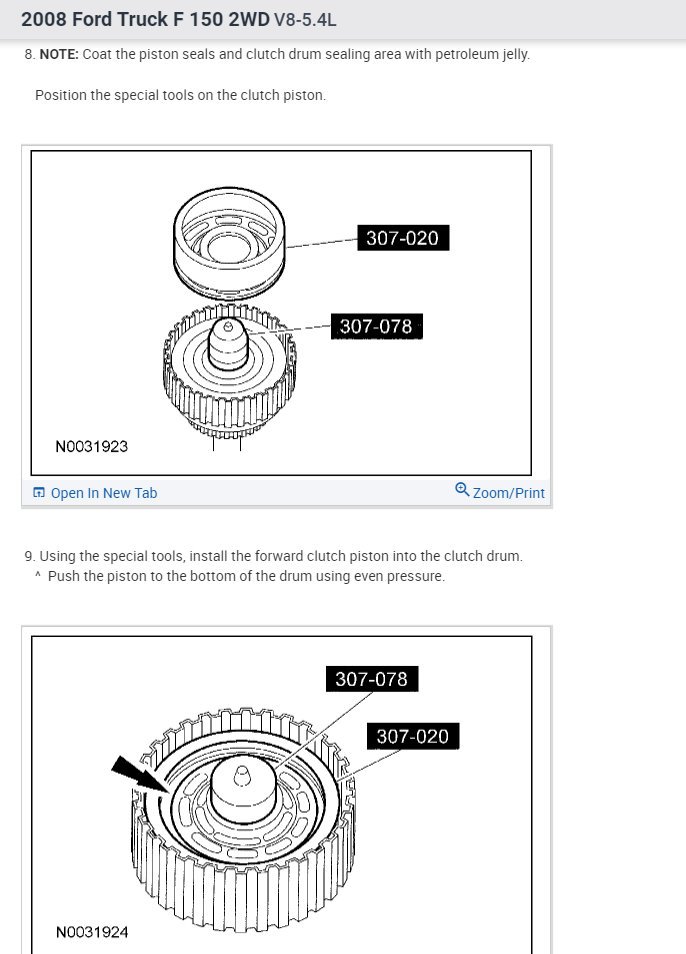

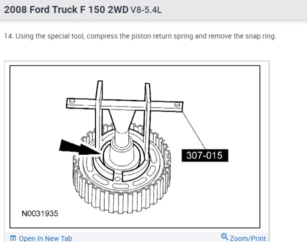

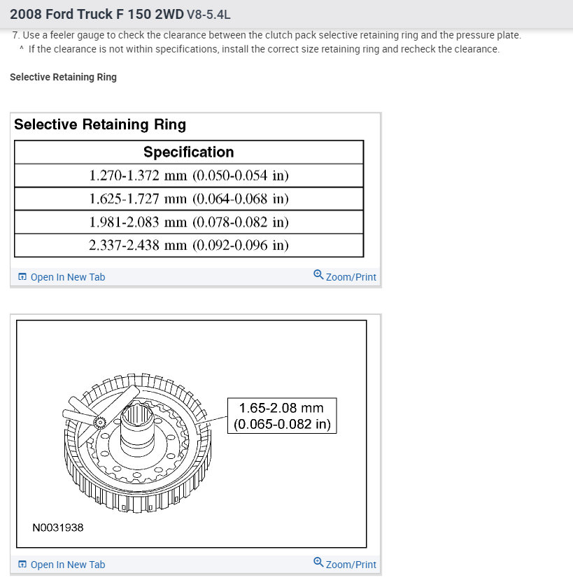

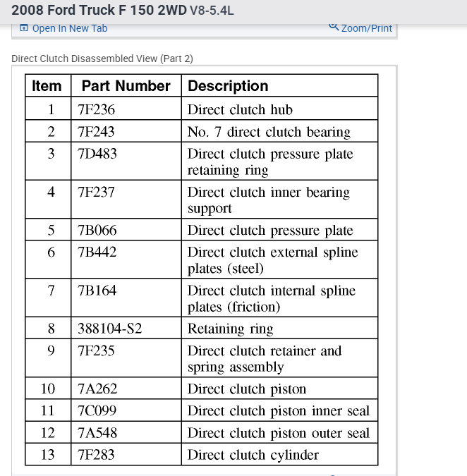

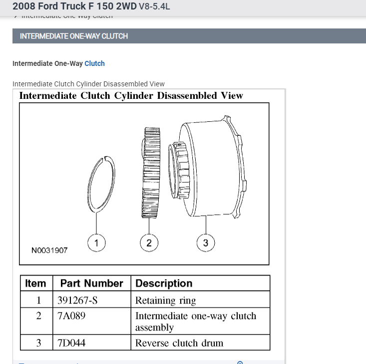

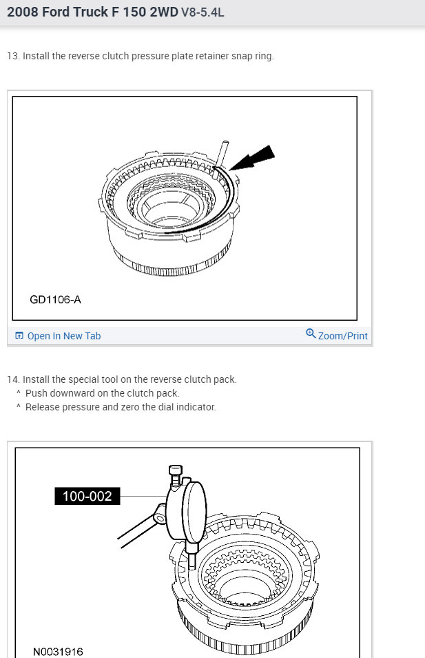

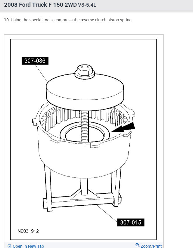

I keep seeing “in the sub assembly section” in the directions but don’t see the actual section. Can you post the instructions to assemble the sub assemblies?
Saturday, July 2nd, 2022 AT 2:09 PM

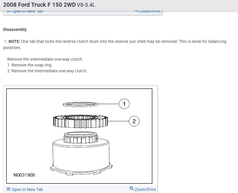

SQM
  • 6,383 POSTS

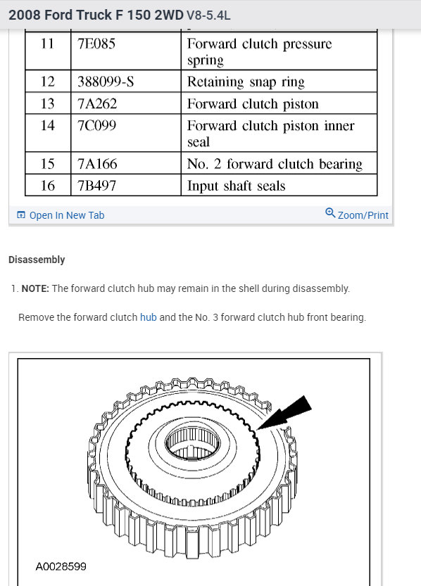

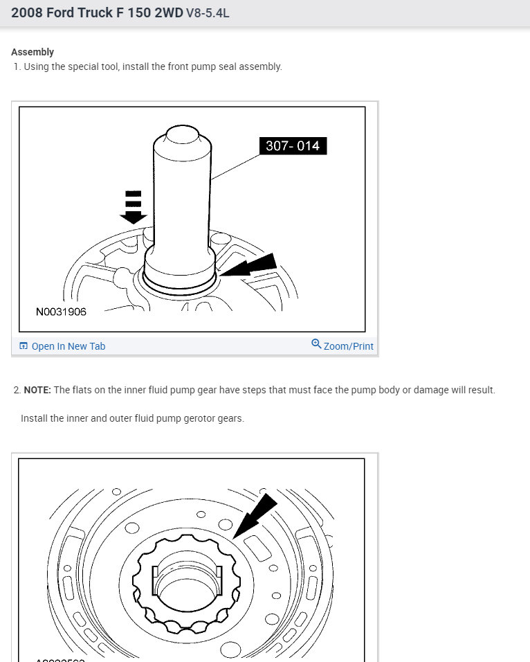

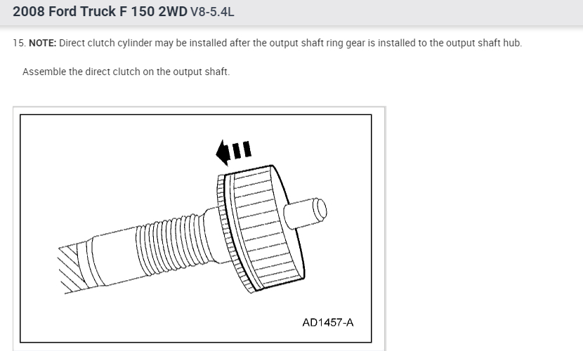

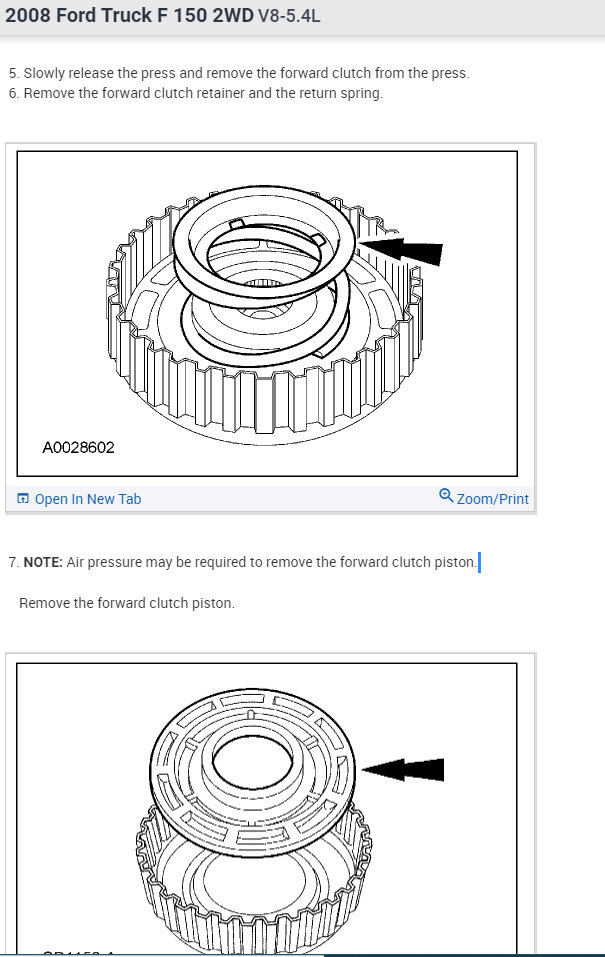

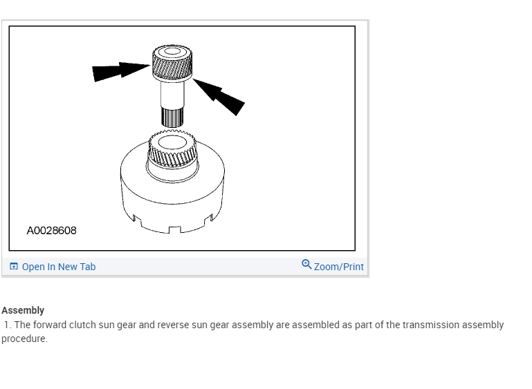

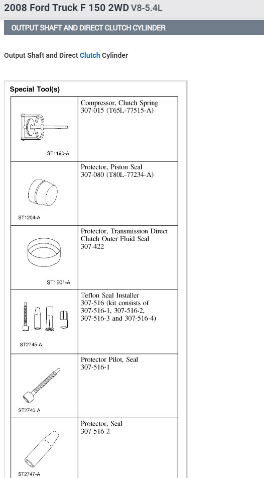

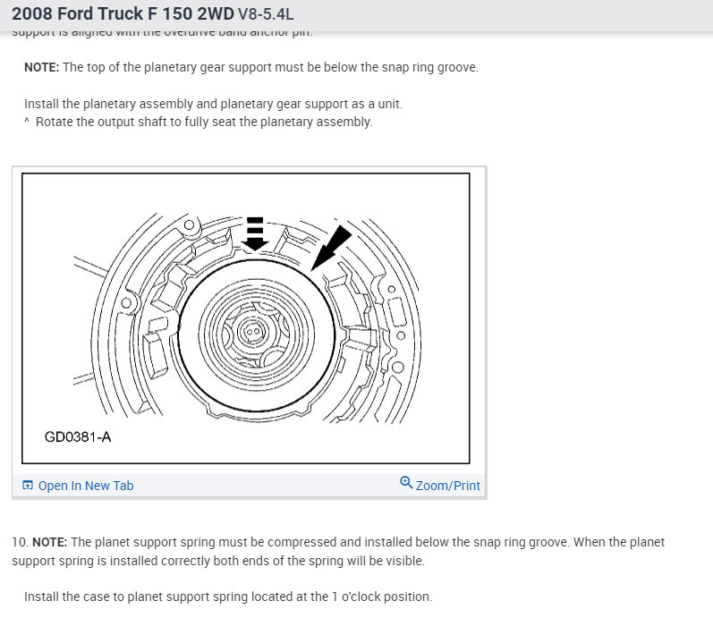

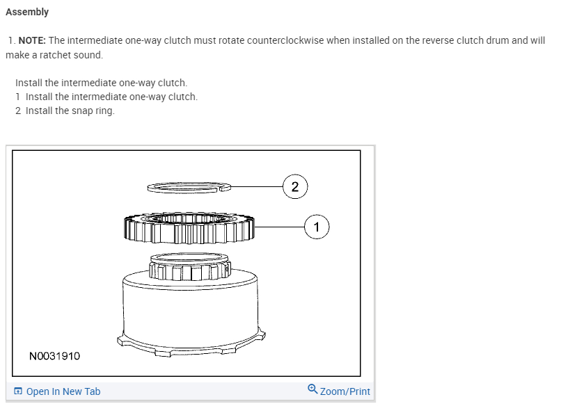

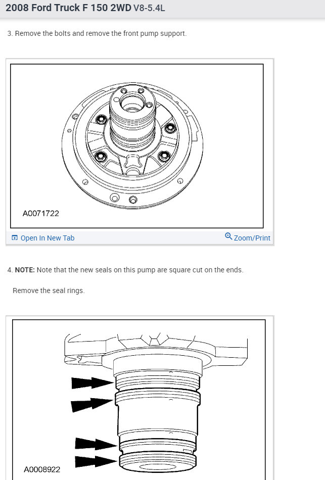

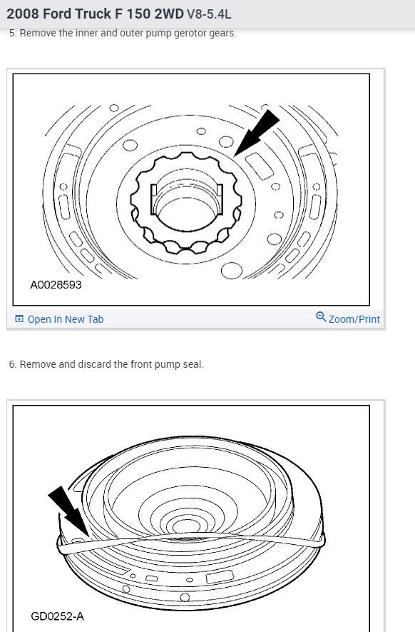

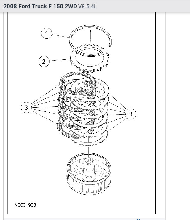

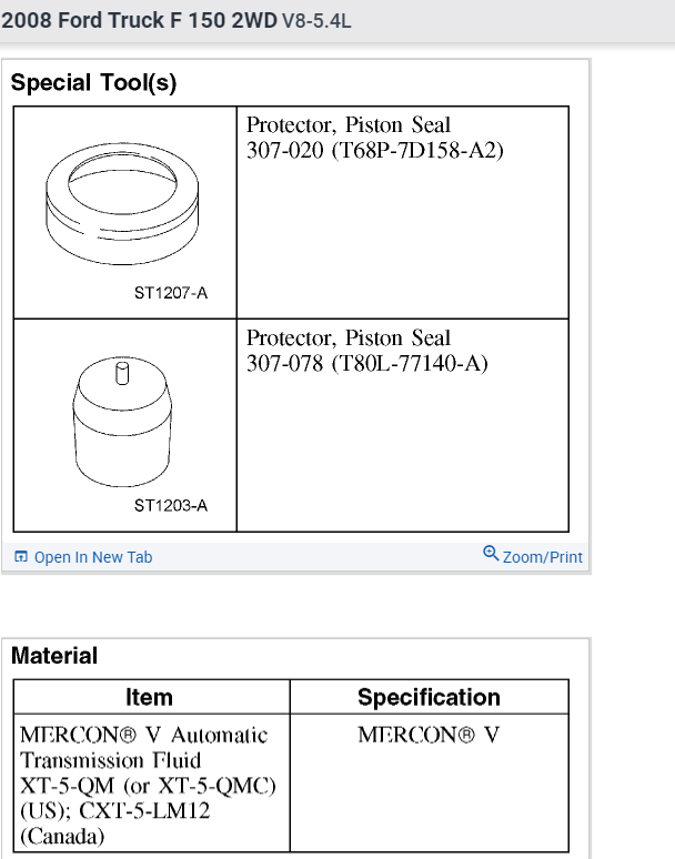

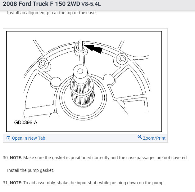

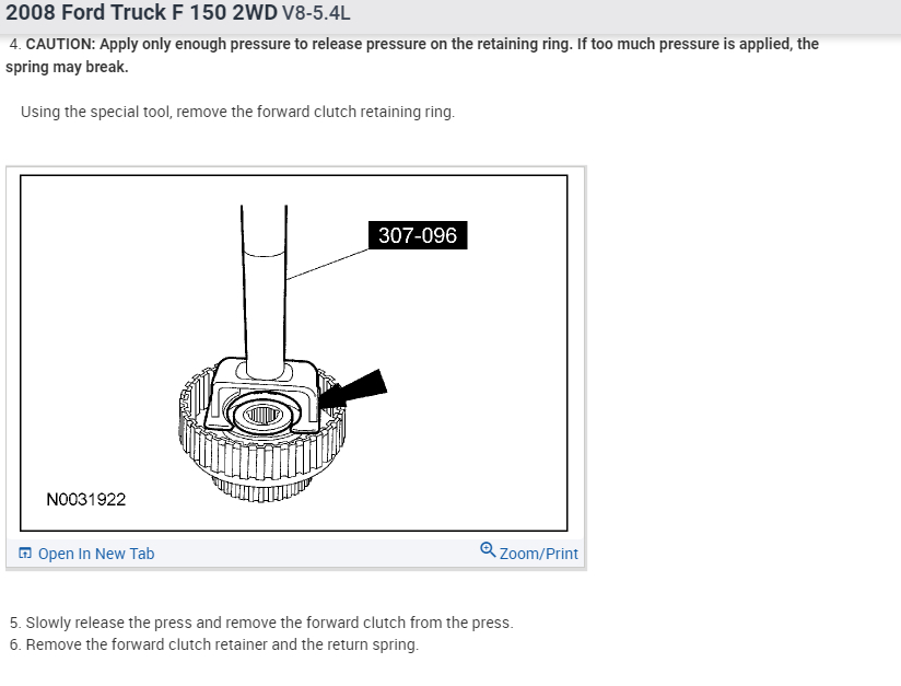

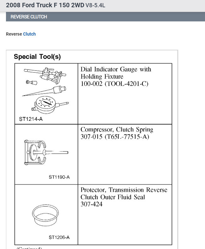

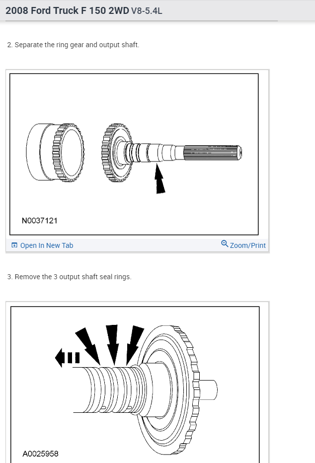

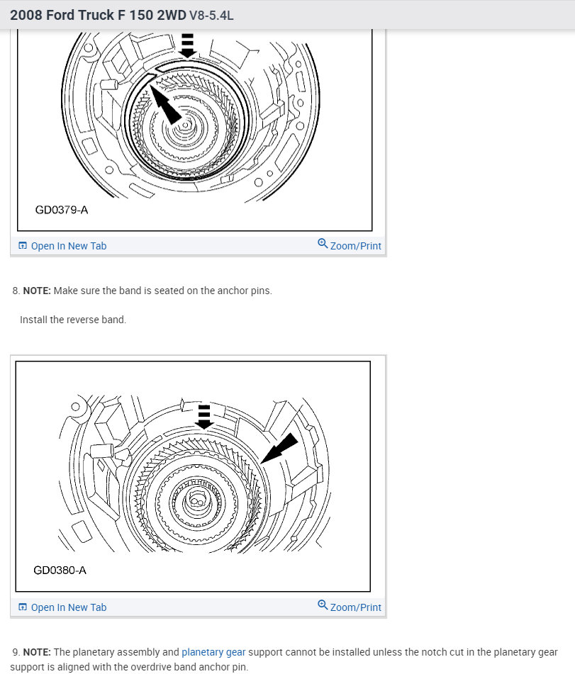

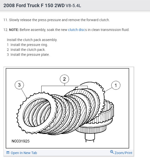

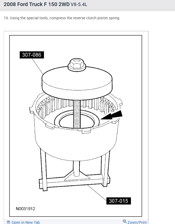

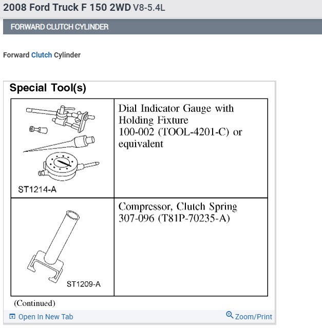

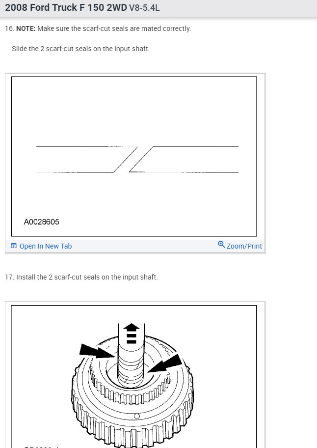

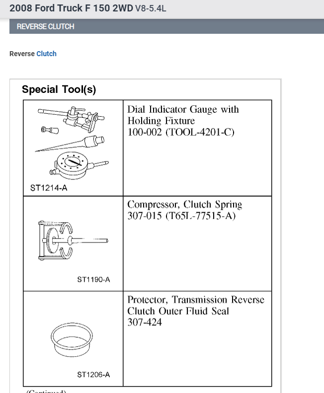

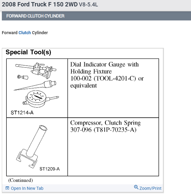

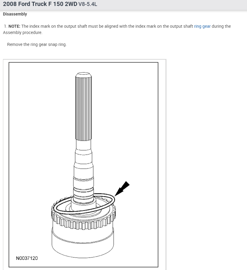

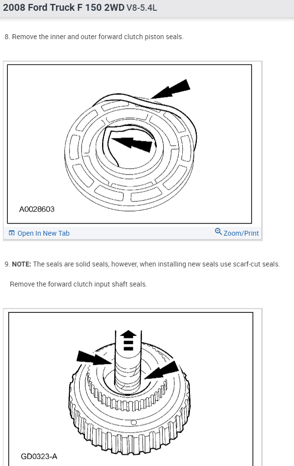

These are the subassemblies that have more details:
Forward Clutch Cylinder
Intermediate One-Way Clutch
Main Control Valve Body
Output Shaft and Direct Clutch Cylinder
Planetary Gear Support Assembly and Planetary One-Way Clutch
Pump and Intermediate Clutch Piston
Reverse Clutch
Reverse Sun Gear
Let me know which one you want to take a look at.
Sunday, July 3rd, 2022 AT 11:04 PM
ARIANADANIELLE5345
  • 393 POSTS
All of them. I literally took everything completely apart.
Wednesday, July 6th, 2022 AT 2:12 PM
SQM
  • 6,383 POSTS
See attached.
Wednesday, July 6th, 2022 AT 11:20 PM
ARIANADANIELLE5345
  • 393 POSTS
Oh wow that’s perfect. Thank you!
