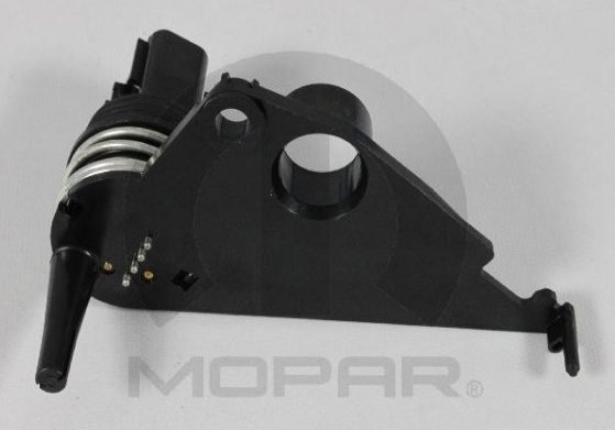

Transmission range sensor
2001 CHRYSLER TOWN AND COUNTRY
180,000 MILES • 3.8L • 6 CYL • FWD • AUTOMATIC
DONNA MARIE DAVIS
We were told that this part is bad and it is inside the transmission. We cannot find the part on any of the parts store sites and the husband thinks the mechanic is trying to pull one over on us. Is this true ? Thanks for your help.
Aug 28, 2017 at 4:09 PM
STEVE W.
  • CAR REPAIR CONTRIBUTOR
  • 15,167 POSTS
This is the part the mechanic is talking about. It is Mopar part number 4659676AC. It tells the computer what gear you have selected with the lever so it can activate the correct solenoids for that gear.
