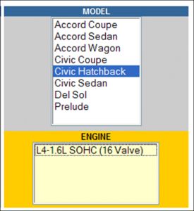

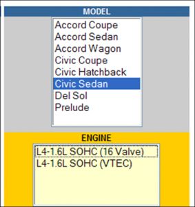

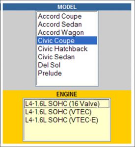

IMPALASS
  • 3,112 POSTS
Hello -
We are all doing just fine. . .. . .. . ...thanks for asking. We will do our best to assist you but we need to get more specific on your vehicle to make sure we are talking about the same one.
I have attached the model with the engine choices below them. As you will see the coupe has several, the hatchback etc. Please let us know so we can better assist you.
https://www.2carpros.com/forum/automotive_pictures/248015_Picture3_6.jpg
https://www.2carpros.com/forum/automotive_pictures/248015_Picture4_6.jpg
https://www.2carpros.com/forum/automotive_pictures/248015_Picture5_4.jpg
