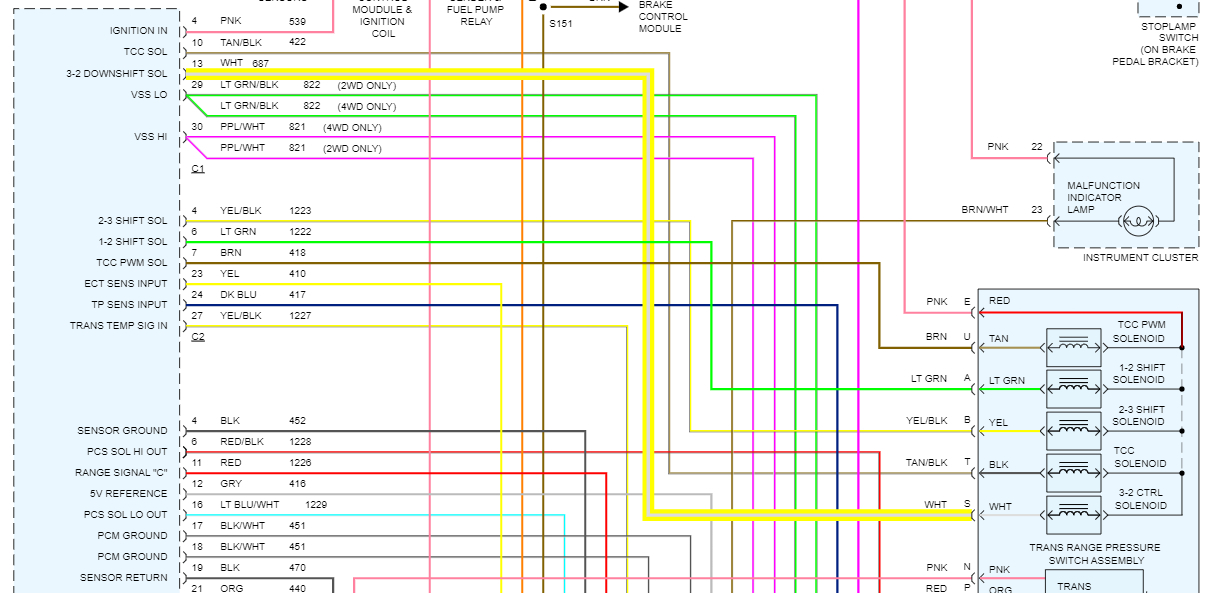

If there is a code for shift solenoid B (which is the 2-3) shift solenoid, it shouldn't be causing issues with downshifting. If you have the code that was found, let me know what it is so I can research it for you.
There is a 3-2 downshift solenoid in the transmission as well. That would make more sense to me. See pic below
See pic below.

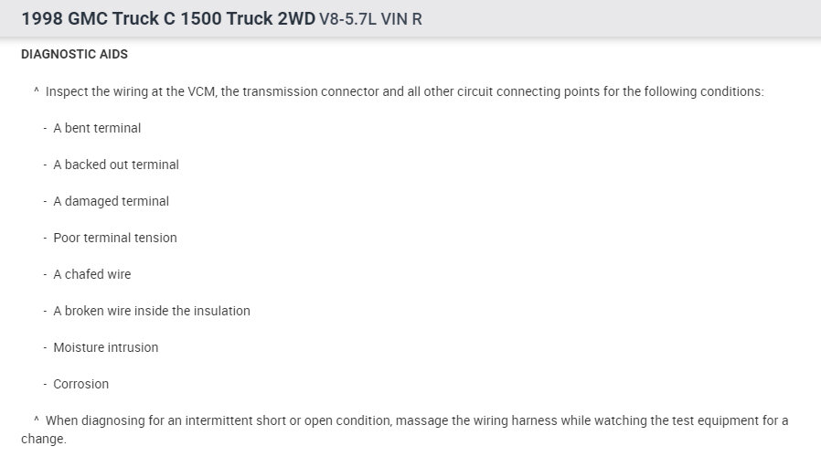

Po758 shift sol.B
Po430 cat system
Po452 E vap
Po420 cat
Those are all the codes for everything. The first one is for the transmission the rest for other things I'm sure u know that though.
Sunday, October 16th, 2022 AT 9:05 AM
  • 110,194 POSTS

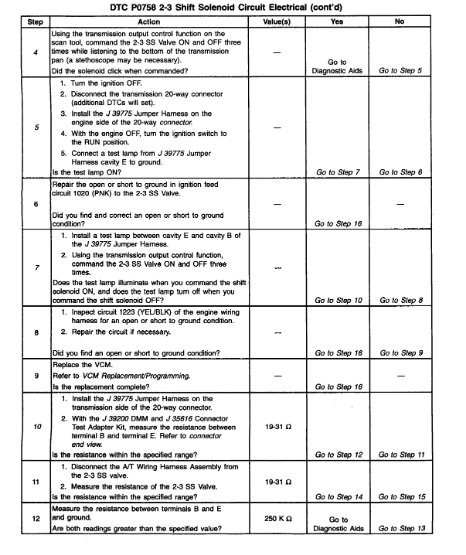

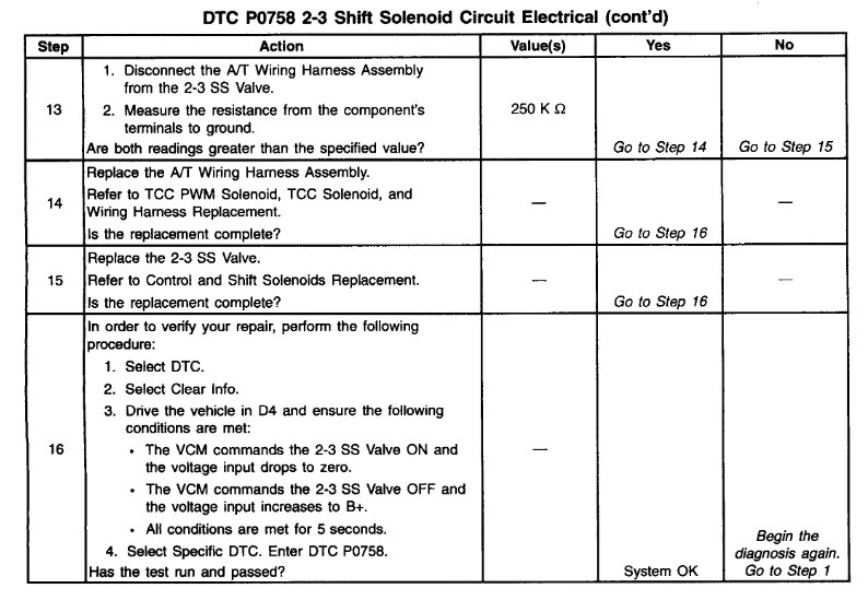

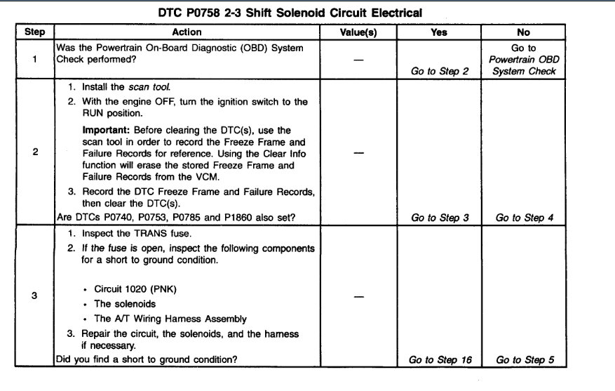

The solenoid could have been the issue, but the code is specific to a power issue. When the PCM detects a continuous open or short to ground in the 2-3 SS Valve circuit or the 2-3 SS Valve, then DTC P0758 sets.
I attached the diagnostics below. Since you already replaced the solenoid B, it is likely a wiring issue.
Here is my concern. The diagnostics require a scan tool that can communicate with the different modules. I don't know if you have one or have access to one.
Take care and hang in there. I wish I had an easier solution.

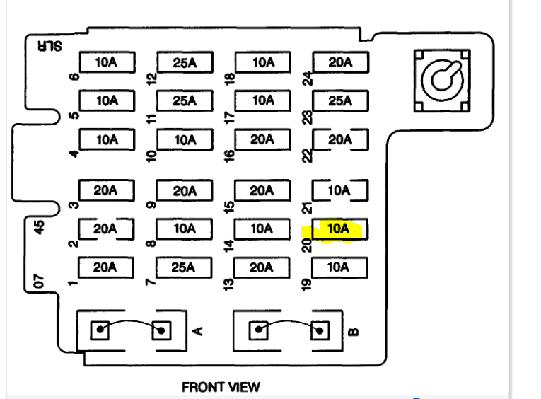

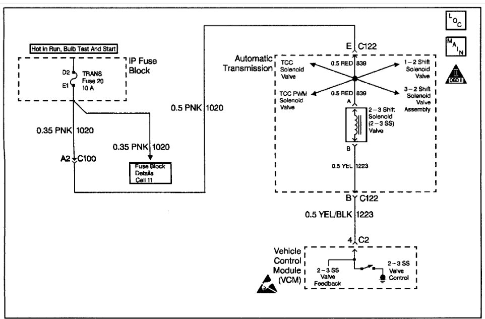

See pics below. Also, I read through the diagnostics and the first thing it suggests is to check the transmission fuse in the interior fuse box. I don't think that is an issue otherwise other things wouldn't be working such as the speedometer. However, I attached it to help you locate the fuse to check.
