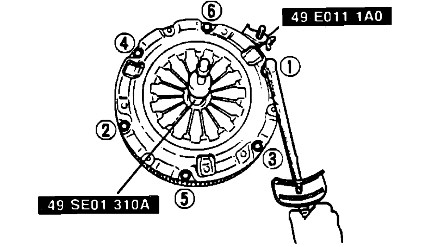

3. Insert clutch disc pilot tool.
4. Loosen pressure plate retaining bolts one or two turns at a time until spring pressure is released, then remove pressure plate and disc.
5. Reverse procedure to install, noting the following:

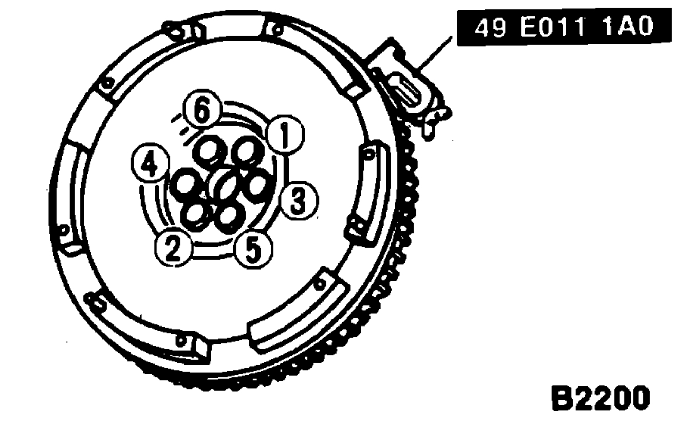

a. Torque pressure plate retaining bolts in the diagonal pattern shown in Fig. 1 to 13-20 ft. lbs. on B2600i models or 16-24 ft. lbs. on B2200 models.
b. Torque slave cylinder retaining bolts to 12-17 ft. lbs.

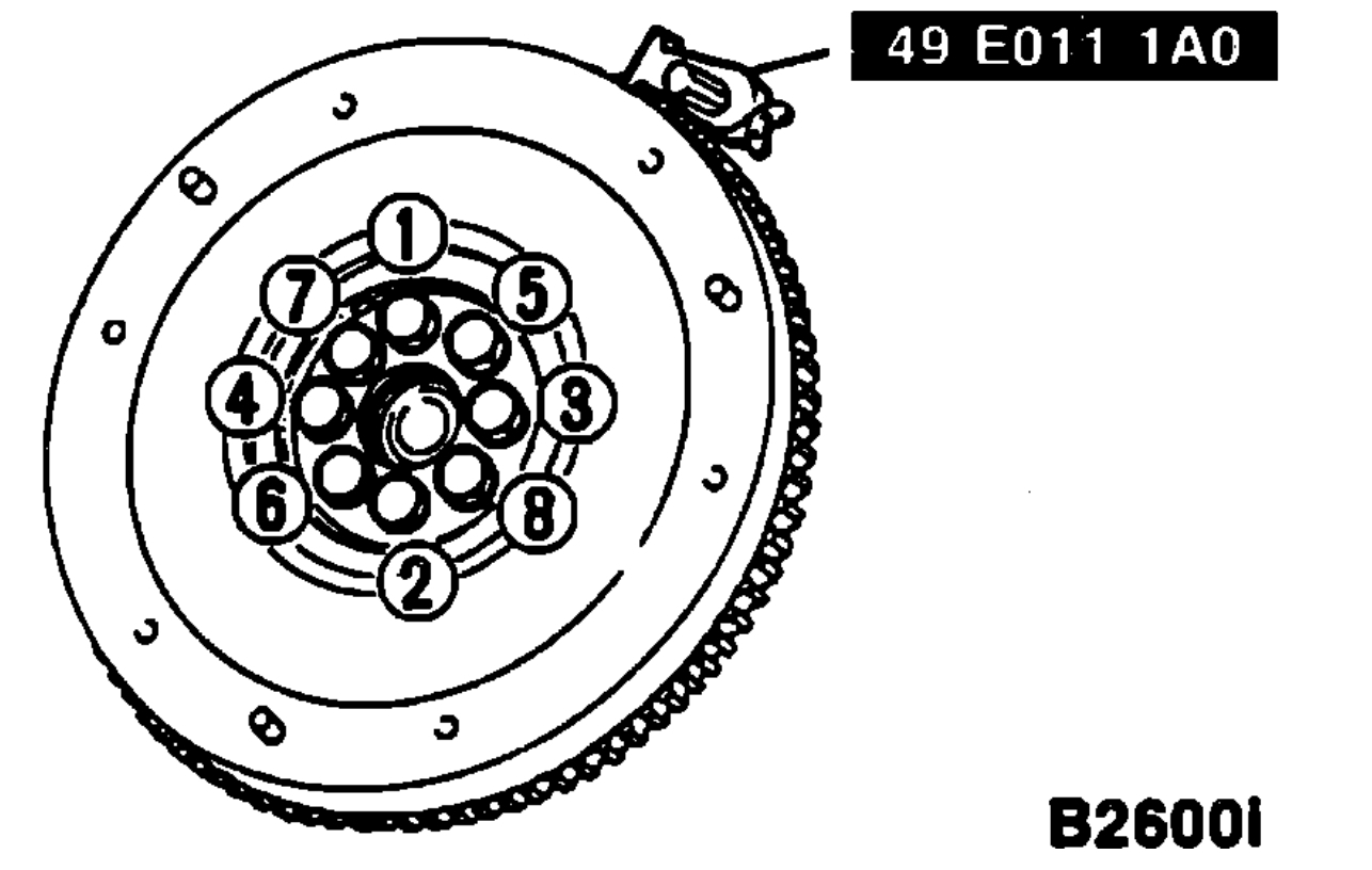

c. If the flywheel was removed for resurfacing, torque flywheel retaining bolts for B2200 models in sequence shown in Fig. 2 to 71-76 ft. lbs. or to 67-72 ft. lbs. in sequence shown in Fig. 3 on B2600i models.
