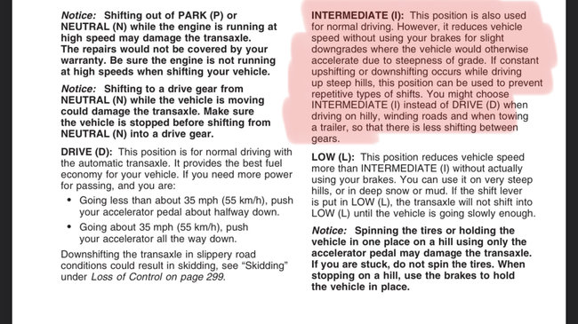

When moving the gear selector into drive position, the dash illuminates intermediate gear?
2007 CHEVROLET EQUINOX
170,000 MILES • 3.4L • 6 CYL • 4WD • AUTOMATIC
NTSTEMMLER
When moving the gear selector into drive position, the dash illuminates (Intermediate gear) and the car drives in that gear. It shifts hard, I believe because I’m driving in normal conditions (not towing a load or straining the engine on hill climbs, etc.) and is definitely putting strain on the engine as it over-revs and is locked out of OD. I’m planning to do repairs myself as I’m an experienced (at-home) mechanic, but I’m not sure where to start.

Correction: it is Intermediate gear, not intermittent, my bad. I have scanned it and had a garage scan it for me as well. The only code pulled was P0405 which is low voltage in exhaust gas recirculation (EGR) and I doubt that has any effect on the transmission not shifting to drive.
Aug 18, 2022 at 2:17 PM
  • 54,520 POSTS
I am not sure what you are talking about, "Intermediate gear?" can you upload an images please?
Aug 19, 2022 at 11:07 AM
NTSTEMMLER
I’ll get a picture/short video when I go to do some body work on the car later. For now I have this from the manual.

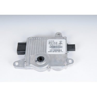

NTSTEMMLER
Also, I do not have a gear range sensor like the one pictured in the diagrams you posted. Where that would be, I have this.. Which I believe to be the TCM.
Aug 21, 2022 at 6:31 AM
  • 54,520 POSTS
Nice, thanks for the info, yes that is the TCM here is how you replace it in the images below. Let me know what happens please.
