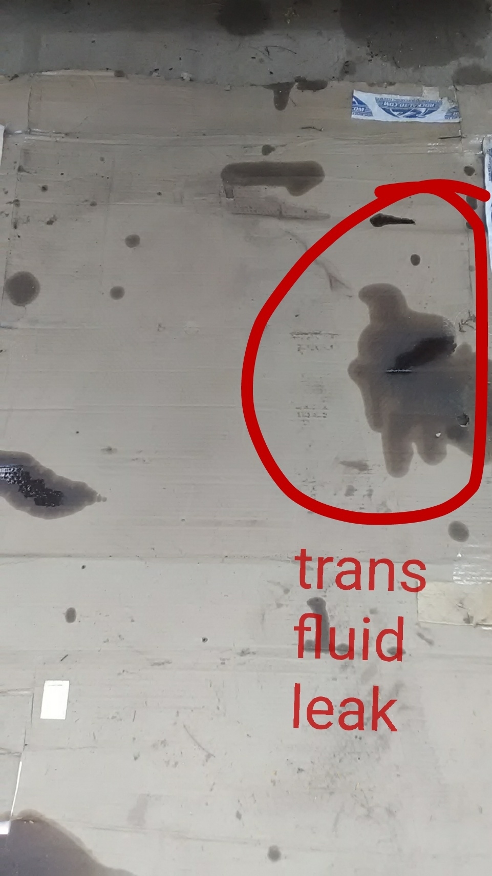

I'm losing fluid. Found out it was missing a pan bolt and replaced it, but it continues to leave fluid leak on cardboard.
Monday, April 6th, 2020 AT 9:50 AM
BUICK_DUDE
  • 91 POSTS
The pan is covered in fresh fluid. Every time I drive it leaves a small smear of transmission fluid in the parking spot.

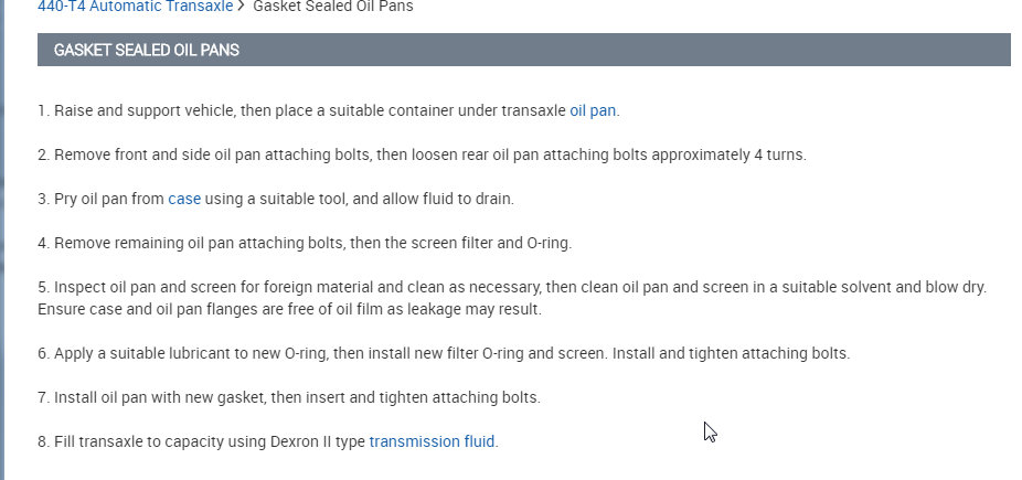

If when you pull down the pan, it has a gasket then you don't need sealant. It is leaking because it basically has a failed seal so no matter how tight you make, it still have the path. If there is no gasket then you use a sealant silicone rated for transmission fluid.
Sounds like you just need to pull it down and reseal it. I attached the process which does not have a lot detail but it does give the steps.

It was missing a bolt so maybe that caused the gasket to fail prematurely. I was able to order the gasket so I assume it needs and has one, but I will find out soon if thats the case. I have never replaced it. Ill update. Will be working on it on Saturday.
Monday, April 6th, 2020 AT 5:03 PM
Sounds great. Normally they do have a gasket so I am sure you are good to go. If you want to use a couple dots of silicone to hold it in place while installing it you can do that but I normally just stick two bolts through the pan and the gasket then those bolts hold the gasket in alignment when putting the pan up. Finger tighten those two bolts then start the rest.

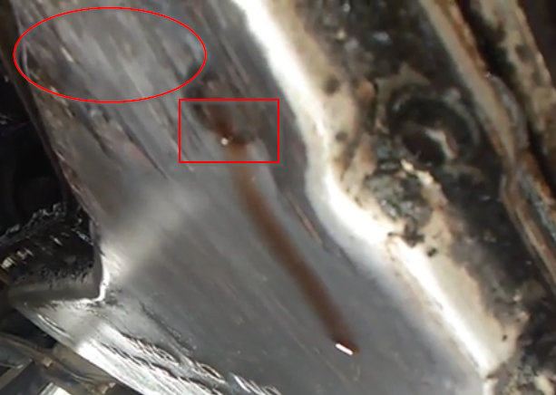

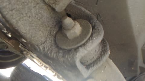

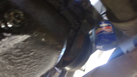

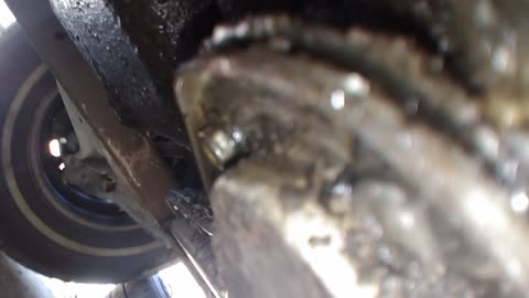

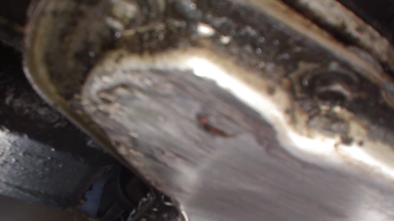

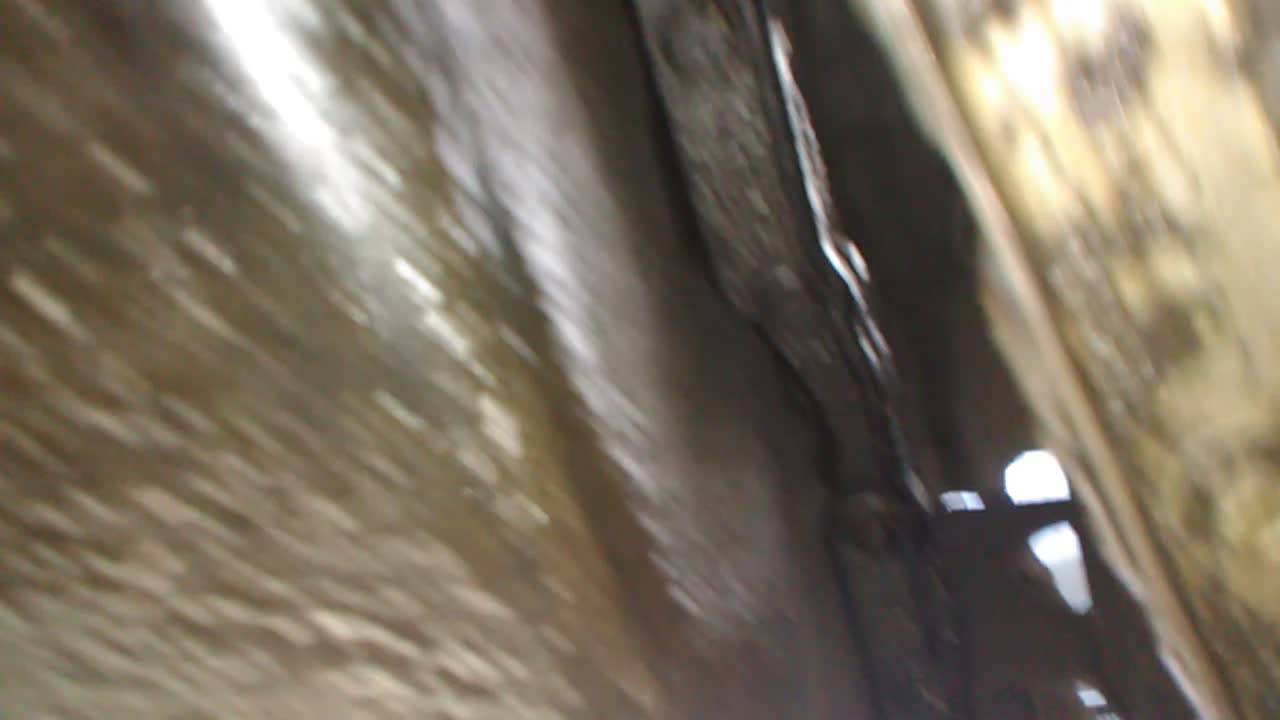

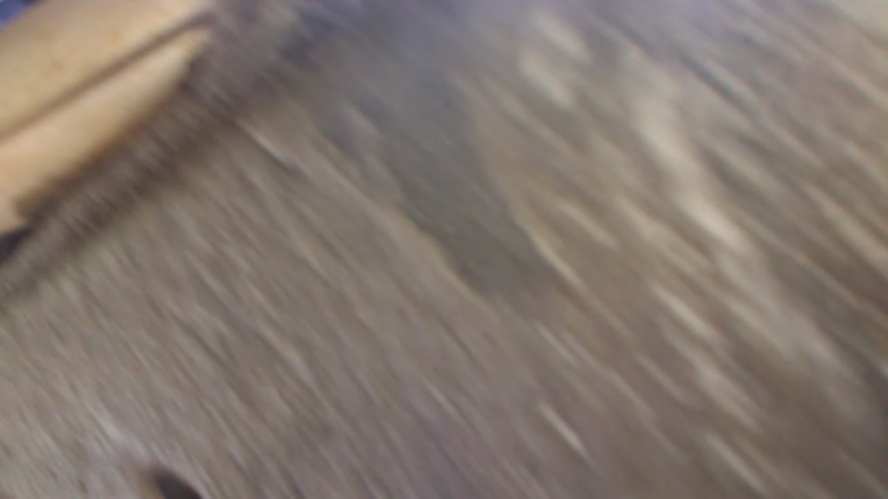

Got it jacked up an hour ago and saw there was a scrape in the transmission pan were fluid would tear up after cleaning it. Cleaned and added some quicksteel epoxy and letting it cure.
Things look pretty nasty down there hahaha. Attached is a video.
Monday, April 13th, 2020 AT 2:47 PM
Yeah. That is the issue. I attached the still shot of it. That pan clearly hit something like a speed bump and put a hole in the pan. All that grime is from fluid coating everything and then dirt sticking to it.
Hopefully the repair holds and you are good to go. Some engine cleaner from a parts store will clean all that up if you want to.
Good video. Thanks for the update.
