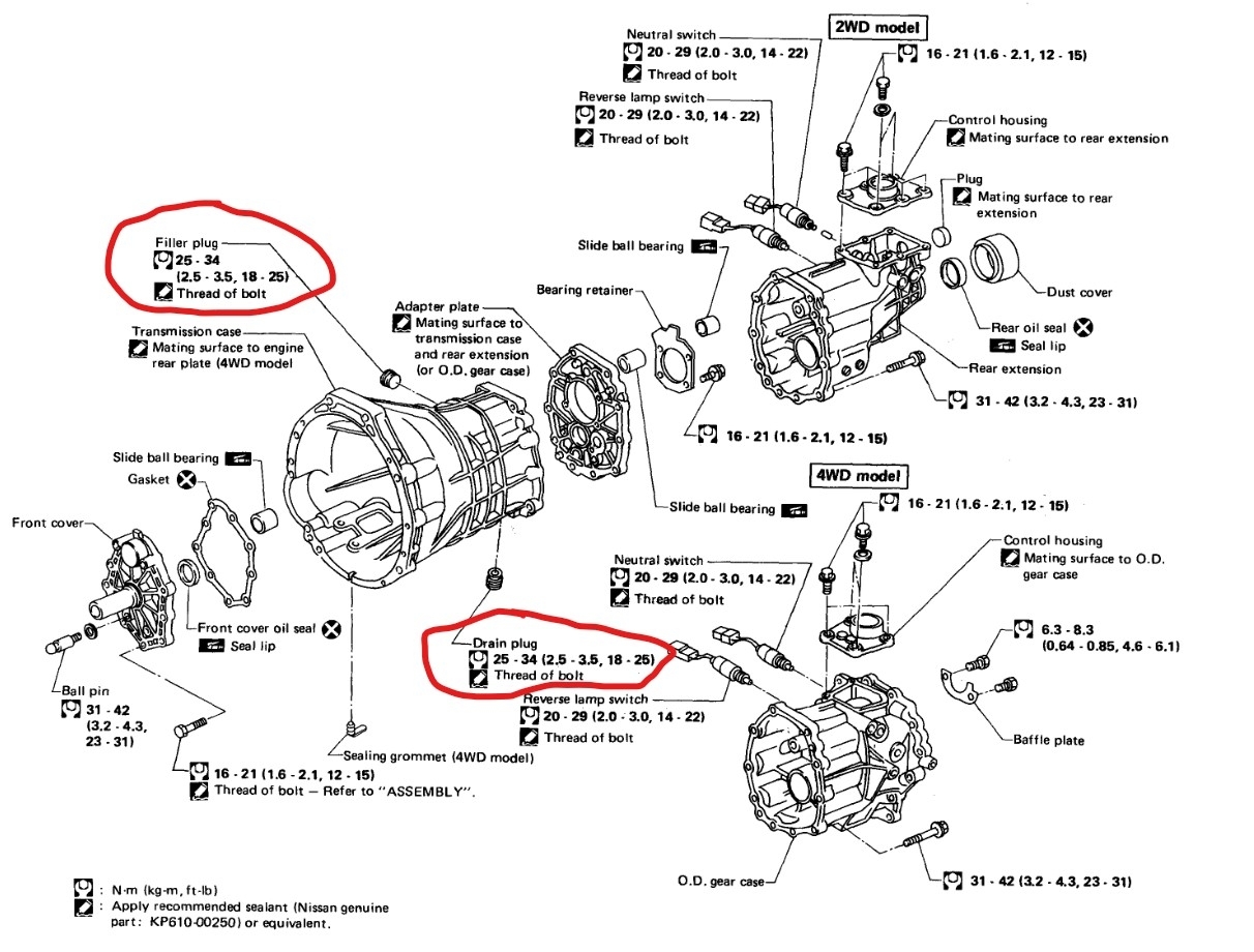

Transmission fluid.
Friday, March 14th, 2025 AT 2:47 PM
STEVE W.
MECHANIC
15,662 POSTS
That truck uses API G-L4 aka 75W-90 or 80W-90 Should be around 4.5 pints if you drain it. To change it you pull the drain plug at the bottom, then use the fill plug to add the oil in.
Image (Click to make bigger)
