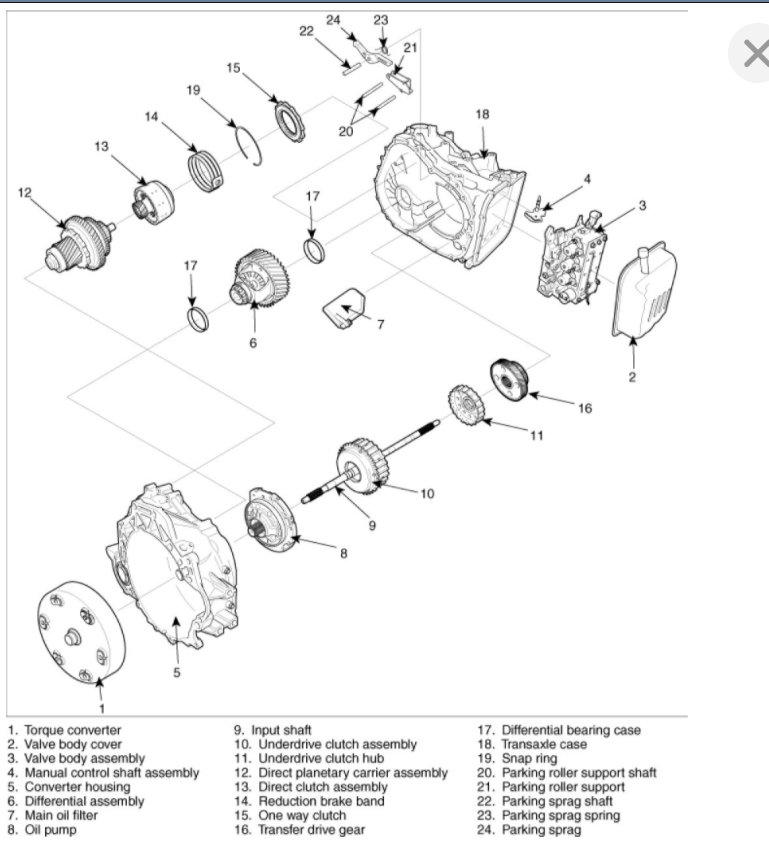

I cannot find the transmission filter.
Apr 1, 2021 at 12:13 PM

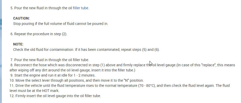

The filter is inside the unit and only requires replacement when you are disassembling the unit.

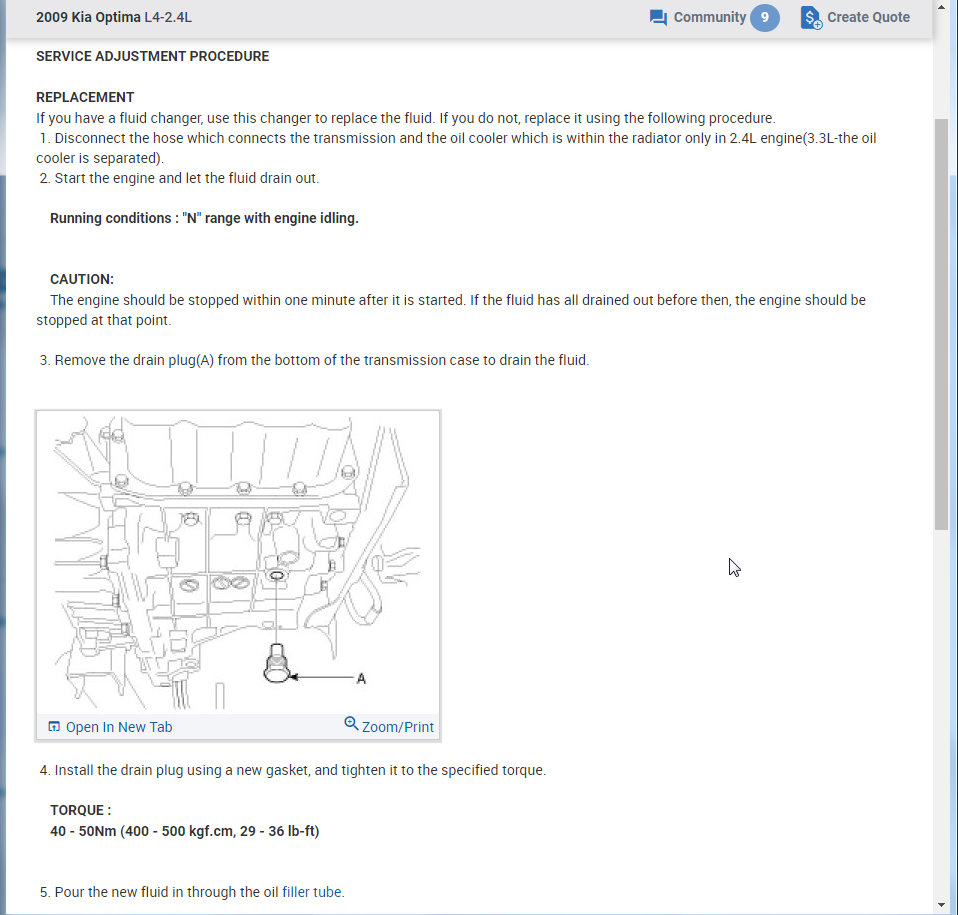

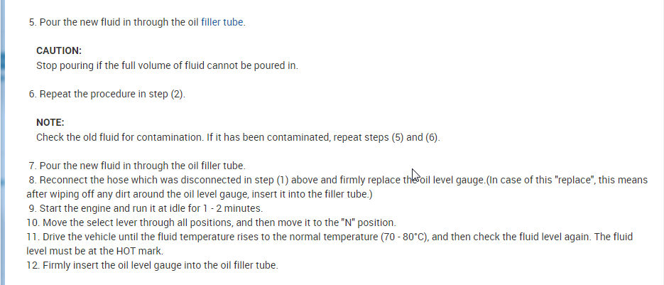

If you look below, the filter is number 7. Also, I attached the process to service the fluid.
Let us know what questions you have with this. Thanks
