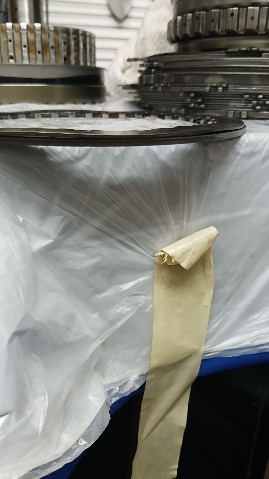

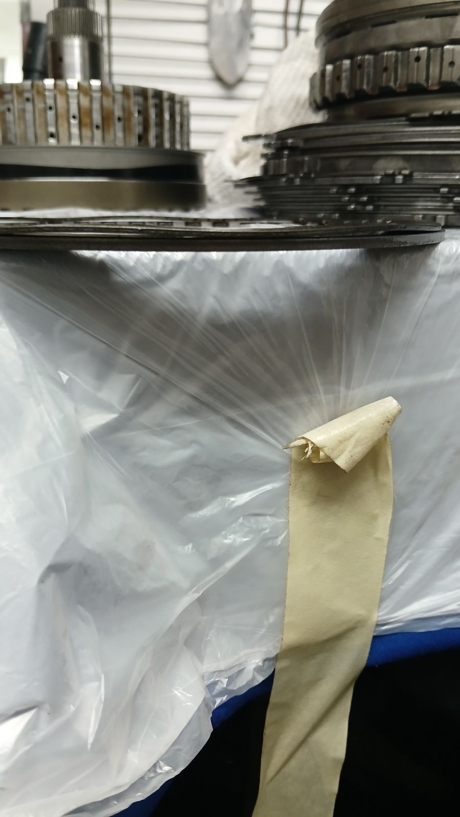

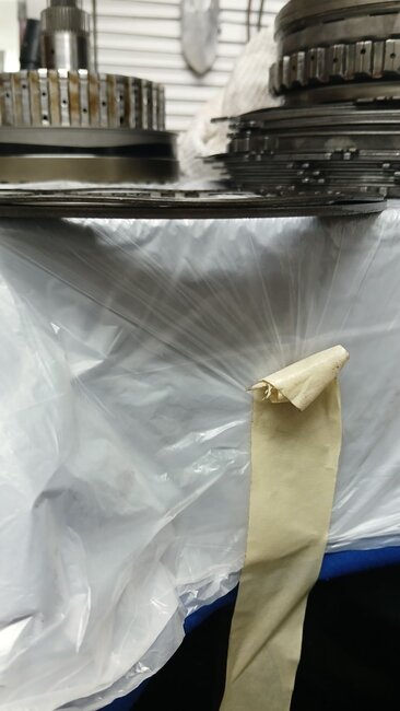

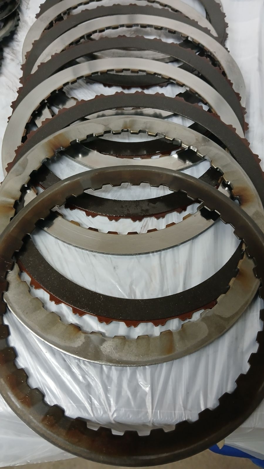

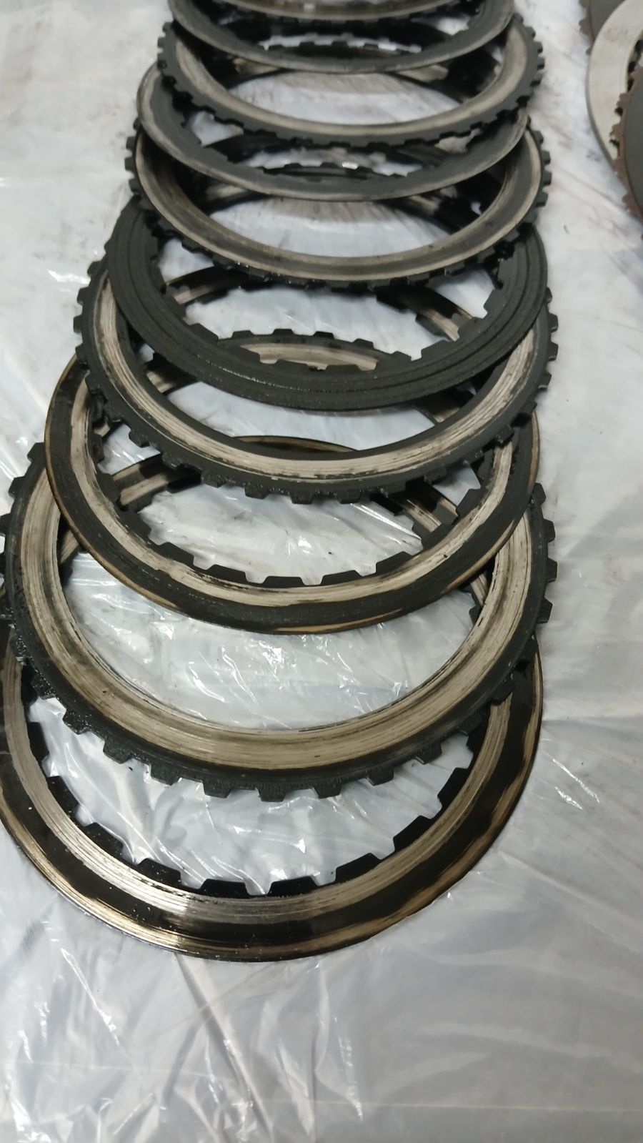

Hello, my vehicle is still slipping and giving the code P0963, I replaced solenoids and flushed and cleaned everything. I have now opened the transmission and noticed that friction plates look burnt to me and as if they have no more friction as if it were worn off. Can you zoom in to these pictures and confirm this? Could this be the reason for the car to continue slipping when going into certain gears? These pictures include 3, 4, 5, and 6 friction plates I believe. Also, can you zoom into the wave plate picture which is the one with the tape on it to see if it looks too flat or warped? Thank you

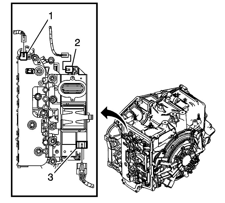

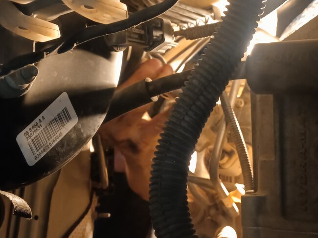

When this code is flagged the transmission will freeze all adaptations and maximize line pressure. Driving this way for a while could possibly lead to issues, and in your pictures the clutches do seem burnt. I bet it also smells burnt. One thing you did not mention was the valve body. This valve body has the TCM made with it as an assembly, and it a prime suspect for this code especially if there is debris in any of the connections. I would say at this point to throw some clutches in it and a valve body assembly. Of course another option is to find a complete transaxle assembly. You can monitor the solenoid voltage with a scan tool and once it goes over 8.2v and the engine rpm stays above a certain speed it will flag a problem. I attached a picture of the valve body location below.
Please let us know if you need anything else.

Hi William, thank you for your response, so yes, the valve body assembly was the first thing we changed and were sure that would solve the problem but unfortunately it did not, this has been so hard at guessing, finally decided to open the transmission and that is where I am at now but was not sure how all the disks and friction disks should look, thank you.

Yes, guessing can sometimes cause more of a headache than the original problem. However, bad clutches will not cause the code but will cause the slippage. At this point I think it may be a better decision to look for a used or rebuilt transaxle and put it all behind you. In any case, thanks for using 2carpros. Com.

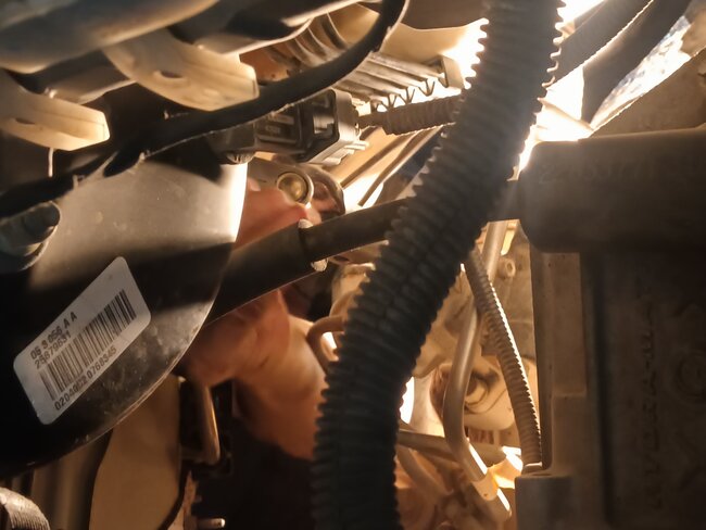

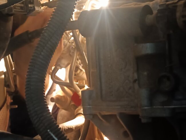

Hello, I changed the disks in the transmissions hoping this would fix the slipping praying it works but I am having trouble getting one of the parts back on I believe it is called the steering wheel knuckle, I can't get them to snap back together, any suggestions, I will upload a few pictures to see if you can see what I mean, my hand may be in the way. Thank you

I am sorry, I can't see the part you are talking about? Can I ask why you had to mess with the steering to get the transmission out? Please recheck your images.
