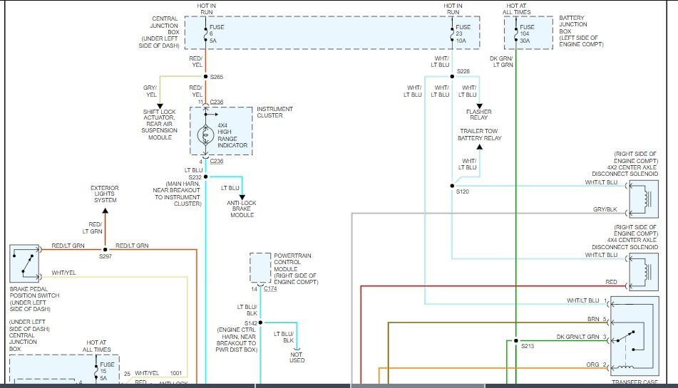

Will the transmission wiring harness from a two wheel drive work on a four wheel drive setup?
Mar 25, 2018 at 9:03 AM
Good afternoon,

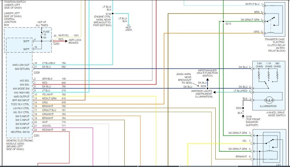

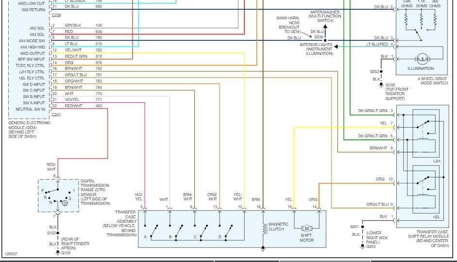

The simple answer is no. Part of the wiring for the 4 wheel has controls for the transfer case. The 2 WD does not have those controls.
The interior harness for the transmission is the same but the body harness is different.
I attached the diagram for the 4 wheel below.
