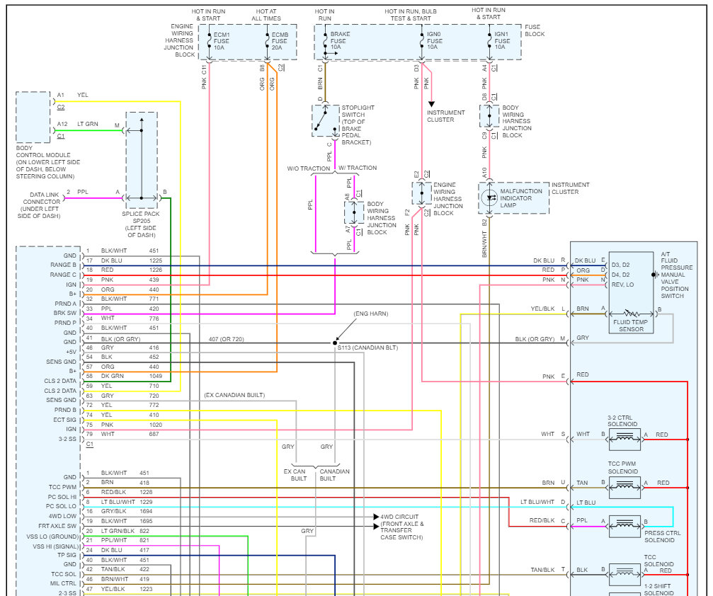

Codes P0740, P0753, P0785, P1860?
EARL91
  • 2000 CHEVROLET TAHOE
  • 180,000 MILES

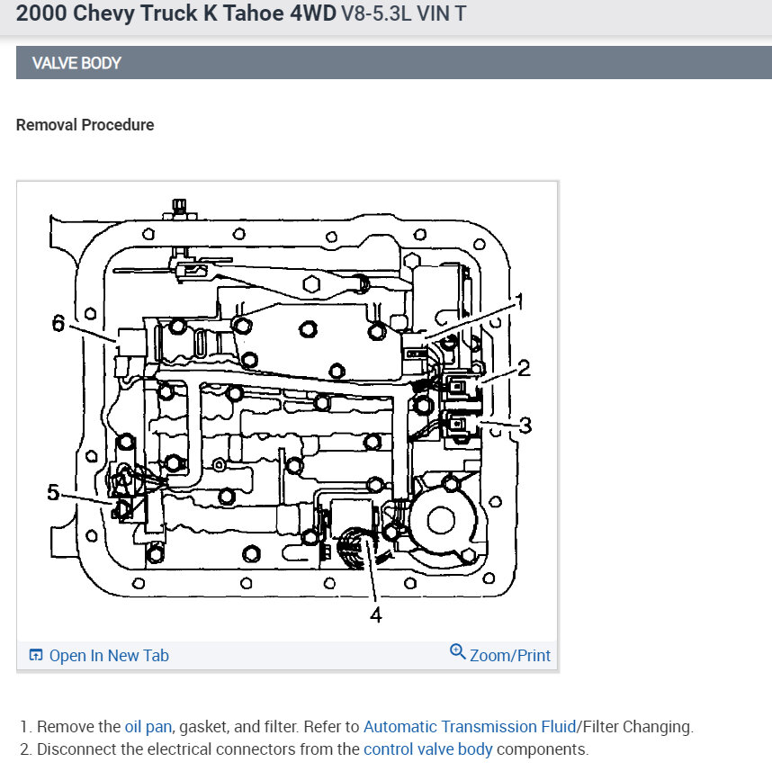

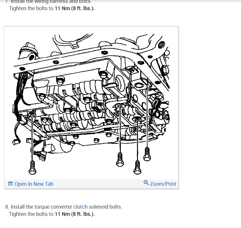

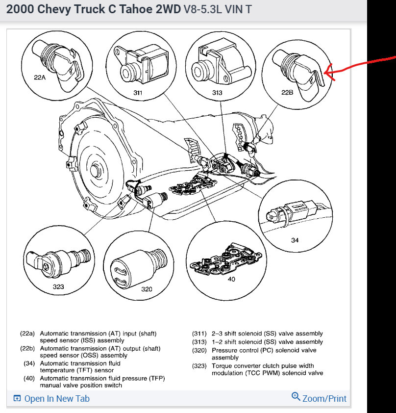

I have the vehicle listed above Z71 5.7L. Codes P0740, p0753, p0785, p1860. It has a transmission in it that was refurbished 2 years ago. I installed a new create motor about a month ago. I check shift solenoid A and B. Both are working and receiving between 20 and 25 olm's about 21.7 to be exact. What are some things I can do to fix? Working on a budget.

Here is information on the codes:
P0740: Torque Converter Clutch Circuit Malfunction.
P0753: Shift Solenoid A Electrical Malfunction.
P0785: Shift/Timing Solenoid Malfunction.
P1860: TCC PWM Solenoid Circuit Electrical Malfunction.

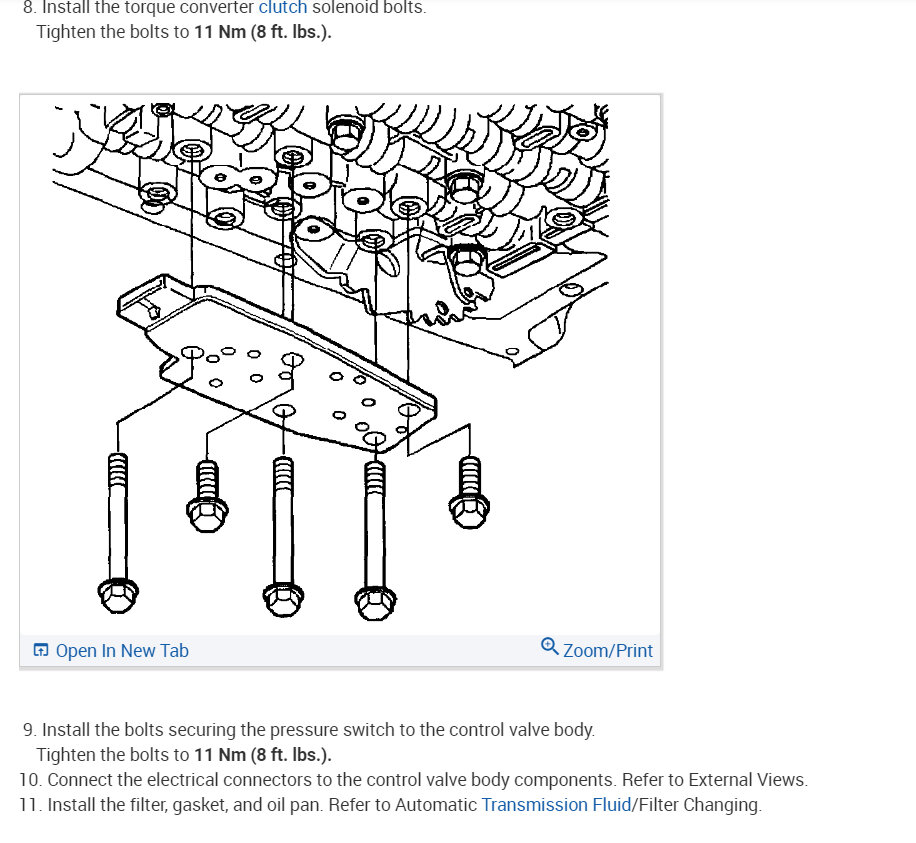

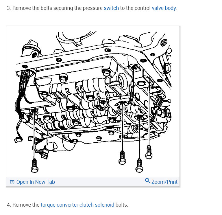

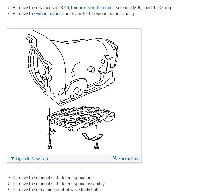

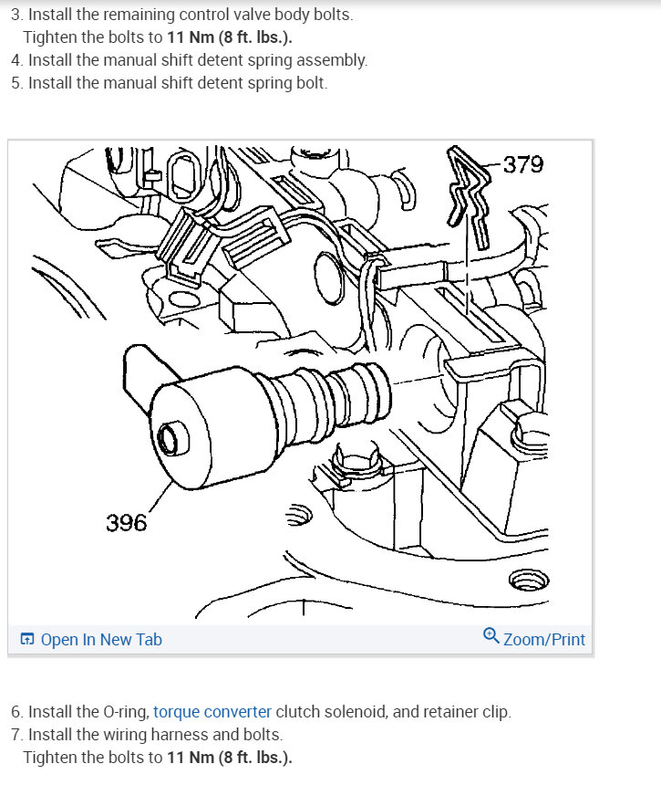

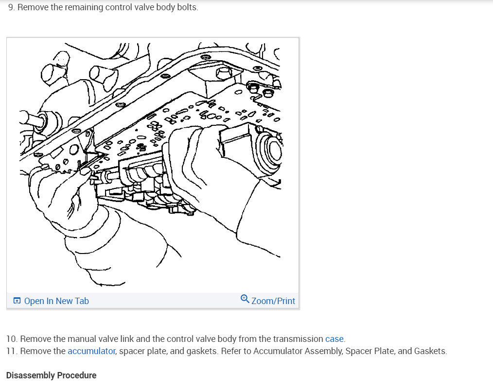

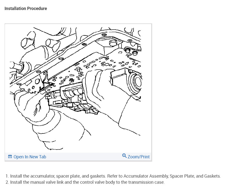

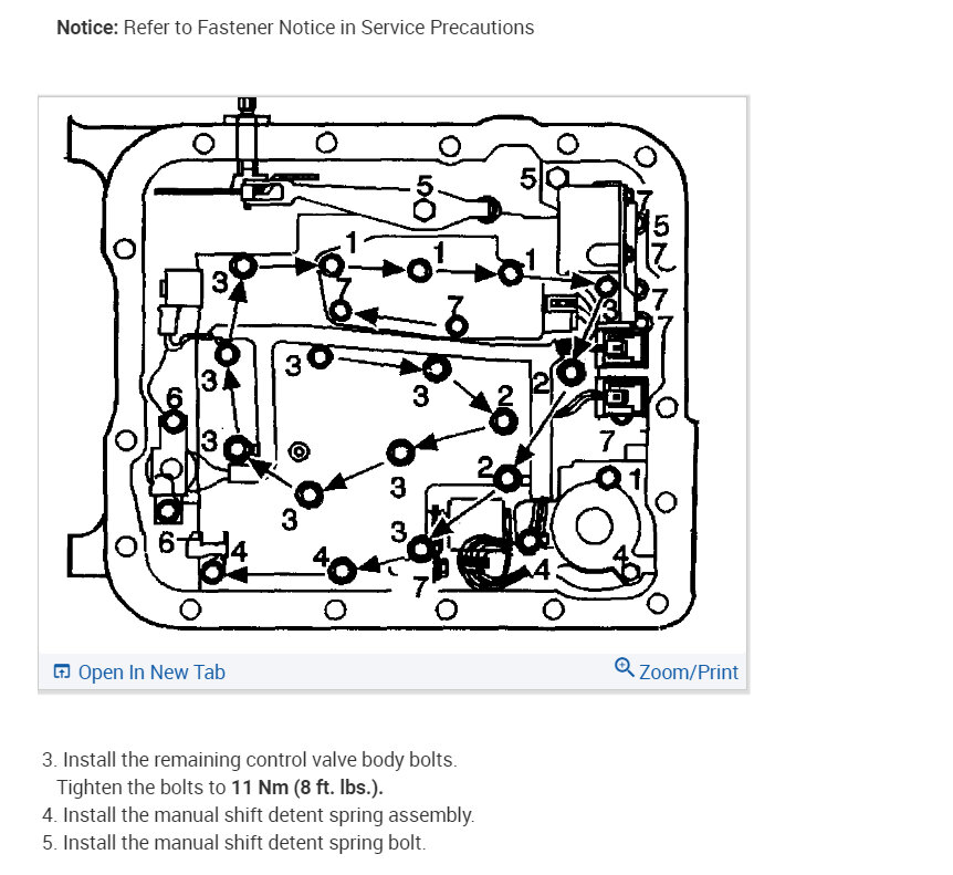

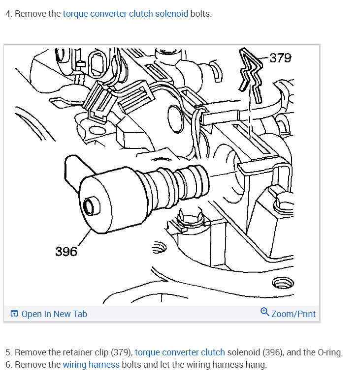

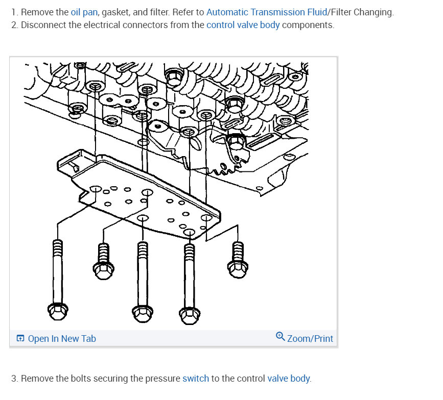

I would start by checking the electrical connector at the transmission. If that looks okay, I would install a rebuilt valve body. Check out the images (below). Please let us know what happens. Also, how is the fluid condition, is it burnt or low?

The fluid is good. I dropped the pain and checked the shift solenoids, and they were good. I cleaned everything while I was there. Changed the filter and put new fluid in. Do you think putting a new harness in would fix my problem? I have done a little research and it seems that that could possibly fix it.

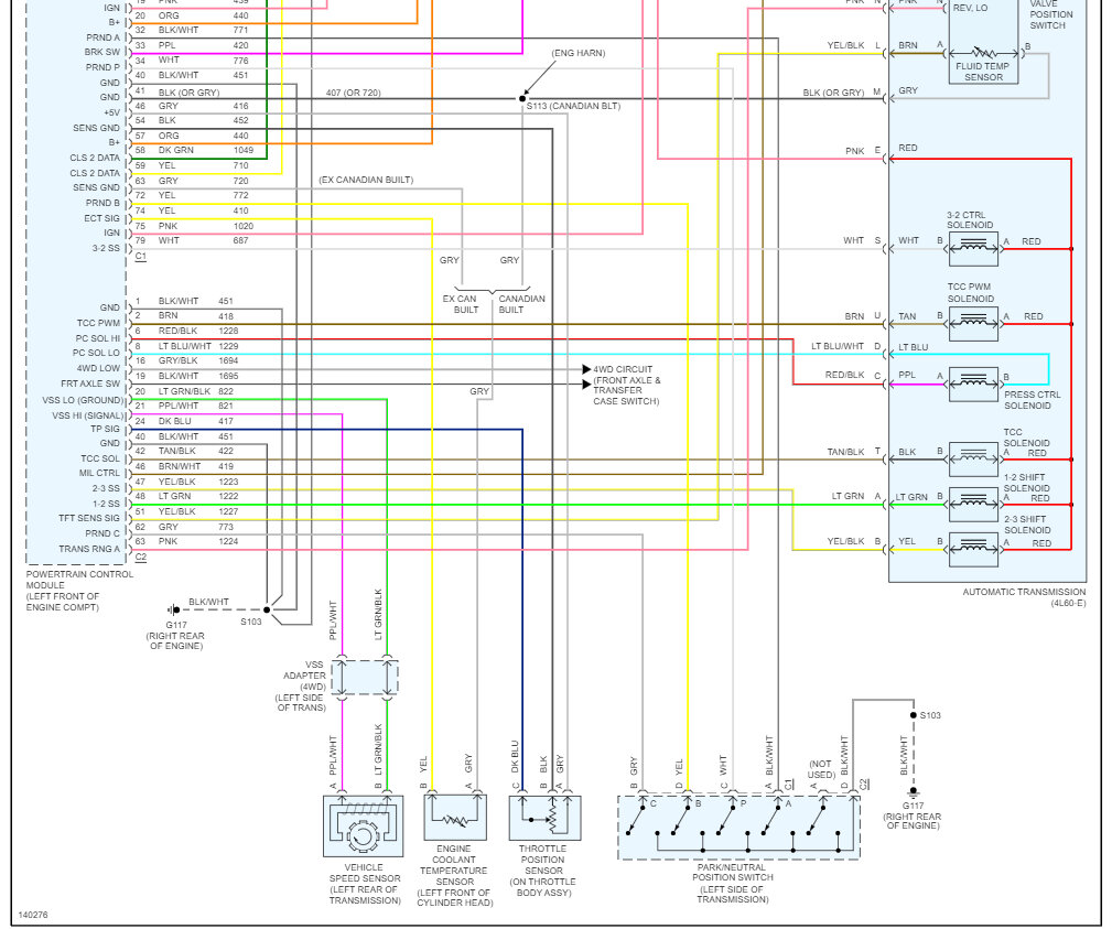

Yes, if the wiring is bad, it will cause this problem. Here is a guide to help you test the wiring with the transmission wiring diagrams below:

The valves in the valve body moved easily. So, I don't think it's that. That why I asked about harness. Thank you for the info. I will let you know how it goes.

I replaced the harness in the transmission. The truck can move better. I don't have to almost floor it to move. But the codes are still there after clearing them with the scanner. Also still can't feel or hear the truck shift. What would the next step be?

I would install a rebuilt valve body, or you could have a bad PCM. How is the fluid condition?

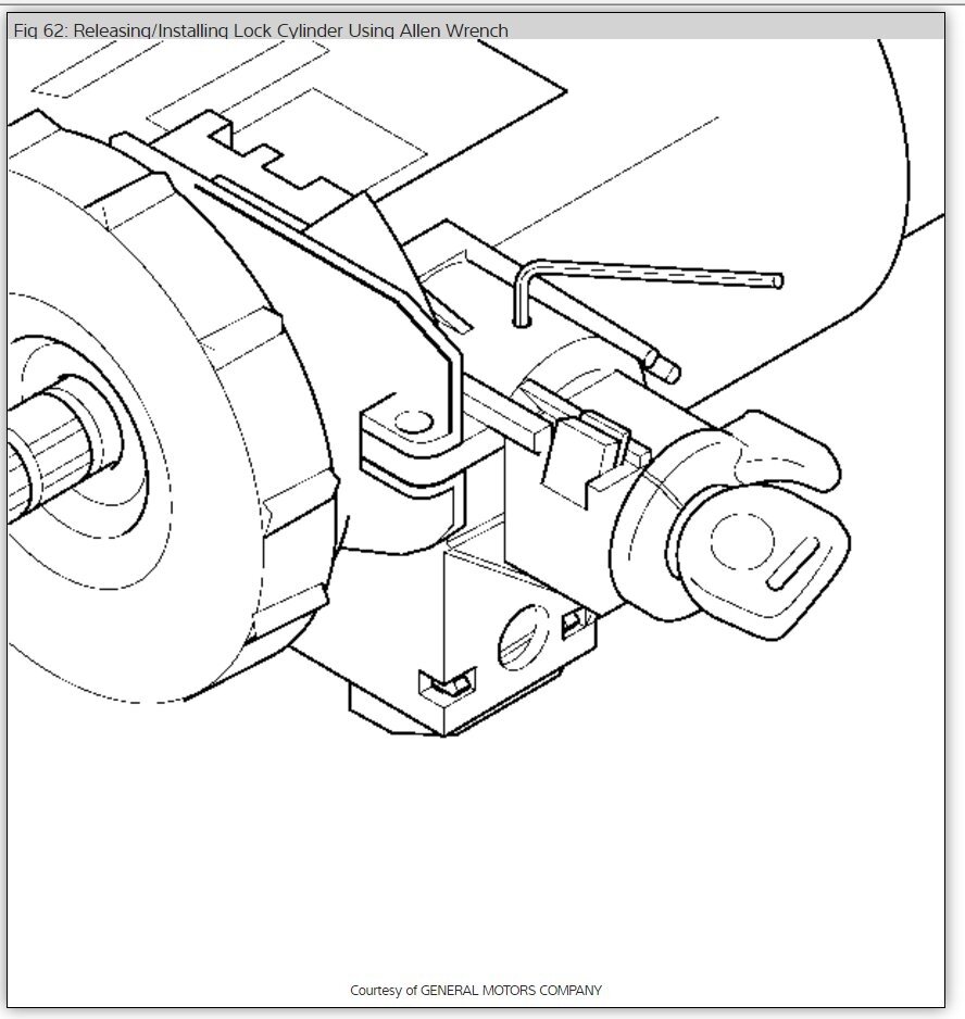

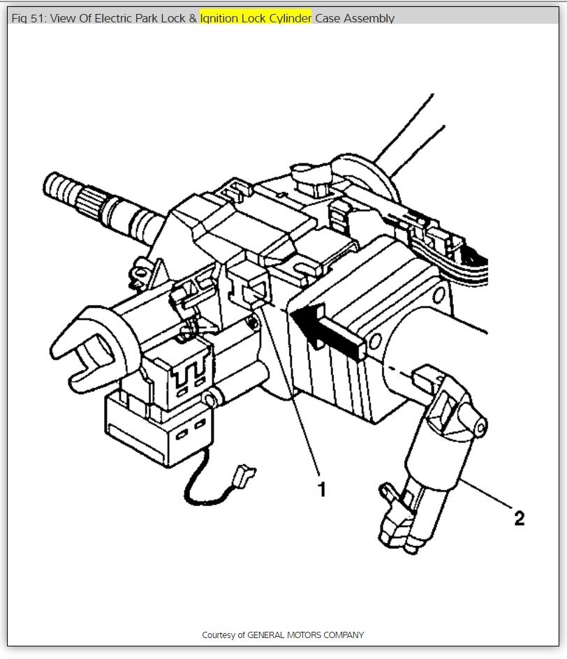

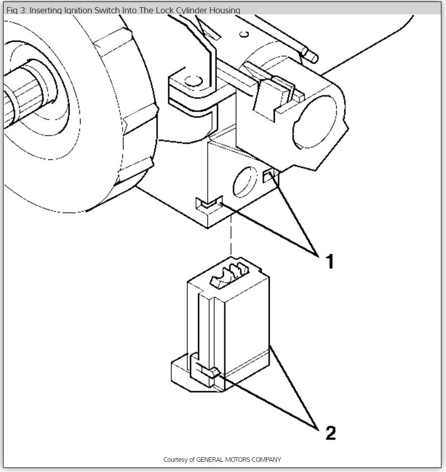

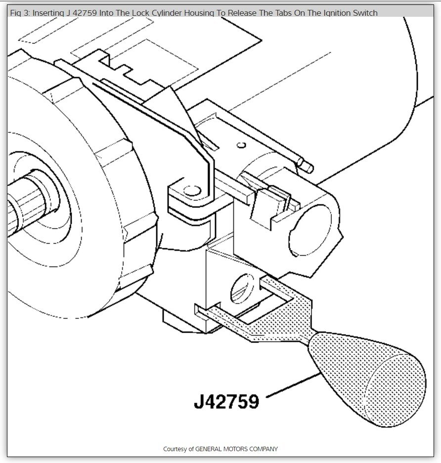

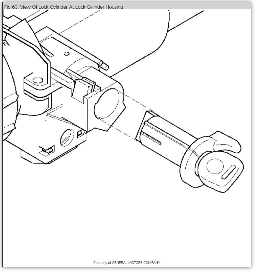

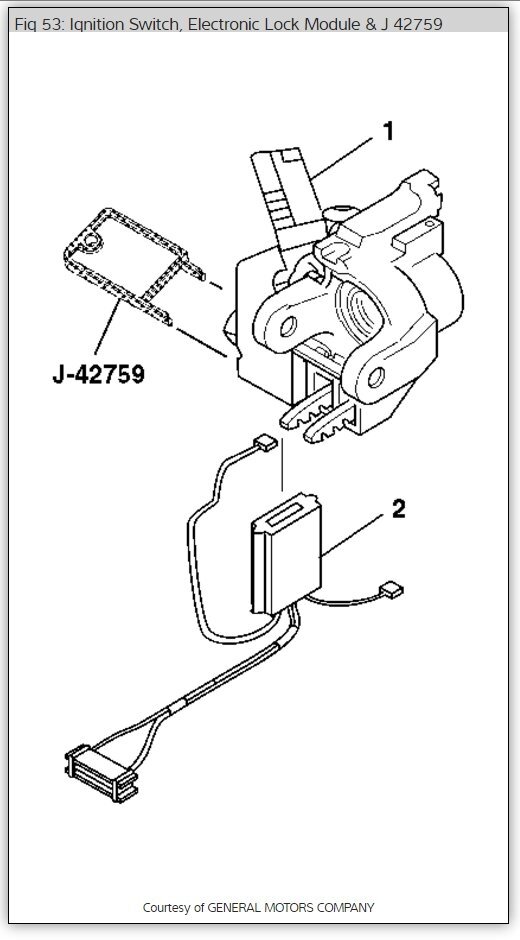

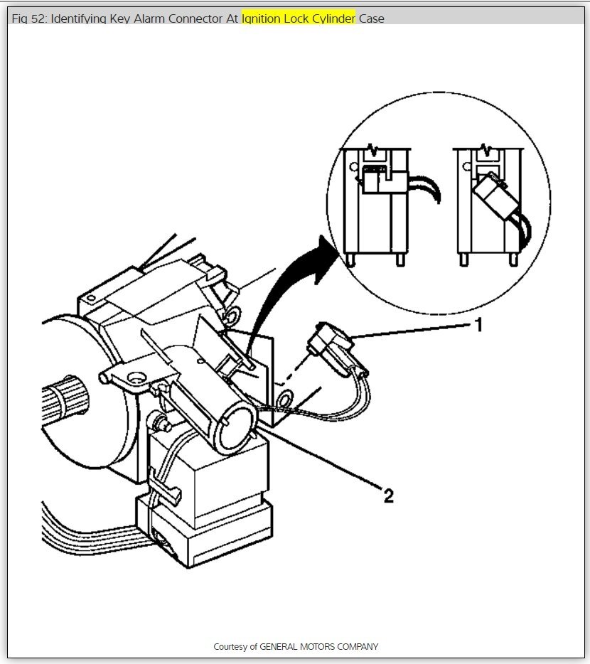

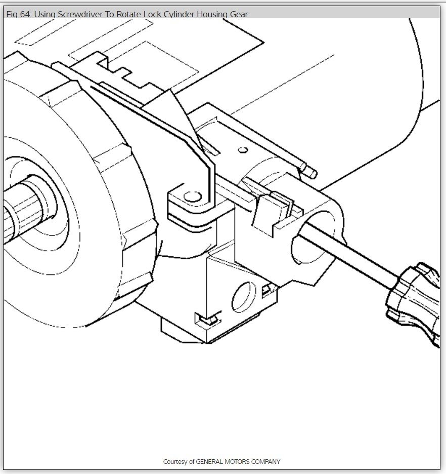

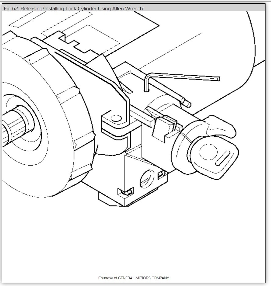

Can a bad ignition switch cause these shifting problems? My tachometer and speedometer on my cluster stopped working. And then all these problems started.
Thursday, May 18th, 2023 AT 5:36 AM
KEN L
  • MASTER CERTIFIED MECHANIC
  • 55,281 POSTS
Yes, it could, here is how to change the switch out in the images below. Check out the images (below). Please let us know what happens.

Ignition switch did not.

Any way you could send me all wiring diagrams for my transmission?
Thursday, June 1st, 2023 AT 8:41 AM
KEN L
  • 55,281 POSTS
They are in the post above, click to enlarge in the images.
