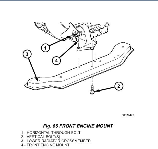

When I slow down to stop it jerks.

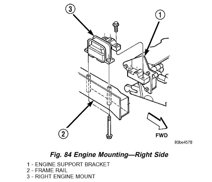

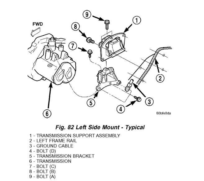

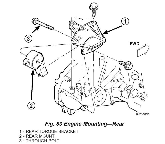

Is the check engine light on? If there is, do you know the code? You can go to a parts store and have it checked for free.
It sounds like it could be a motor mount. The torque changes when you stop and the motor may be moving.
I would have the mounts checked for being loose or broken.
