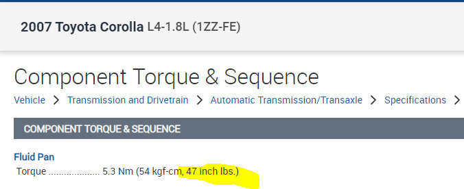

What are the torque specs of the transmission pan bolts? Also, the torque spec of the bolts that holds the transmission filter.

As far as the torque specifications are concerned, I attached them below. Note that they are in inch pounds and not foot pounds.
joe
See pic below.
