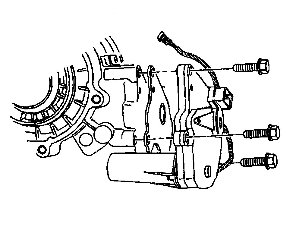

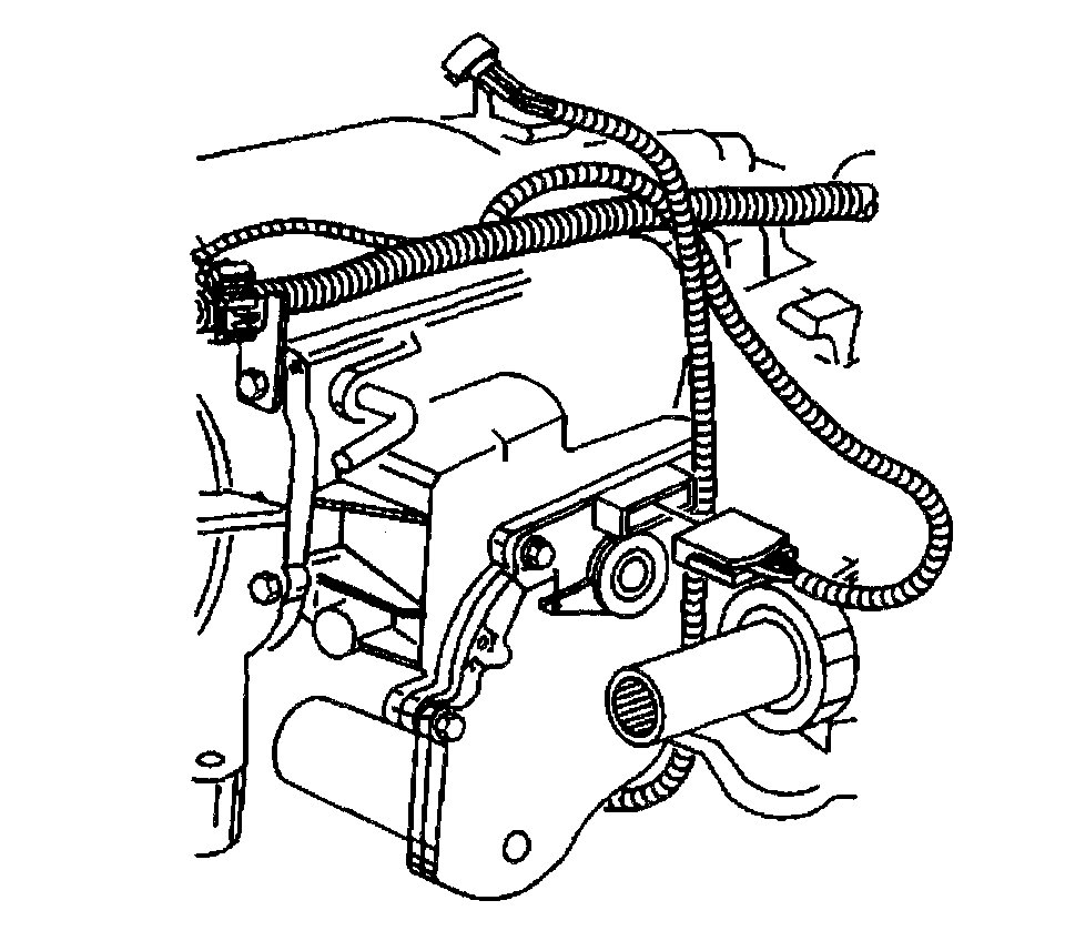

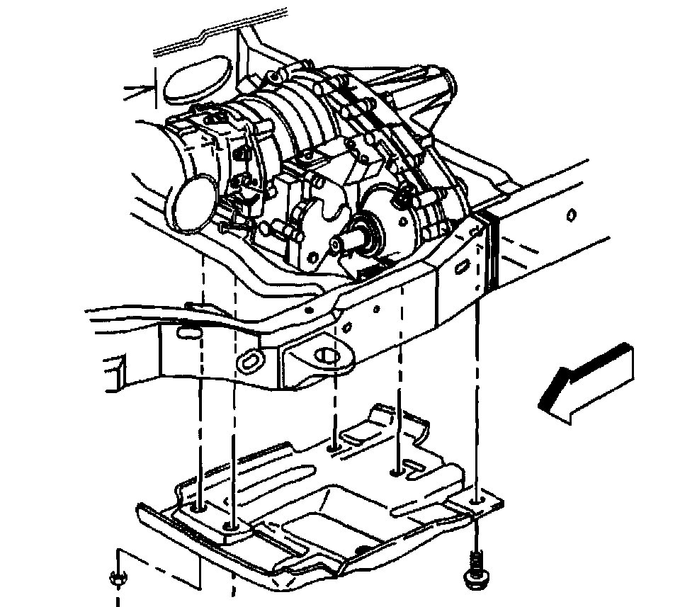

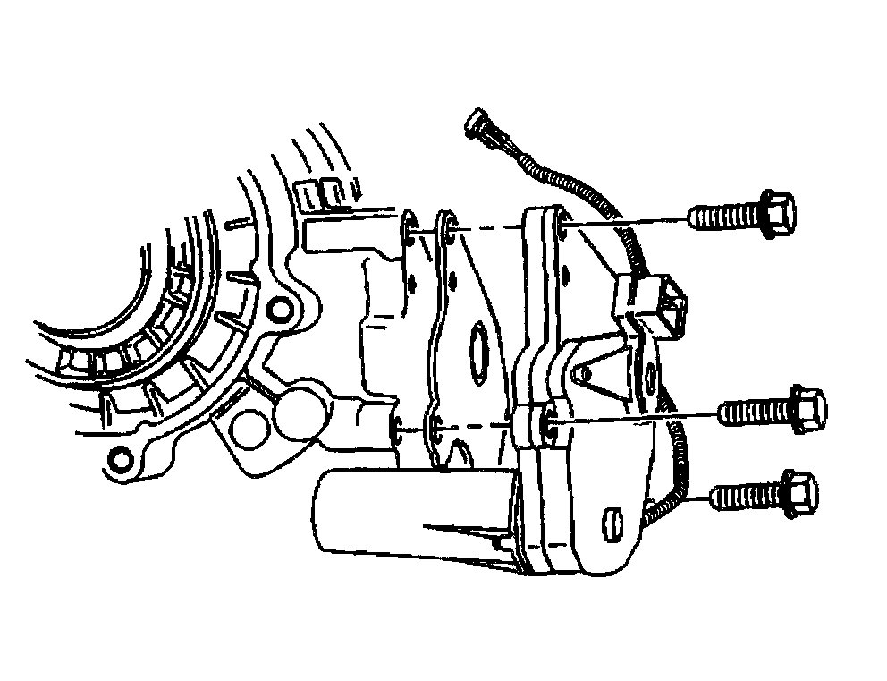

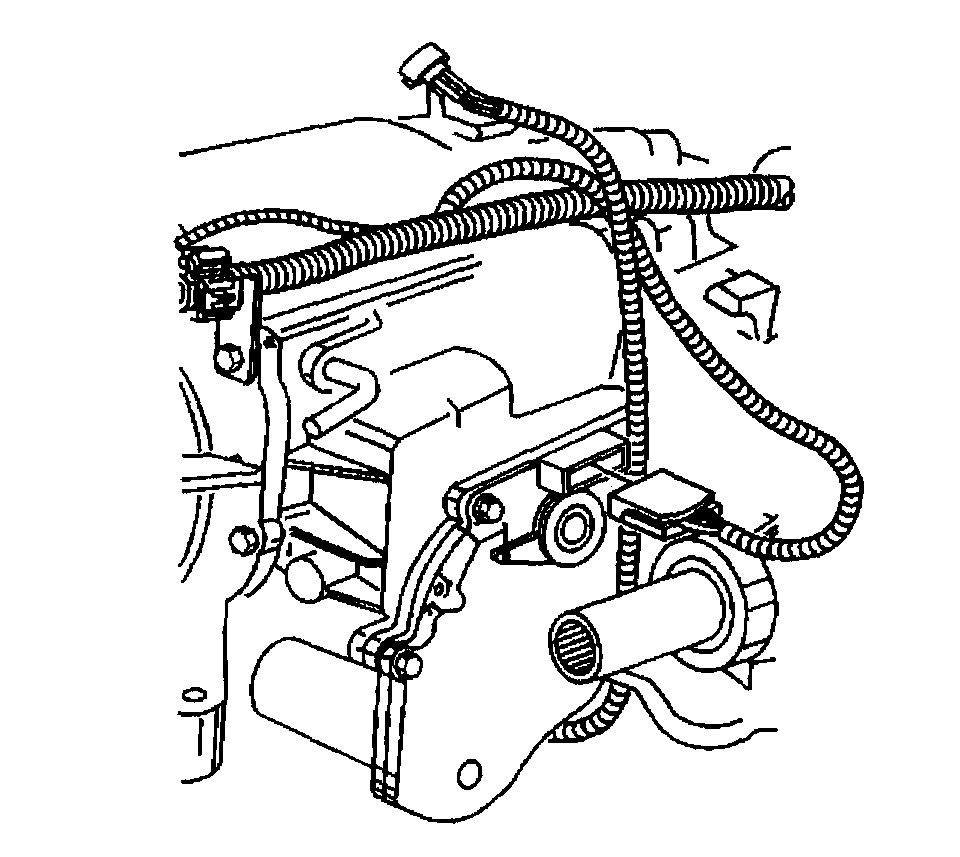

If the new motor keeps blowing a fuse, either you have a bad motor or you pinched a wire and caused a short. First, make sure nothing is pinched or damaged. Make sure the plug that connects to the motor doesn't have pins that are bent or damaged causing a short. Check out the diagrams (Below).
Here are the directions specific to your vehicle for replacing the encoder motor. I'm attaching them so you can confirm everything was done correctly. The attached pictures correlate with the directions.
TRANSFER CASE MOTOR/ENCODER REPLACEMENT
Transfer Case Motor/Encoder Replacement
Removal Procedure
1. Raise the vehicle. Refer to Vehicle Lifting.
2. Remove the transfer case shield from the vehicle.
3. Remove the motor/encoder electrical connector.
4. Remove the motor/encoder mounting bolts.
5. Remove the motor/encoder assembly.
6. Remove the motor/encoder gasket.
Installation Procedure
Important: When performing this service procedure make sure that the motor/encoder unit is flat against the transfer case for proper installation.
1. Install the motor/encoder to the transfer case.
2. Install the motor/encoder gasket to the transfer case.
Notice: Refer to Fastener Notice in Service Precautions.
3. Install motor/encoder mounting bolts to the transfer case.
Tighten the motor/encoder mounting bolts to 20 Nm (15 ft. Lbs.).
4. Install the motor/encoder electrical connector.
5. Install the transfer case shield.
6. Lower the vehicle. Refer to Vehicle Lifting.

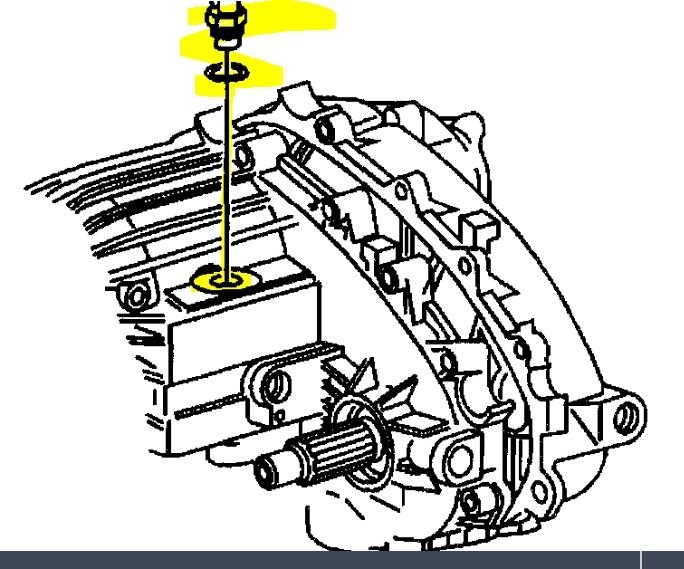

Okay, so I noticed that I have vacuum coming out of the line at the actuator under the battery tray and is sucking the actuator in. When I unplug the line the actuator comes out. So why is there constant vacuum.
Tuesday, September 17th, 2019 AT 12:22 PM
  • 110,194 POSTS
Welcome back:
Since you are getting constant vacuum regardless of selection, the first suspect is the transfer case vacuum switch. Based on the gear selected in the transfer case, vacuum is applied or removed. It sounds like the switch is stuck and not moving to stop the vacuum supply.
I attached a pic of the switch I'm referring to.
Let me know if this helps.
Tuesday, September 17th, 2019 AT 7:37 PM
MICHAEL SMITH6
  • 10 POSTS
Okay. Me being a mechanic I'm looking for the vacuum switch on the transfer case and I don't see it nowhere. I don't believe there's one on there. I'm looking right where YouTube videos are showing me and no luck. If you know something different please enlighten me. What does the vacuum switch on the firewall do?

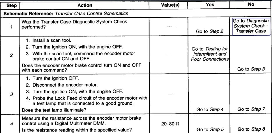

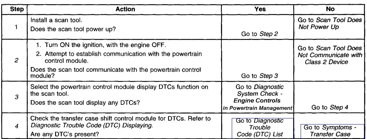

Mike, I have the diagnostics but they are indicating the need for a scan tool. By any chance do you have one for the OBD2 system that can read such codes?
Take a look at the starting point. See pic 1. As I'm sure you are aware, this leads to multiple other flow charts. However, if it would help, I'd be happy to get them for you. Since the light is flashing, it could be related to the shift control module itself and will require more diagnostics.
Let me know if you have the tooling.

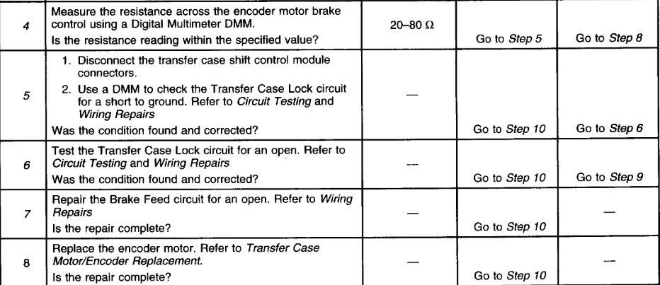

So what should I check for that code?
Friday, September 20th, 2019 AT 5:18 PM
  • 110,194 POSTS
Welcome back:

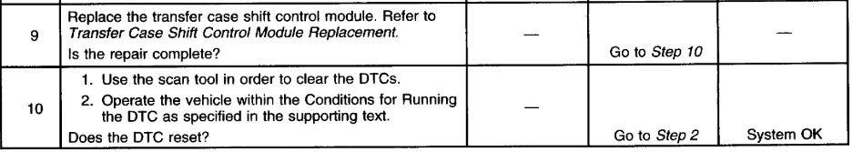

I attached a flow chart below in the pics. I enlarged it so it is readable for you which required me to put it into 3 different pics. Follow the chart to identify the cause.
Let me know if it helps.
Friday, September 20th, 2019 AT 9:21 PM
MICHAEL SMITH6
  • 10 POSTS
Okay, so I put another encoder motor in and when I turn the truck on the switch says neutral and when I try to switch to 2 wheel it just blinks until the atc fuse blows. The whole truck won't move at all. In drive, reverse don't matter I hear the new motor like grinding when I try to put it back in park. So I'm stuck and aggravated. Don't know what's making this light keep blinking and not shifting.
