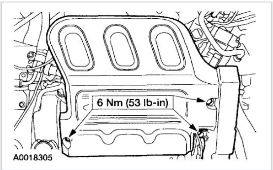

Yes, a bad or acting up TPS will through off your O2 sensors and the computers ability to get a good fuel mixture so first off you will need to remove the top engine cover to see the top of the motor and its right easy to get to the sensor and its connector.

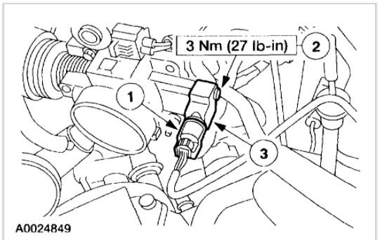

Here are a couple diagrams showing you what to look for then:
1. Remove the Throttle Position (TP) sensor.
1 Disconnect the electrical connector.
2 Remove the screws.
3 Remove the sensor.
NOTE: Air cleaner outlet tube is removed for clarity.
INSTALLATION
1. To install, reverse the removal procedure.
After you've done this I would reset the computer by disconnecting both battery terminals and short them together for 30 seconds and this will clear everything in its memory. Then start it up go for a quick test drive and run a fresh scan to see what you have and whether or not the O2 sensors are still acting up.
