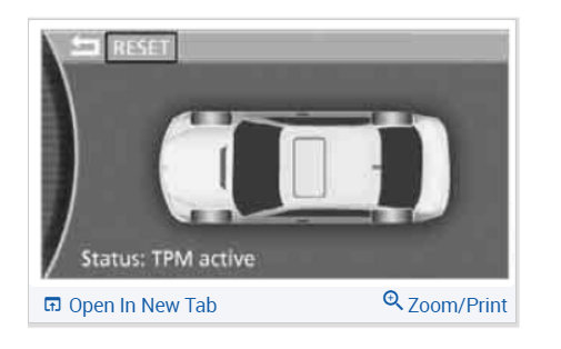

This is a recent purchase.
The TPM warning light was on. I've corrected the tire pressure and hit the reset selection for the TPM on the computer. It claims "TPM Resetting", and I drive it for a short ways, but rather than reset after a couple of miles, it sends a new "TPM Malfunction!" warning on the dash display as well as the onboard computer monitor.

Have you installed new tires on the car recently? If so, what happens is one of the sensors gets damaged, we will need to scan the car to see which one is not working or you may be able to navigate through the prompts on the car to see which tire is not registering. This guide and video will show you what to do if you are unsuccessful with the internal diagnostics:
Let us know what happens and please upload pictures or videos of the problem. I found this info on the system which can help as well, check the diagrams as well at the bottom.

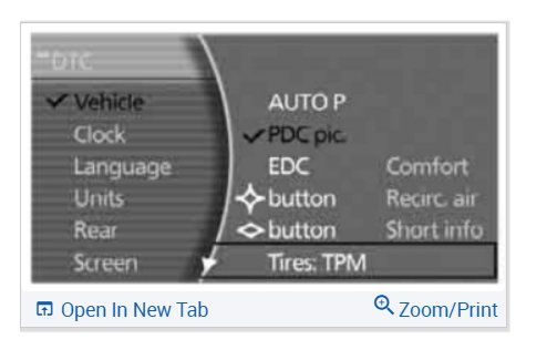

1. Press the MENU button to open the start menu.
2. Move the controller toward "Settings".
3. Select "Vehicle" and press the controller.
4. Select "Tires: TPM" and press the controller
5. Start the engine, but do not begin to drive.
6. Select "RESET" and press the controller.
7. Select "YES" and press the controller.
8. Start to drive.
The tires are shown in gray and "Status:
Resetting TPM..." is displayed.
After a few minutes of driving, the newly corrected inflation pressures in the tires are adopted as the set-point values to be monitored. The resetting process is completed during driving. The tires are displayed in green on the Control Display.
If a flat tire is detected during the resetting and adoption of the tire inflation pressures, all tires are shown in yellow on the Control Display. The message "Status: Tire low!" is displayed.
