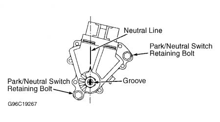

1998 Toyota Tercel whear is neutral switch at
JOHN WHALEN
MEMBER
1998 TOYOTA TERCEL
Engine Mechanical problem
1998 Toyota Tercel 4 cyl Two Wheel Drive Automatic
wear is neutral switch at
Monday, September 13th, 2010 AT 6:48 PM
WRENCHTECH
MECHANIC
20,761 POSTS
It's called a transmission range sensor and it's mounted on the transmission, right at the shift shaft linkage.
